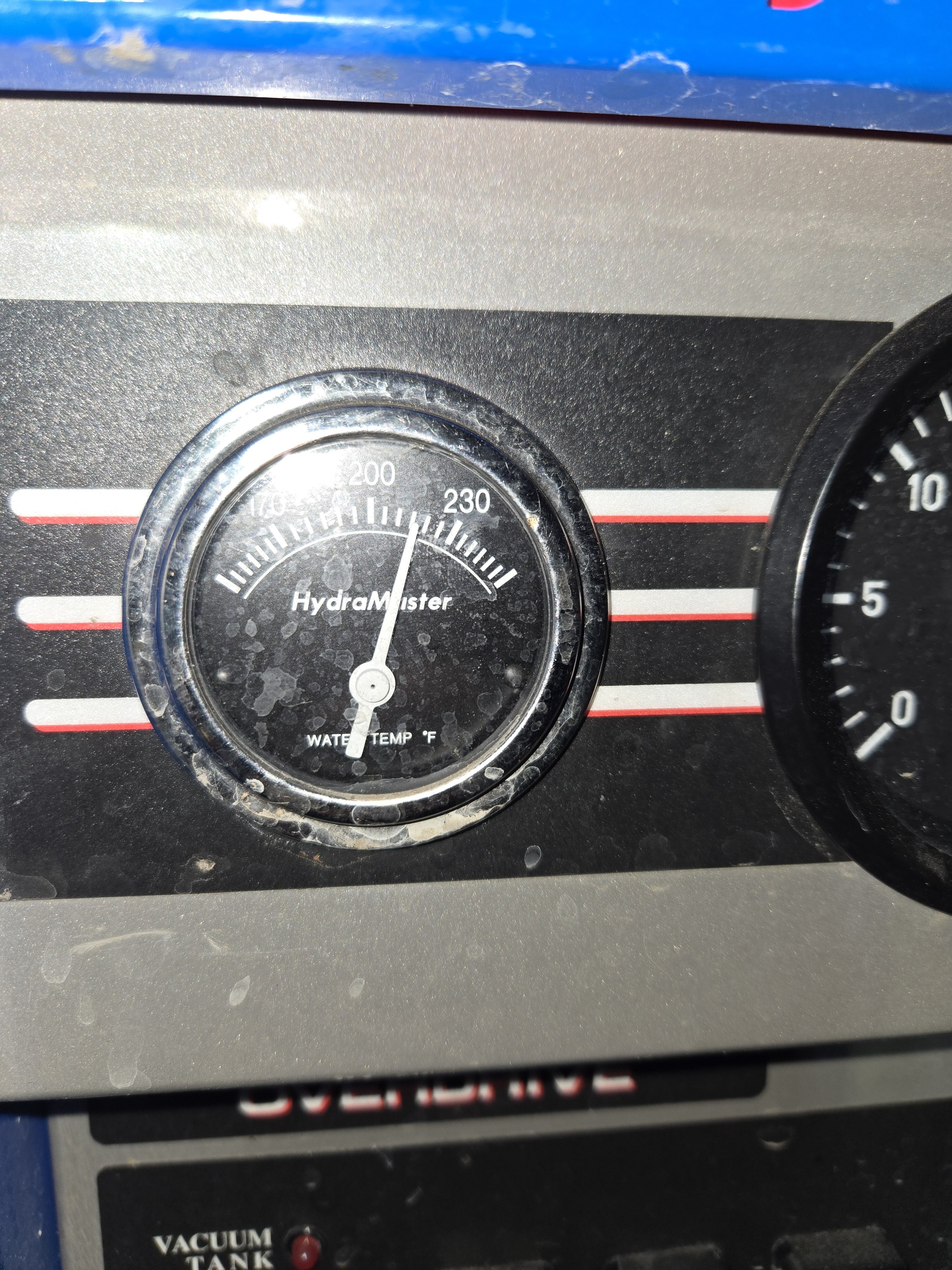

That may be the winner, thanks. I'm running it as hot as I can with my coolant and salsa hx. I should really check the gauge again. Last time I checked was several months ago in the dead of winter and it was a bit over 200 at the machine. Can't recall how long it had been running either.
