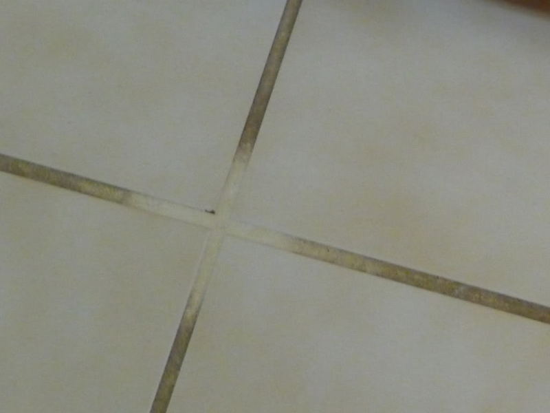

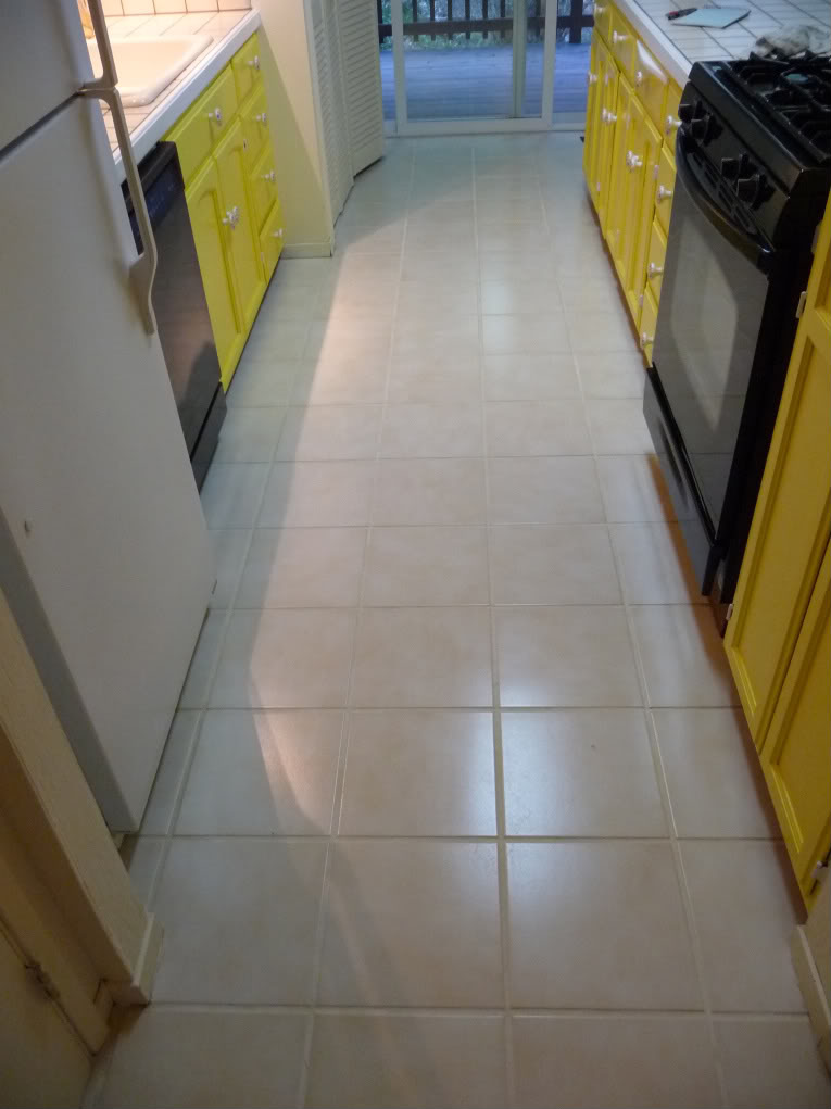

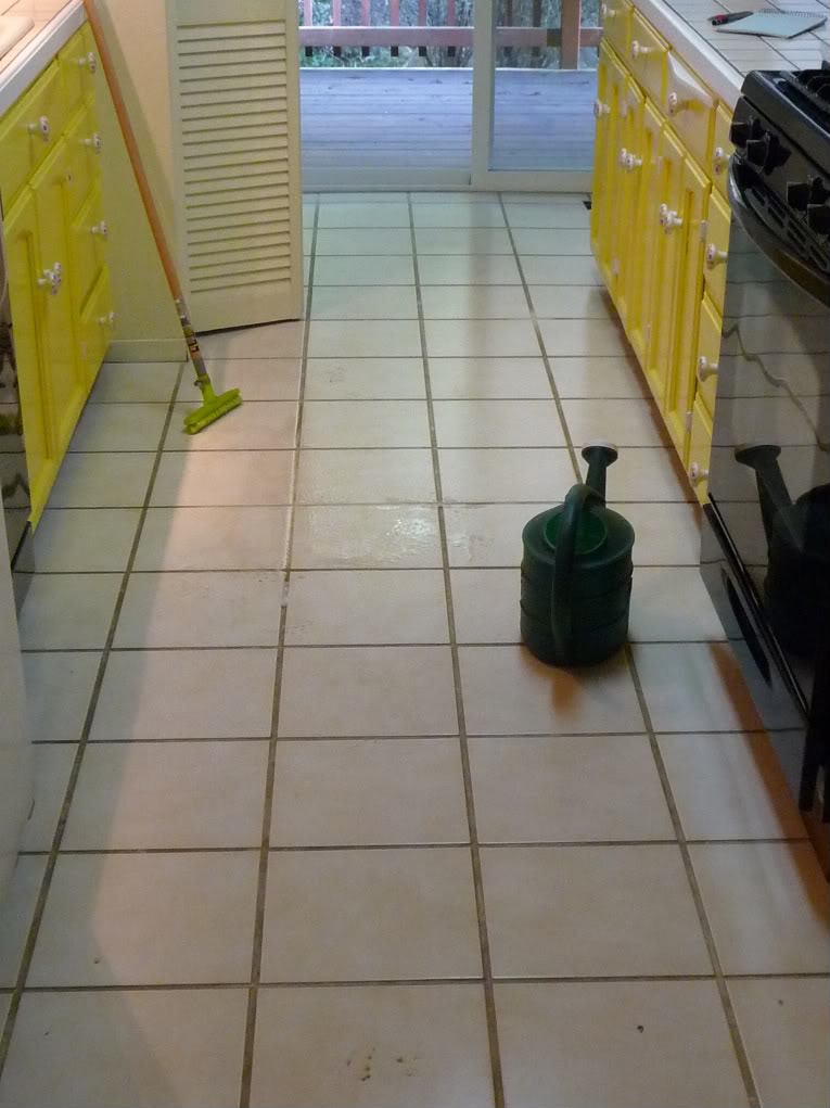

Yet watch this thing clean..
Test area from when we cleaned the carpet a week before..
Before rinsing
After..

Pretty dramatic results. Would you mind explaining your procedure on that job?

We use a glided wand to rinse tile all the time. Key word here.. rinse. With an external jet wand you will (repeat WILL) blow water under walls, cabinets and furniture with any kind of pressure. In most residential kitchen and bathroom jobs a good scrub and rinse with wand is all that is needed. You WILL get splashing with an external jet wand. Splashing a little acid up on stainless appliance just once is enough to justify using a "turbo" type tool that retains the water thus eliminating splashes and water getting under and swelling up cabinets.
