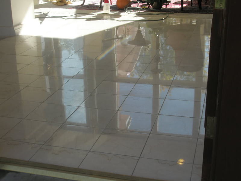

sorry Ron but I'm not impressed, you could have done better if you were doing it the right way. Go to my website and look at the home page, look at the clarity on that travertine, that was done the correct way -RESIN DIAMOND PADS.

have you ever used resin diamond pads or powders? I can tell it's all about the $$$$$$$$$$$$$$$$$$$$$$$$$$$$$$$$$$$$$$$$$$ by looking at some of yer pictures
