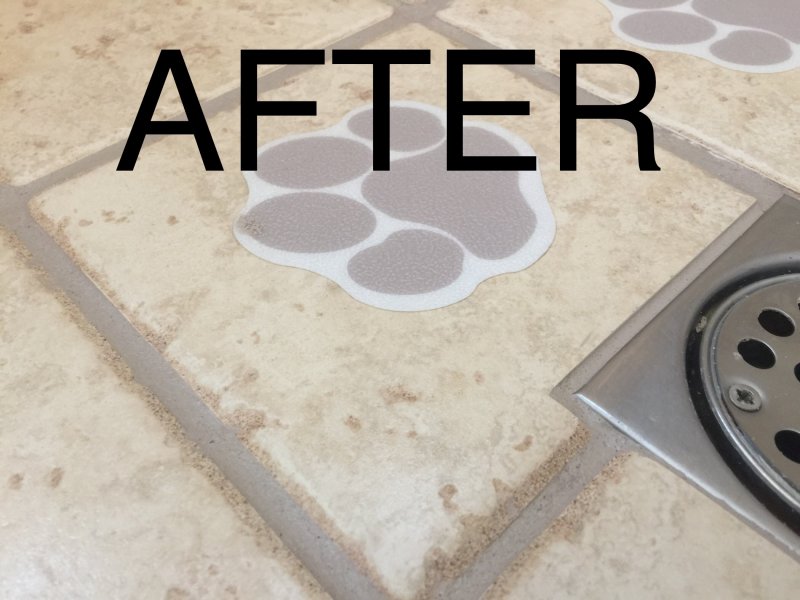

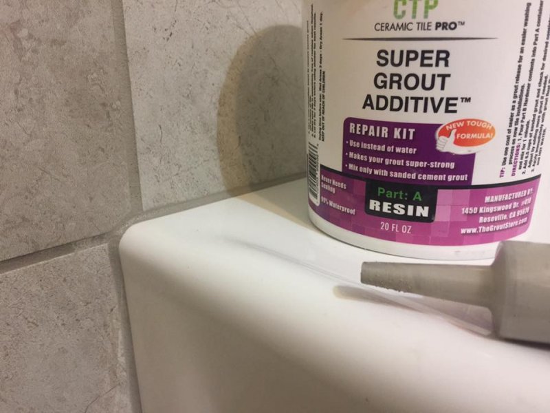

Two of these, some tile floors, kitchen counters and coming back to install Super Grout in the floor to tub joint.
You shower guys should try this stuff if you havent yet..
View attachment 74851 View attachment 74852

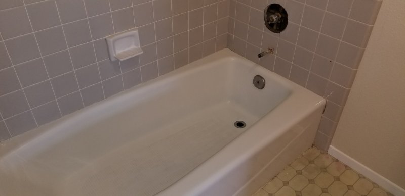

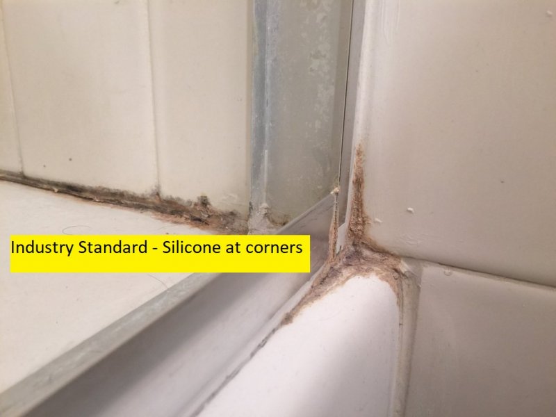

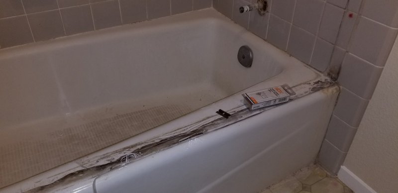

Interesting product. Couple questions
So the porcelain tub to wall tile interface has a lot movement.
How much movement will this allow before failing? breaking or losing bond. How flexible is it as a percentage?
One concern in walk in showers is floor perimeter caulk trapping water in substrate, whereas grout allows vapor transmission.
Does this product allow vapor transmission?
And if it does not, is there mold/ mildew inhibitors to keep product from staining from the inside out. Like caulk
Must the joint be completely dry before applying?
Jason Pettinato
I’ll try to get some of my longtime clients to chime in and give their personal view on how they use Super Grout Additive®
It is not flexible, it’s just the opposite, extremely strong but if you have excessive movement it may not be your answer. If you can easily move the tub or similar suggesting that it wasn’t installed securely, I would let the customer know about that and let them decide if they want to use caulk that may develop mildew issues or the epoxy which may develop a hairline crack that you may be able to fill-in.
It does do a great job on any and all corners with minor expansion contraction without cracking. It is a good idea to vacuum any wet areas to allow the epoxy to bond properly. I don’t know if it allows vapor transmission but can ask my chemist and let you know.

@GreenTechAgain , Benefits of using Super Grout Additive®
  1. No more call backs on issues using caulk/silicone such as mildew/mold, not bonding or peeling away, cracking or becoming brittle.
  2. charge a premium for a more professional repair
  3. Very little product is needed. As little as 1/2 kit or approx $15 per repair for a $175+ job.
  4. No chemicals needed, cleans with warm/hot water and microfiber towel.
  5. Mix any color grout so very little waste vs buying individual tubes of caulk for each color that may expire before using the complete contents.
  6. Easier to apply than 100% silicone
  7. Outperforms "Industry Standard" per TCNA hands down
  8. Can also be used as a traditional epoxy grout for new shower floor grout installations.
  9. 99% water, or just as waterproof as ceramic or porcelain tile.
  10. Never needs sealing

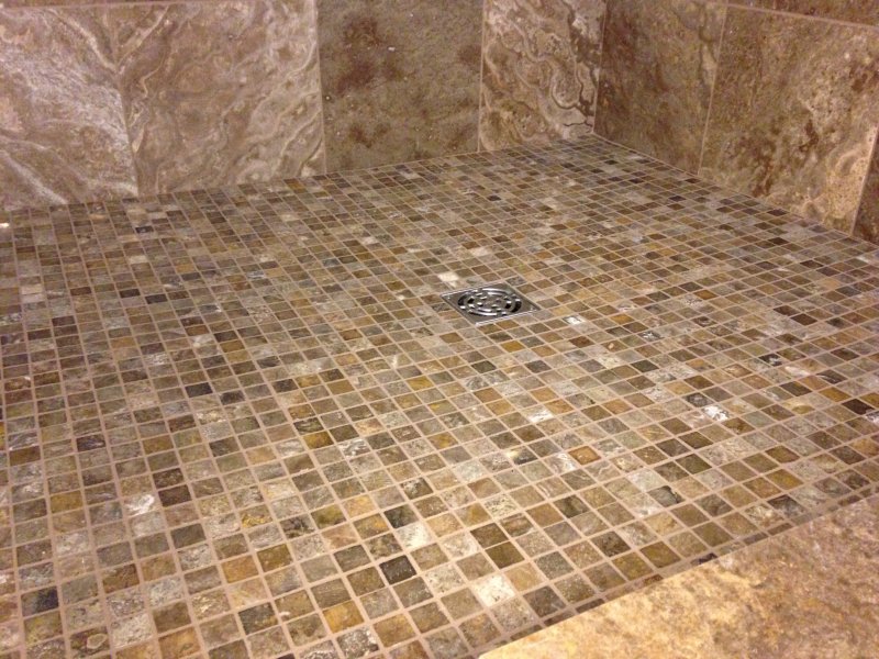

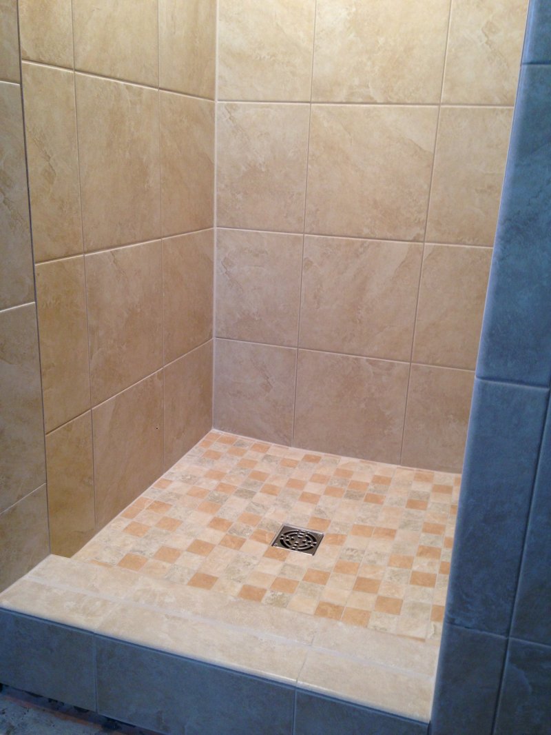

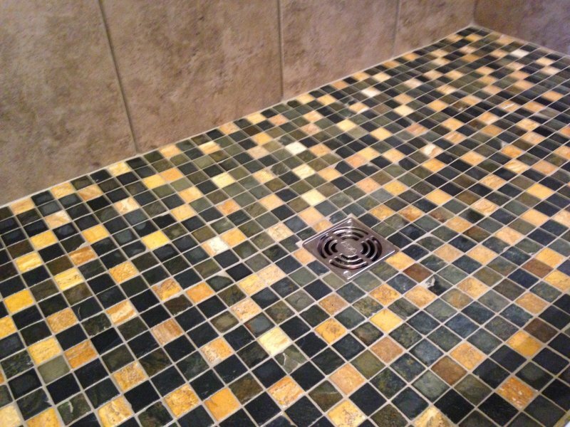

Since Super Grout Additive® is a true Epoxy, you can grout complete shower floors too.

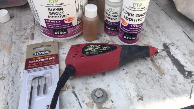

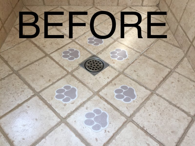

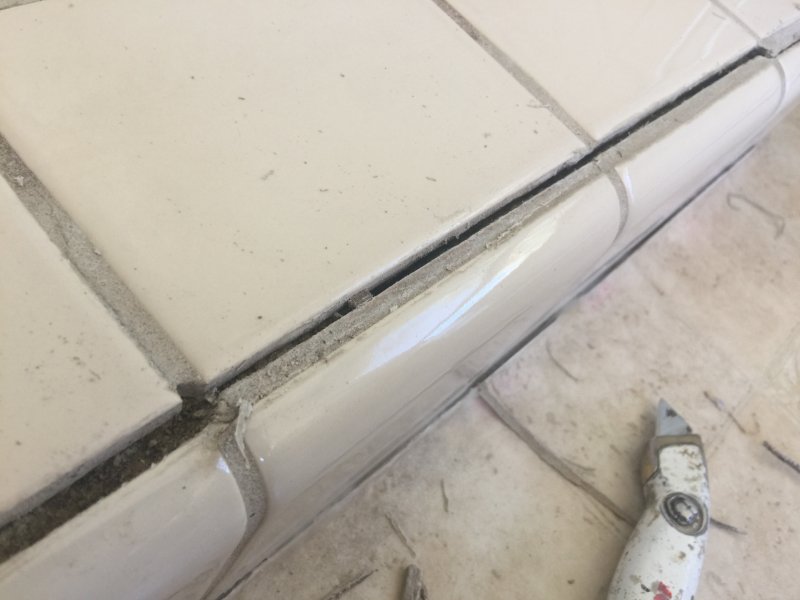

@Jason Pettinato Ive been watching a bunch of your youtube videos for a while now. One question I had was for removing old grout. In one video you removed it very easily with just a razor knife on some unsanded grout, if it doesnt come out that easily what is your tool of choice?
I saw one guy on youtube with a multi tool that he attached a shop vac to which seemed pretty fast and no mess. What do you think about the other electric tools? do you prefer to just remove by hand?
Its always a pain kind of for me, looking for a better system that is faster and clean as possible
Jason Pettinato
@Acp , for unsanded or tight joints you can use the Hyde Regrout Tool with the pointed bit. Sanded or joints 1/8”+ a makita 4” angle grinder with diamond blade but that is very dusty and you have to be careful not to damage tile.

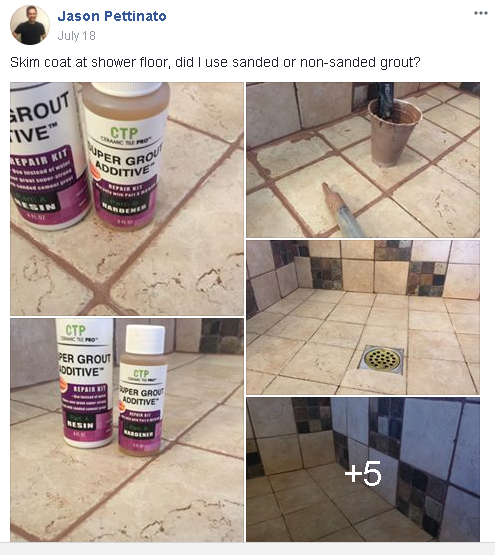

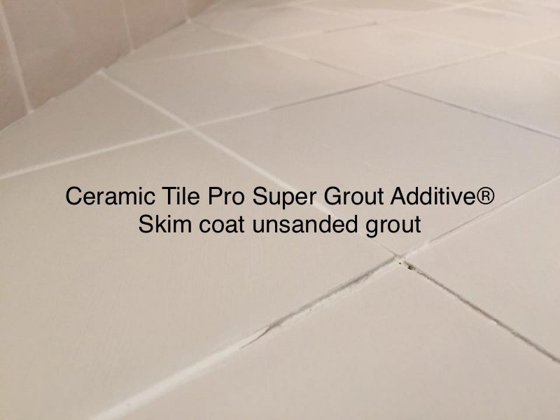

You can also skim coat over grout, make sure the original grout has been scrubbed really well, sometimes an acid etch is necessary for proper bond

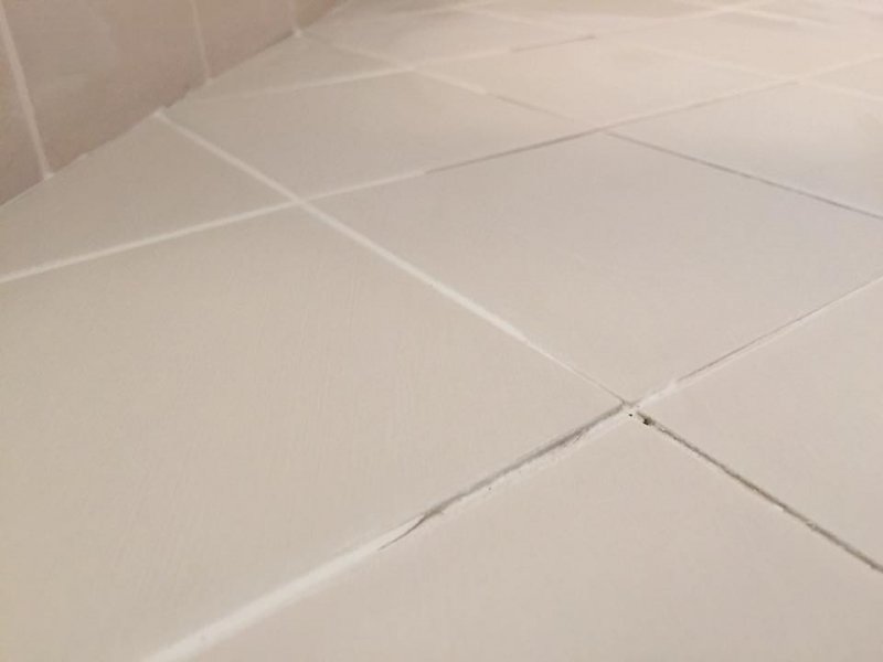

@Mikey P , Ceramic Tile Pro Super Grout Additive® has been out for over 6 years. I have personally tested it in my own bathroom at shower floor perimeters and vanity counters where tile meets backsplash. I was always having an issue where the side wall of the backsplash would continually crack. There was a pocket door on that wall so there was very little support and you could move the wall back and forth with little effort. I noticed that the epoxy grout was strong enough to withstand that movement and years later, it never cracked again.
You can skim coat over CLEAN grout. I will offer this option to my customers if the grout is badly damaged or just won't come clean. I specialize in shower restoration work so most of the repairs are shower floors which happens to be one of the hardest areas to restore. We all know that.
