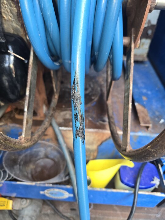

The parking lot splooged a bit of tar on my solution line. I'll watch out for the patched areas when I am laying out my lines from now on. Any solvents you guys have found work really well at getting this stuff off?

I use pog on a rag. If i need something a little stronger i use rubbing alcohol. But pog generally works well. Use a wet towel afterwards to remove the pog

Acetone from your paint store or Lowe’s or Home Depot.
No it won’t soften your hose like somebody’s going to say.

Forgot to mention (because i use it in place of pog) is citrus based spotter. I use pro chem citrus pro and citrus gel(gum remover) to remove tar stains on my hoses because it worksand is on my truck. But when i do it at my shop i use odorless mineral spirits. Only because it works and is handy i have a part's washer with 30 gallons of the stuff handy

just get some goo gone and a razor blade. spray, scrub, and shave it if it doesn't come off

The day it happened I wrapped some painters tape around the tar splooge to prevent any further catastrophes.
