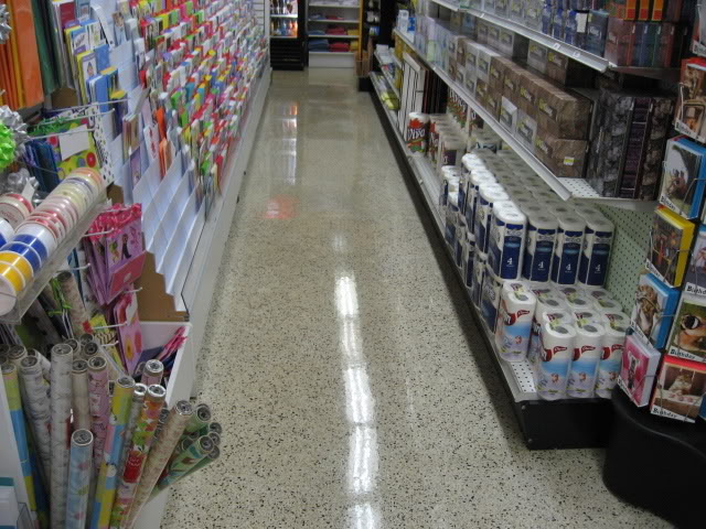

This is a 50+ year old drug store that we have Terralgaze and I-Shine on. The one good thing about it is that you can scrub and re-coat and buff to keep it pretty. Of course the proper or prefered way is to grind, hone and polish. This is cost prohibitive for most though.
Here is a picture of the drugstore with the Terraglaze and I-Shine.
