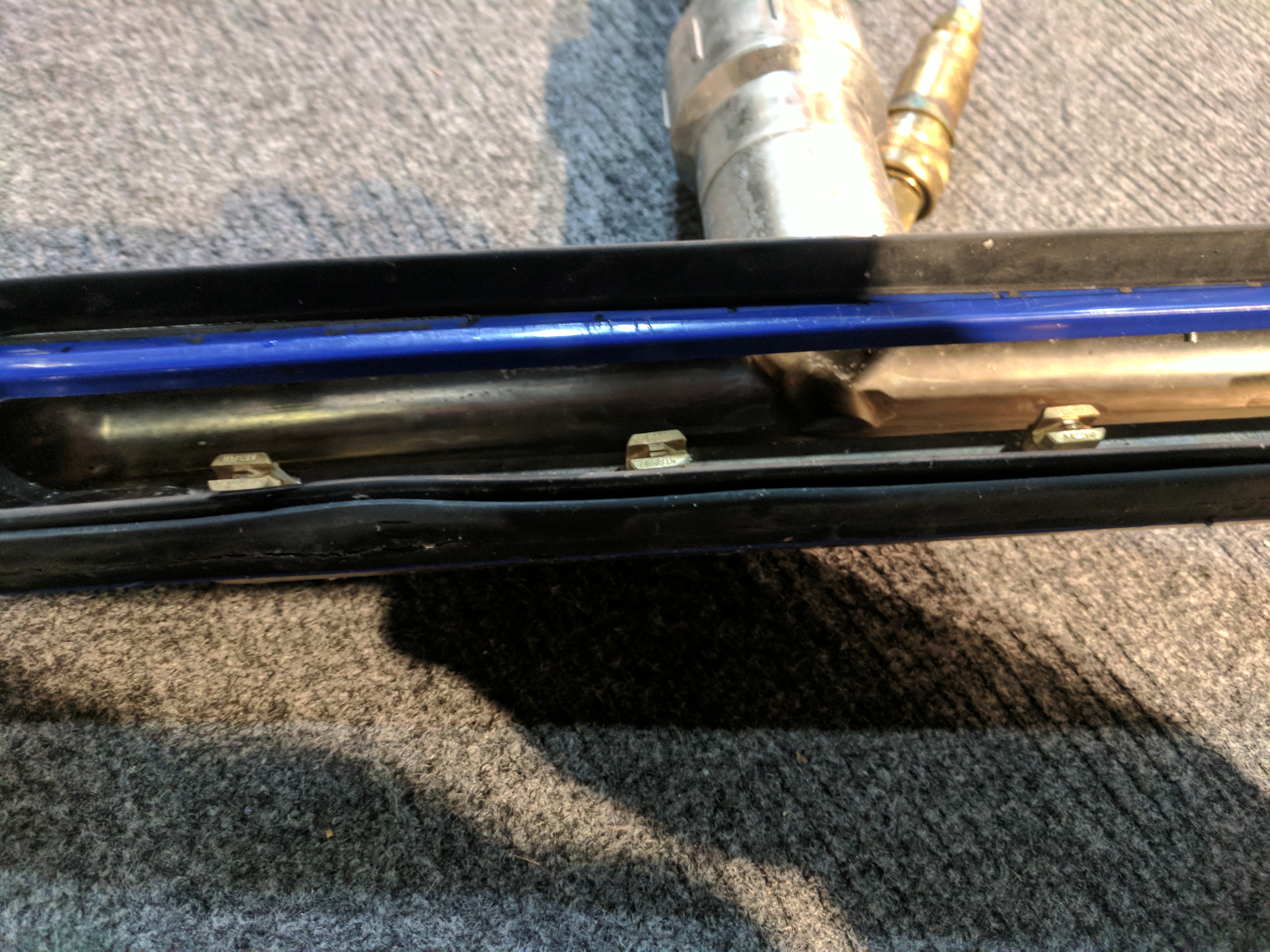

I have both on my gecko tool. I prefer the brush as the squeegee one either locks to the floor or doesn't pick up anything. This is what happened to the squeegee one after its 4th use.

Because the blue one has an opening vertical slot at the back side (it does not close a full circle). So I don't see how it could lock.
And Ron, yours look very different than the blue rubber. Is that am older WestPak model? Mine connects differently.

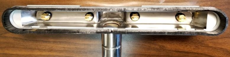

Does the spray bar STILL block the vac opening on that Gecko tool?

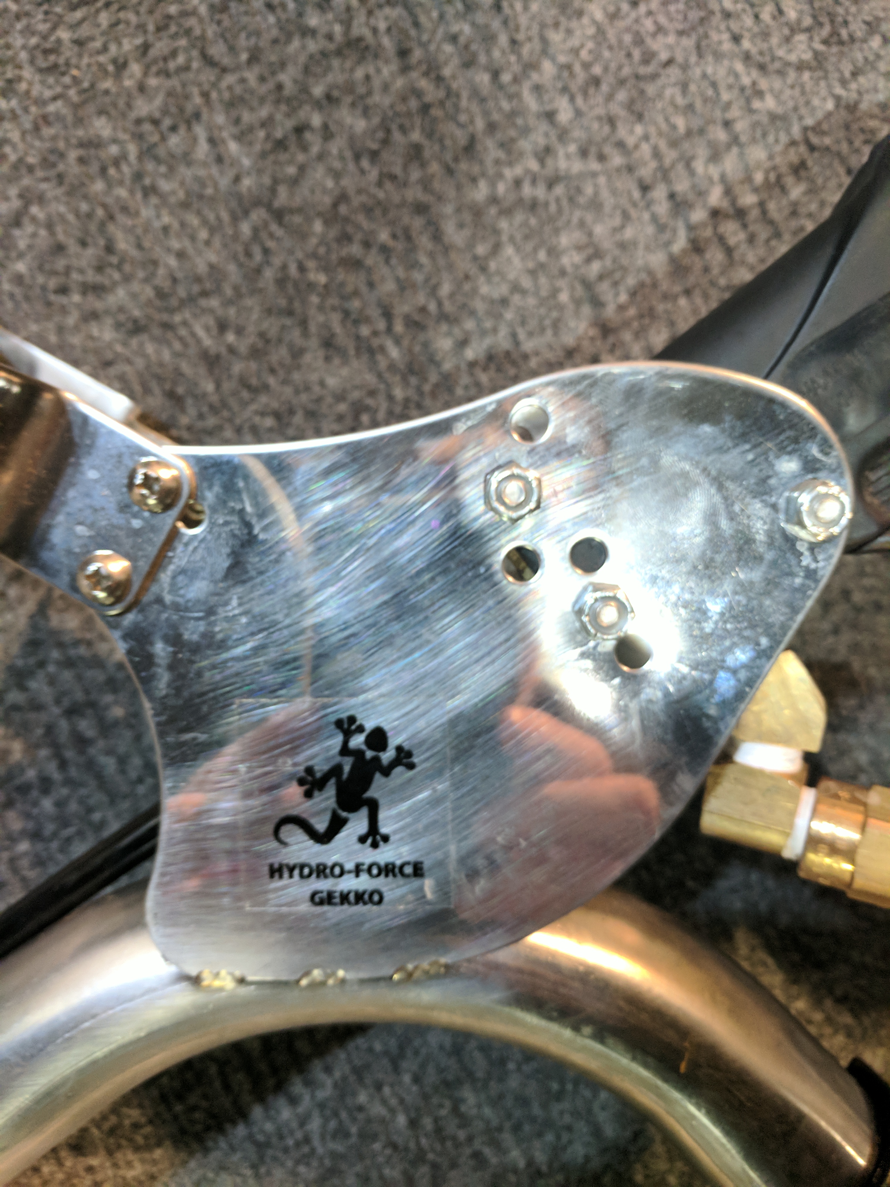

Mine is the Hydroforce gekko. New model. No Jimmy, they have changed the spray manifold so it doesn't block the vac chamber. I know the first one was a piece of crap. They changed the quick connects as well, making it simpler to change heads. White shoes are always a mistake. Breaking in some darker ones but no matter what, shoes last me 4-6 months at most.

Yes, it's the same as yours. It doesn't lock up as bad as a cheap, red rubber squeegee, but it adds more work to pushing and pulling it vs using the brush.
