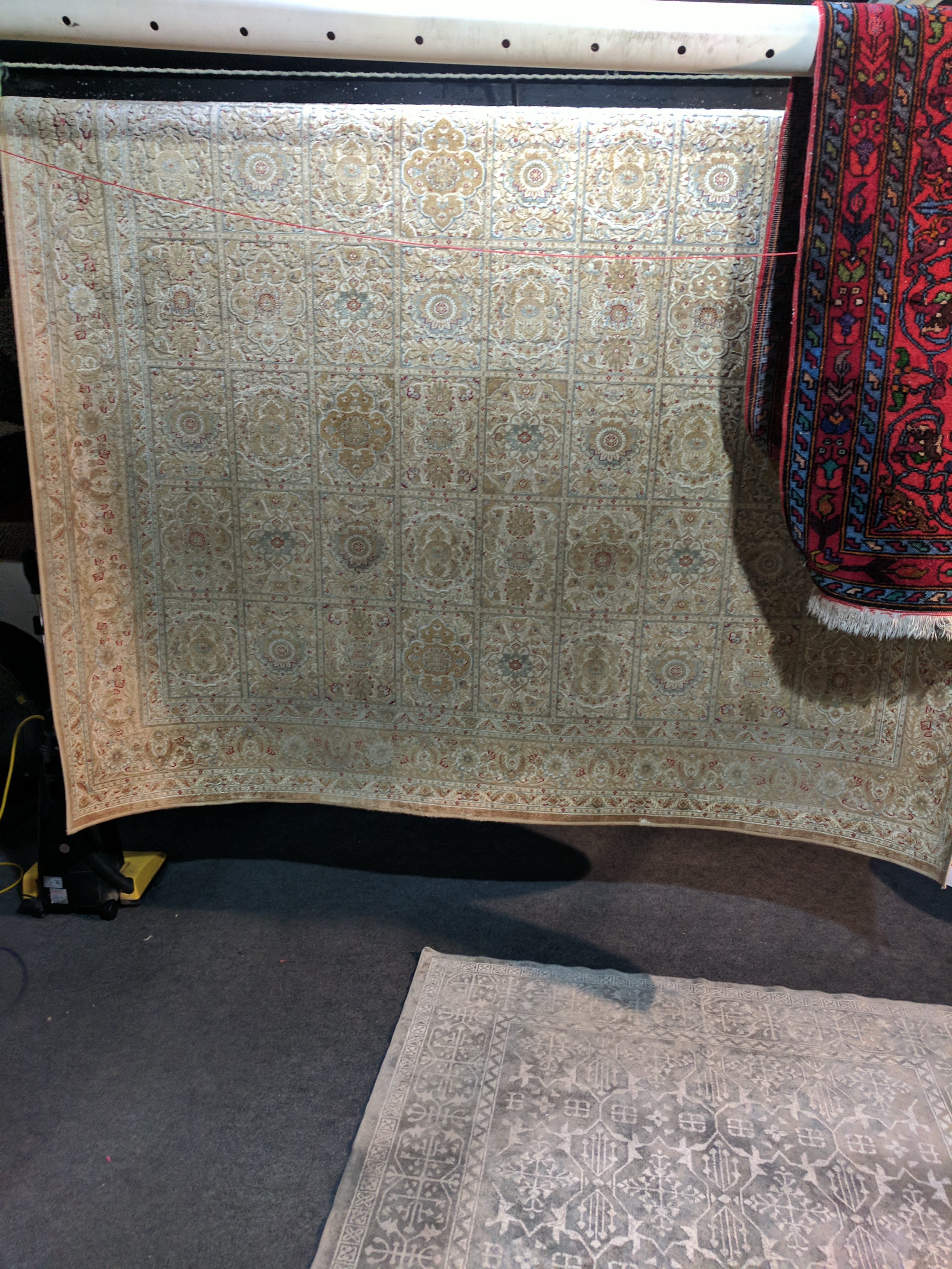

Tom, I am cleaning viscose rugs at the customers risk only. Viscose rugs vary in quality of construction from paper thin to simulating a top quality silk rug. I have a customer who has 2 20ft.x24ft viscose rugs in their home values at $79,000 each. I have cleaned them several times on location using my TM with cold water, fine fabric prespray and neutral rinse. So far, so good. I dread the day when they are actually dirty. I have ruined several cheap viscose rugs in the shop, using similar procedures. Usually, these are the very thin ones. Pile distortion and nap reversal are the main culprits. If you have a wash pit or wash tub, you should be able to process them with a cold water wash and rinse, put them through a centrifuge and groom and dry. There will be a certain percentage that will have problems. For now, I will only do them at the customers risk and have walked away from many.

Rayon is difficult enough, but the big problem is that it's sold as silk and at silk prices. I called a retailer about one that I thought we were going to have to replace to see what our cost would be. He said to bring it down and he'd give us the replacement. His cost was $400 for a rug that retailed for $6,000, so he could afford to be generous.
Use of rayon fiber is only one of the problems though. There are now three varieties of hand-loomed rayon construction; one looks like a hand-knotted rug, one looks like an Indian hand-tufted, and one looks like a high quality machine tufted rug. All of these constructions are fragile.
No tumbling, no brush scrubbing, sometimes no hanging. Often every spill is permanent.

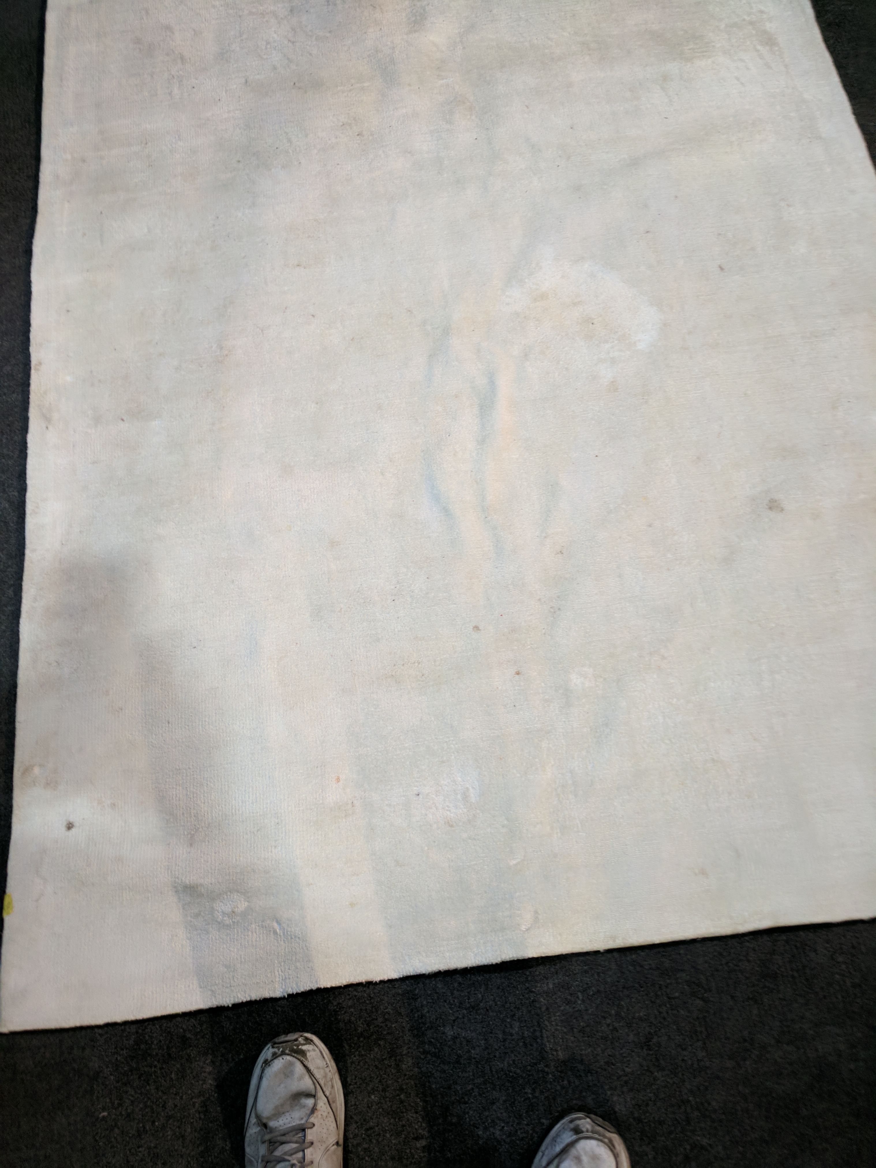

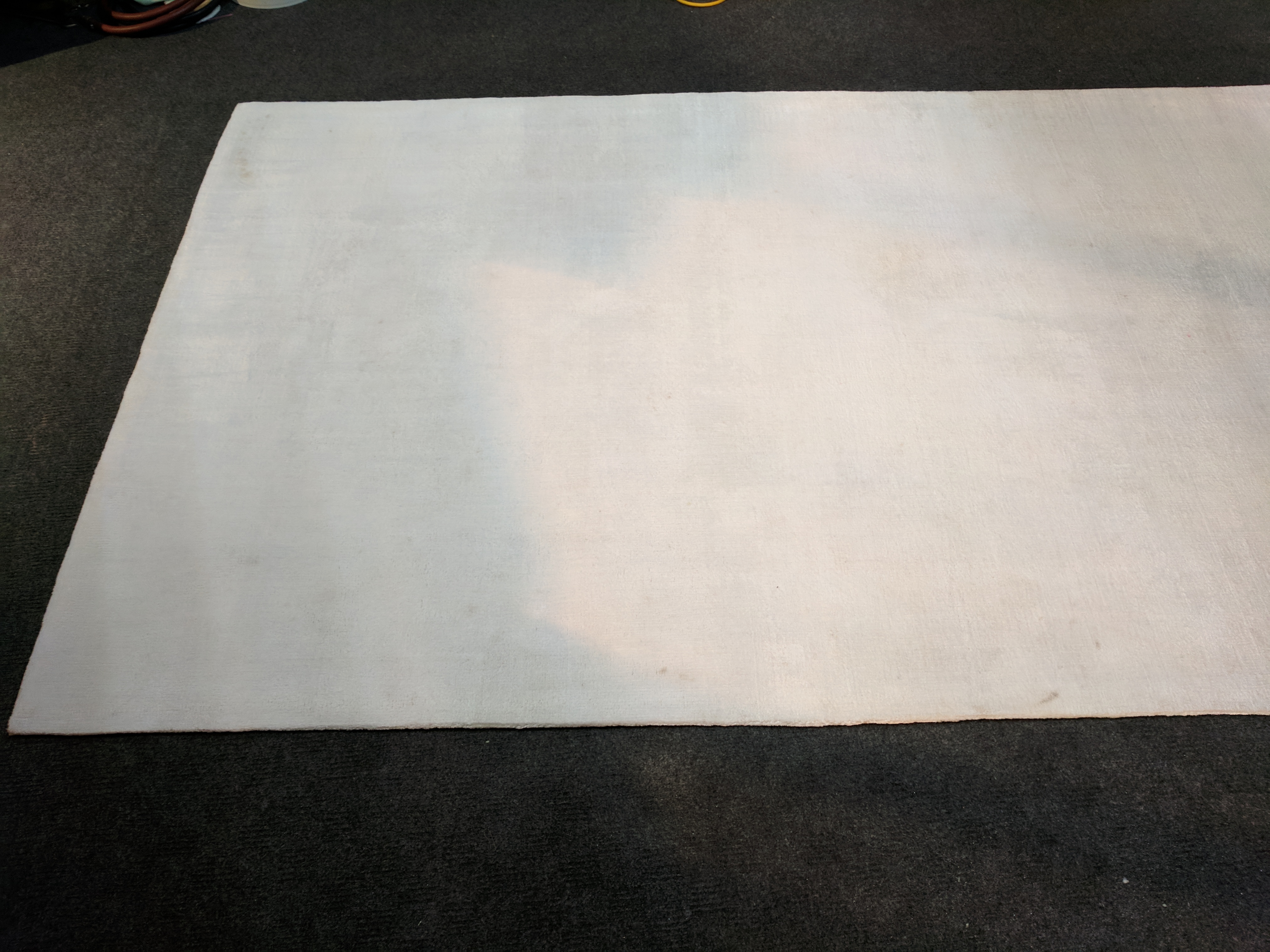

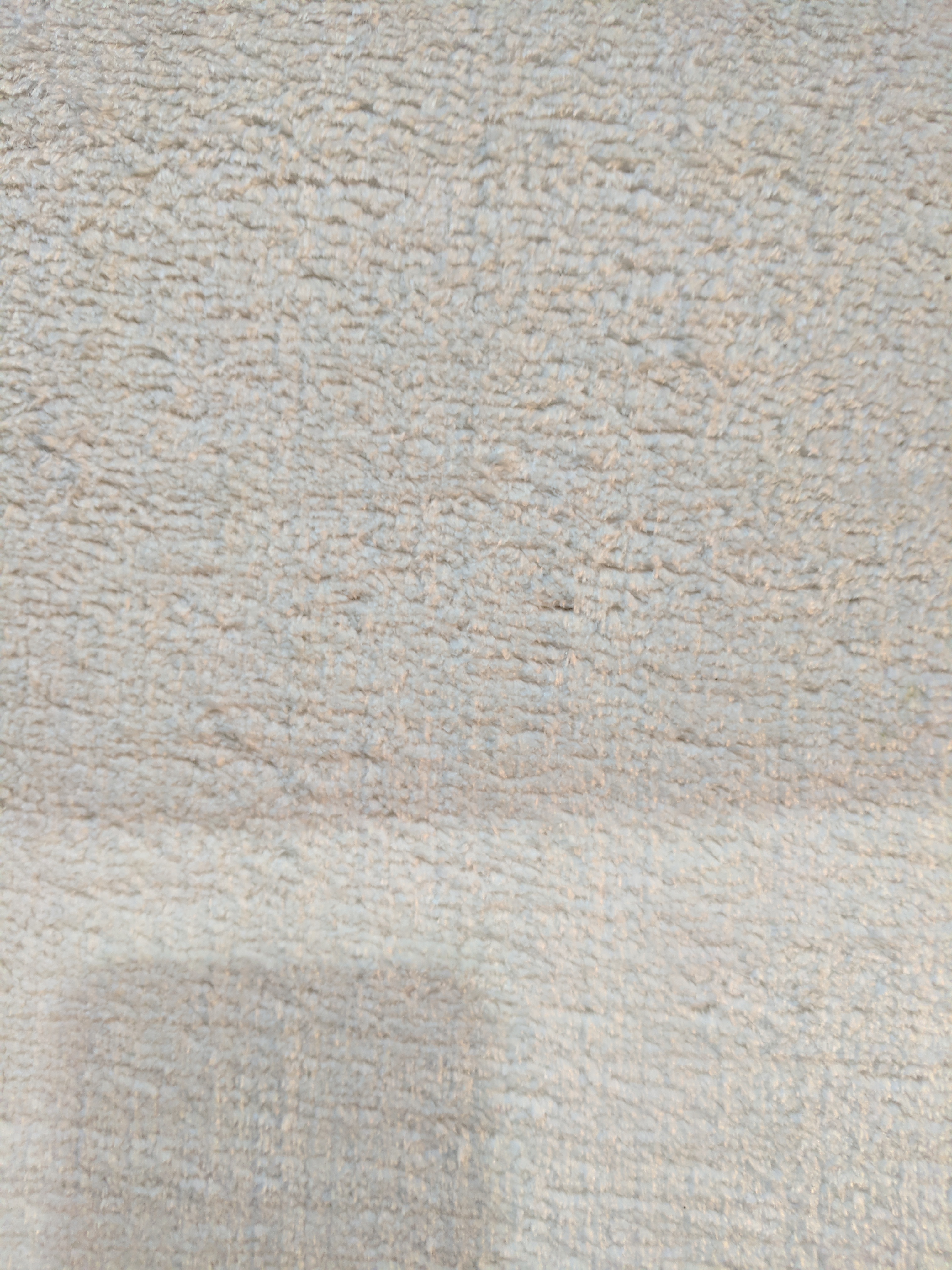

Here is a viscose/cotton rug that the customer has me permission to destroy. (That's how I word it to the customer and they understand they have to pay me to fix or fook their rug). I presprayed it with Prochems fine fabric prespray, let it dwell for a bit. Then shampooed with a shower feed floor machine using Prochems fine fabric shampoo for cotton. Rinsed using a wand and groomed. You can see the textural changes and matting but better than it was and when it dries, we can groom some of it out. Most viscose don't clean up as well and most, we could not use a shampoo machine.

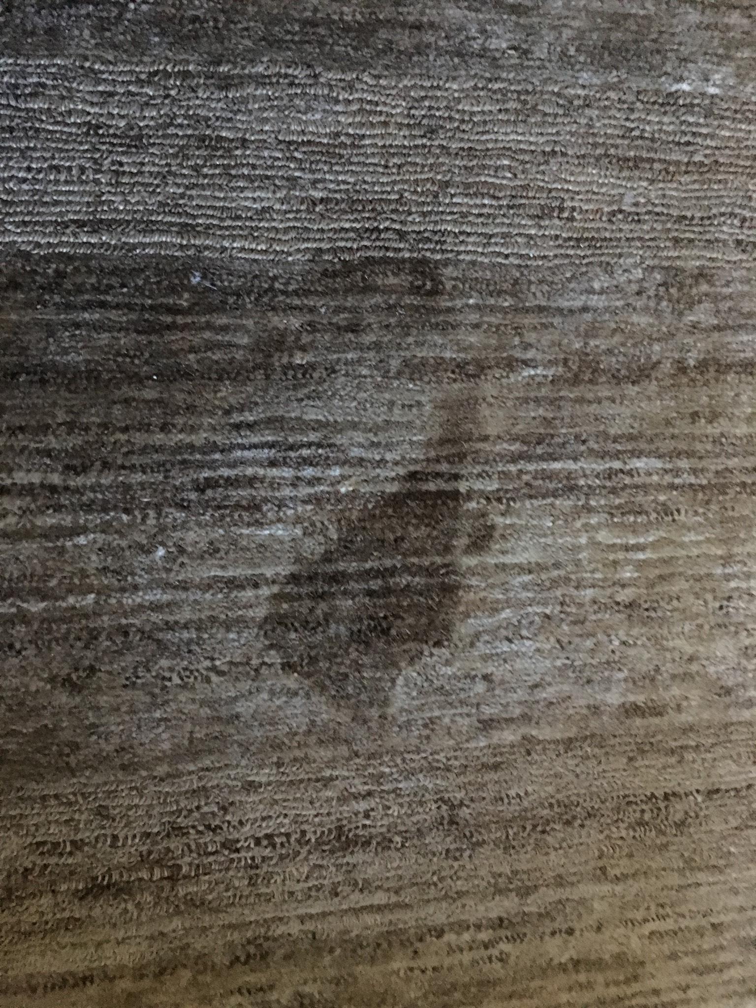

Customer called with this "Cactus Thistle" rug with a pee spot.
How many names are there for this stuff?

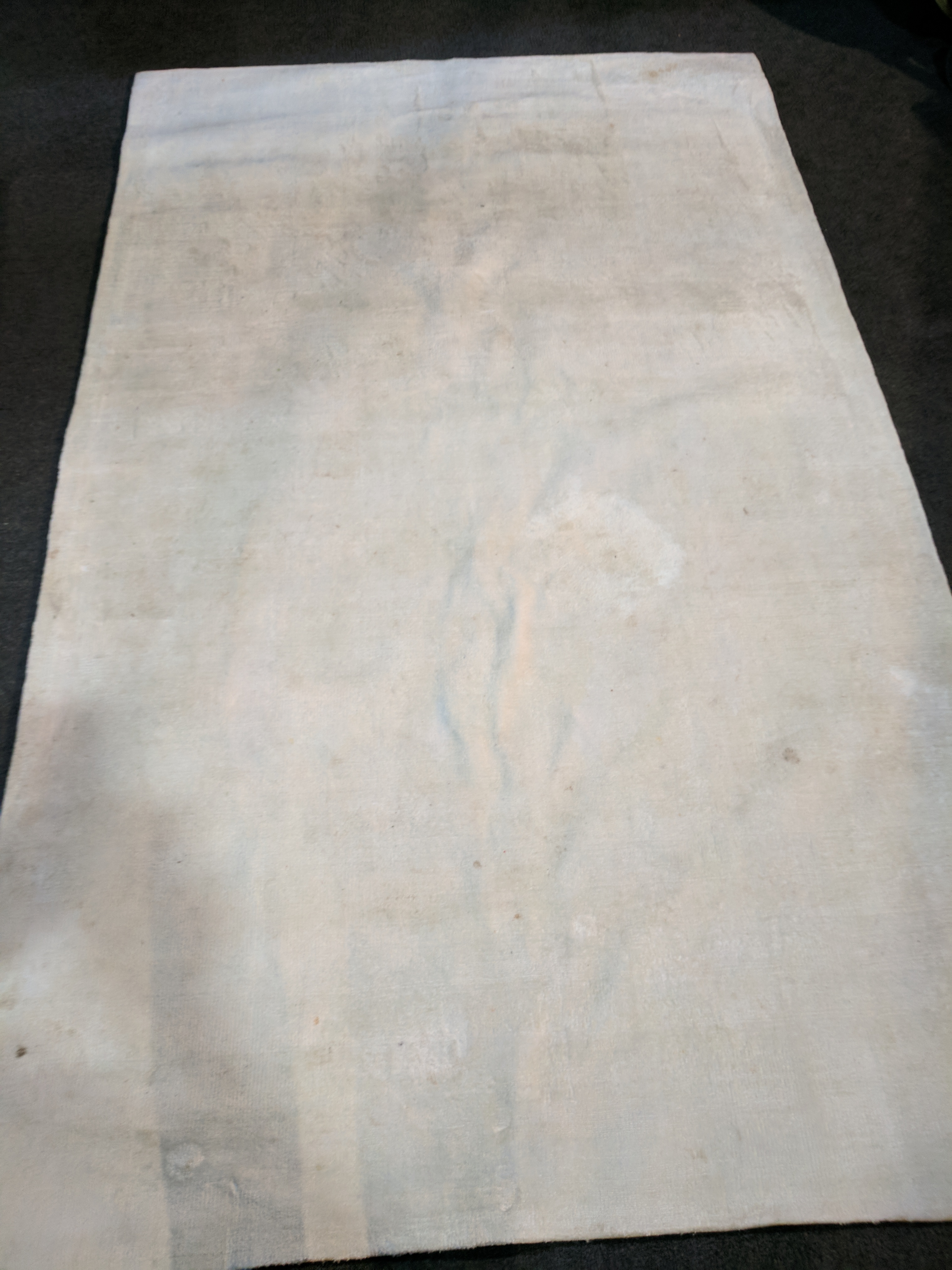

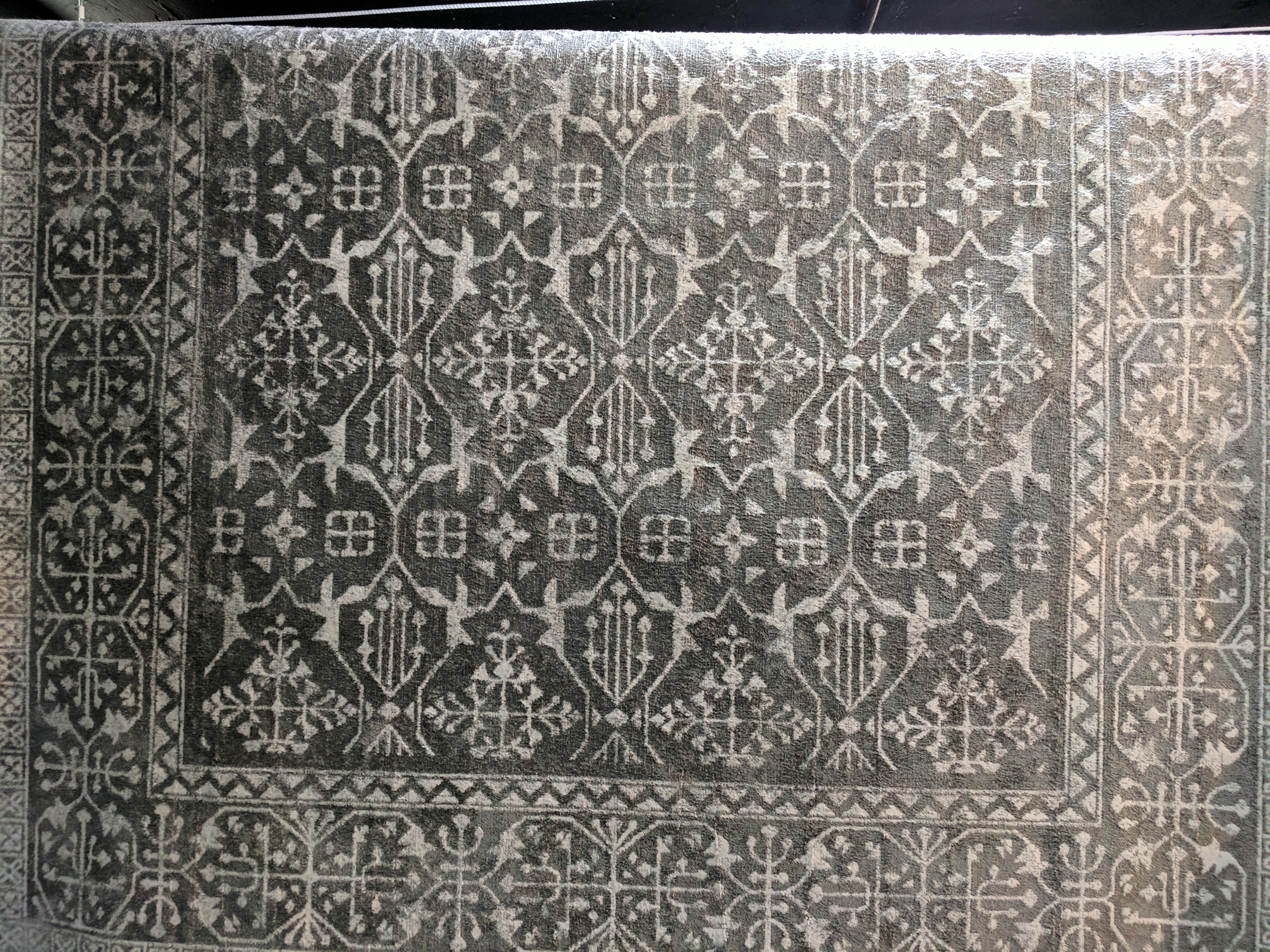

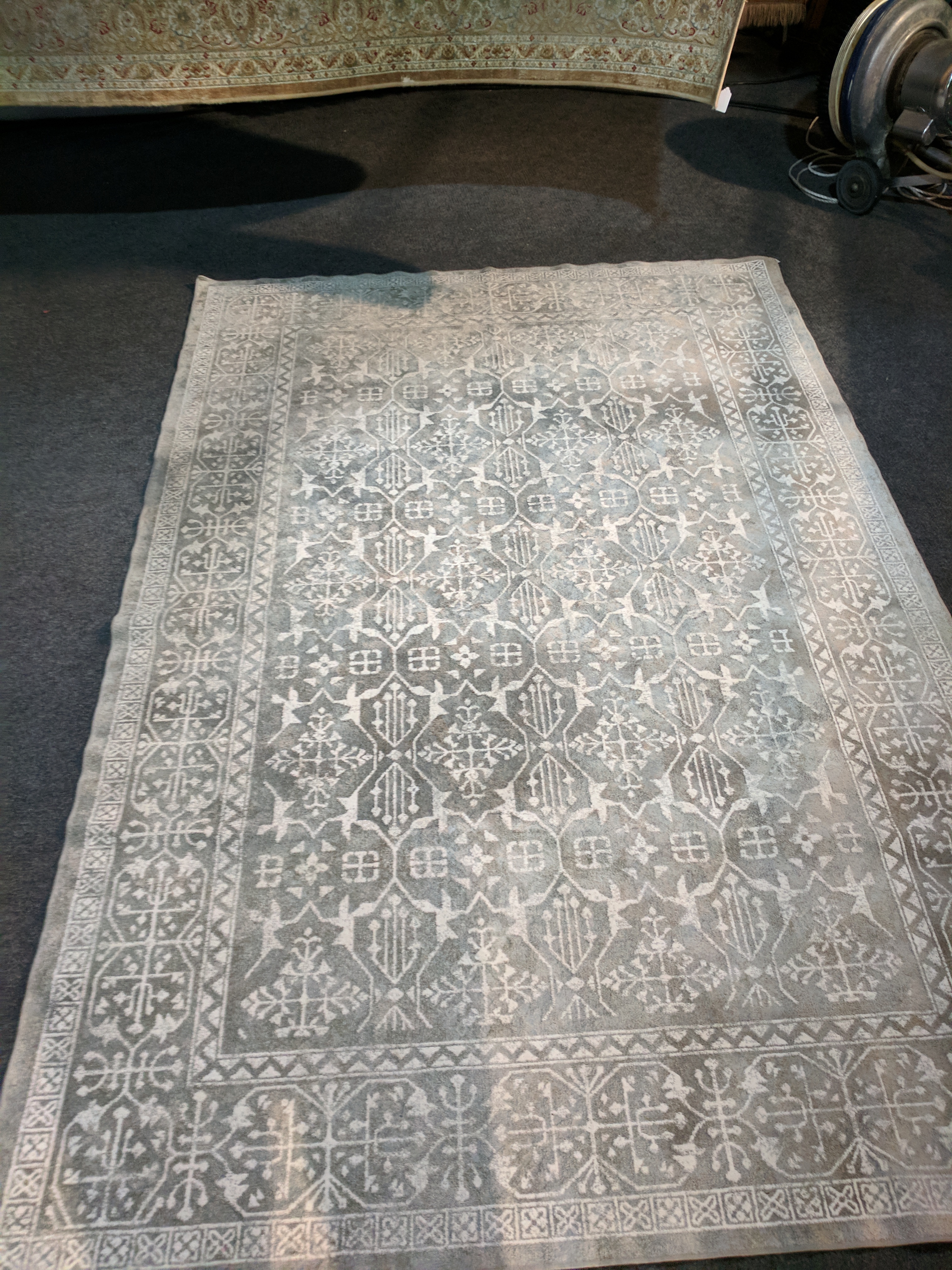

Here are a couple more viscose rugs that we cleaned at the customers risk. The brown one is an 8x10, fairly thick. You can see some matting but overall not too bad and some of that will come out when it drys. The smaller grey one is paper thin and had a buttermilk stain on it. We used a mild prespray then rinsed with a wand using lukewarm neutral solution. Deodorizers with Benedict. I think it's very acceptable however, I have had similar rugs distort, mat and have severe pile reversal. As long as the customer is willing to accept the risk, I don't mind cleaning them. The more I do, the better I get.

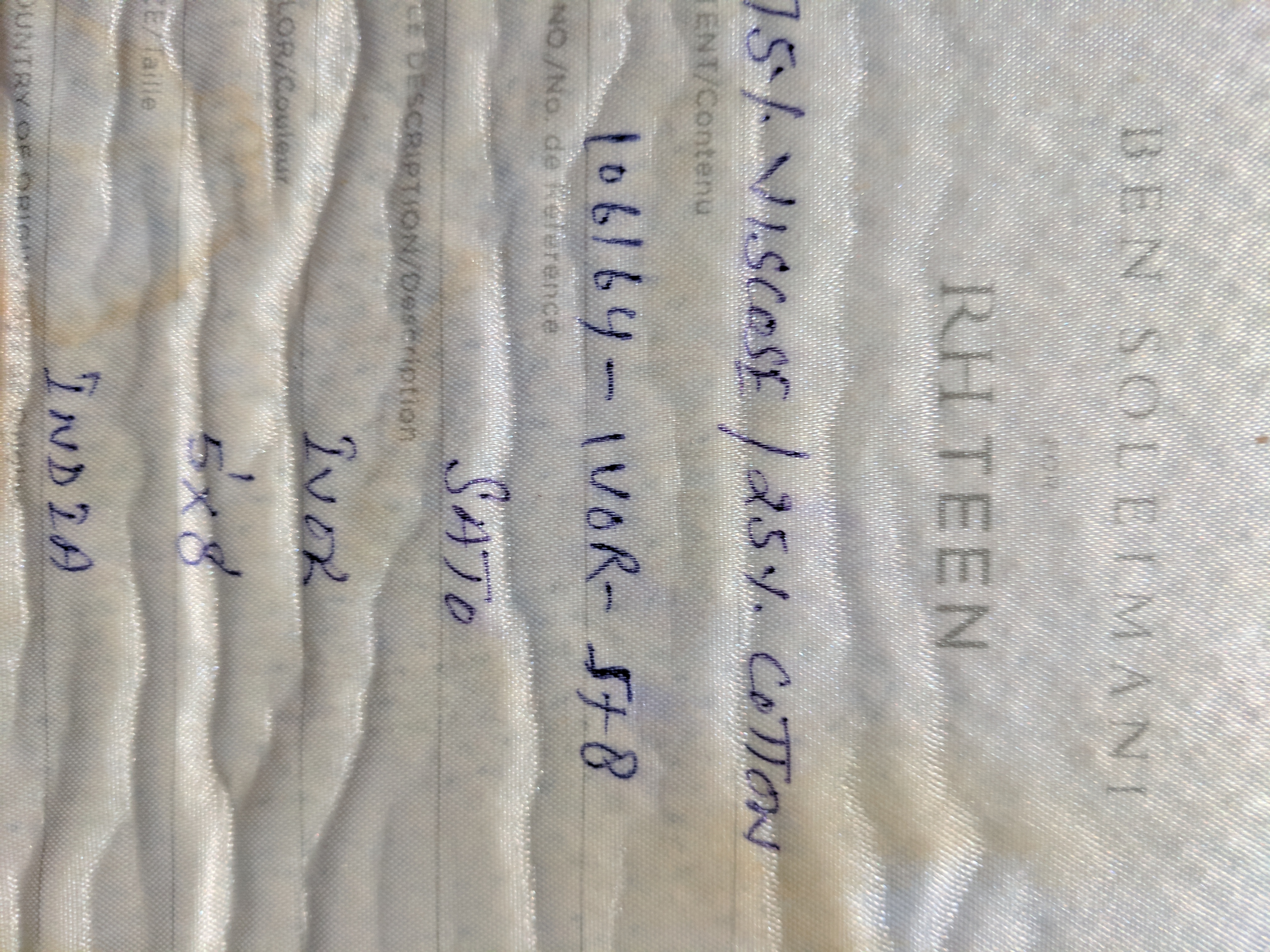

If the label says 'Ben Soliemani' you know two things: it was expensive, it is unbelievable crap.
img_20171224_140313-jpg.76546
Hand-loomed rugs that have this backing might be the worst. The latex is likely to wick up if you wet clean, and if they get any normal foot traffic they will come apart in about 18 months time. Often rows of tufts will come our when pre-vacuumed.
Identify hand-loomed by breaking the nap open and looking for a weft fiber between the tufts. Tufted and knotted rugs won't have that.
