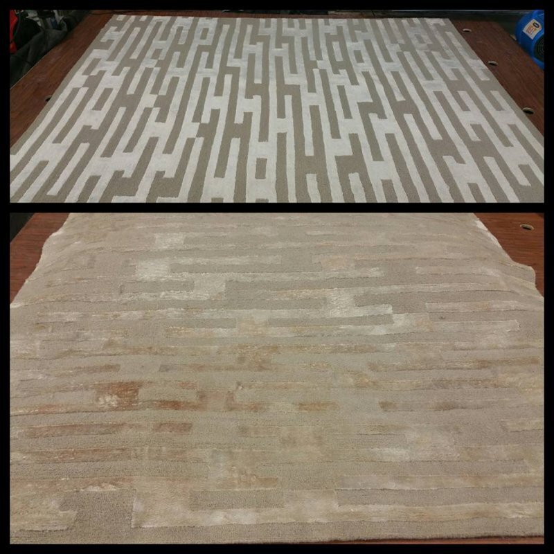

Robert Hughes
We typically wash them. We keep the ph low, dry it fast, and groom it well. Here is a wool with viscose that suffered some browning that was able to be fixed.
