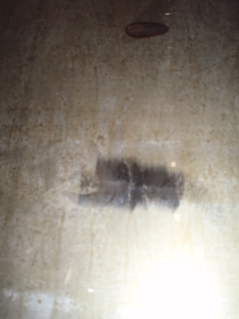

After 4 years It developed a fresh tank drip.
See the crack?
I can't either, but its there

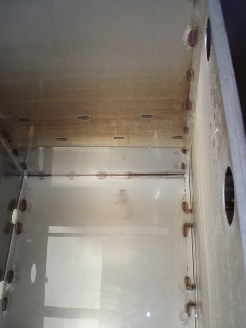

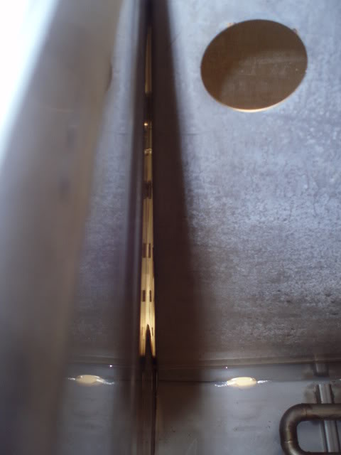

Both my baffle walls fell over in the first year on my Aero Tech built tank. I had a local welder re tack them in. the sides worked loose but the top and bottom welds are holding. AT had nothing on the bottom holding the walls down. :shock:

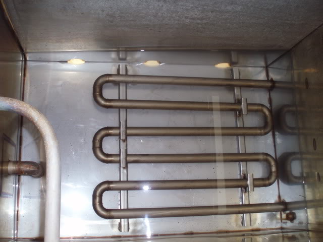

HX pipe from the radiator

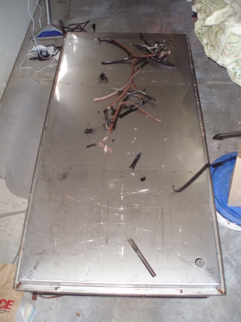

Redoing the lid gasket while I'm in there.

I had Nordik1 install that HX pipe Vince.

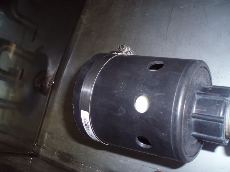

Do yo self a flave of flave and wrap a hose clamp around yo float to keep it from oblonging.
50,041
I have no float. That particular float was found in pieces in the bottom of my tank. I now have a brass one, just like the one Jim showed, but I have not put it in yet.

The plastic Hudson looks like a winner from a stability point. Mike, what causes them to "oblong"? Just the hot water in general?
117,348
Yep, the outer black shell cant take it for more than a few months.
Even the stock pvc pipe that attached to it oblonged like mad.
