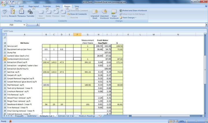

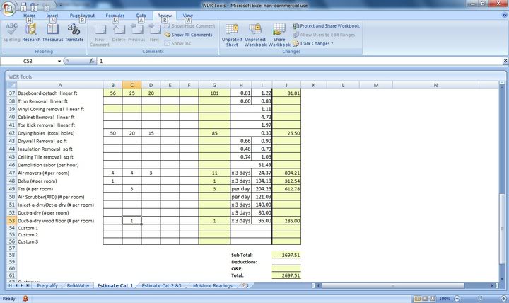

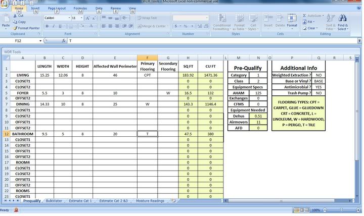

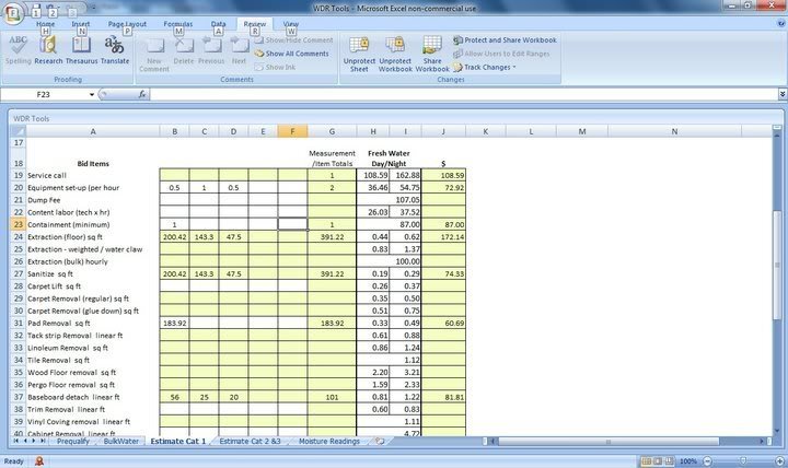

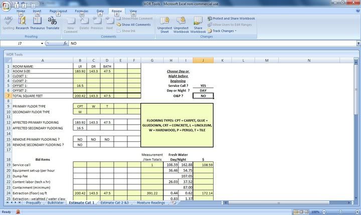

I created this working excel spreadsheet, and I'm still designing it. But, I can take this estimate form shown above and make it not calculate the automated stuff I've designed, and allow you to place in all of the quantities manually and it will calculate the total. There is some space below it to add in custom line items if need-be. I've sized it correctly to print off on normal paper.
There are plans to for the whole workbook to be sold/distributed so I won't give you the whole thing, but this is an early stage of what it looks like.
Enter the basic information
It auto calculates some stuff, still some information that needs to manually put in like total sq ft affected.
Beings calculating the estimate
Allows you to offer a discount, add over head and profit if you need to or 10 and 10 as some call it, and produces a total WITHOUT tax.
Shoot me a private message or an email stevenhoodlebrink at gmail.com if you're interested in having just the estimate form.

Hooty that's pretty nice setup you have there! We used an Excel spread sheet for years, it was much simpler but it worked and we got paid.

the problem with using a spreadsheet is every job is different, I know that sounds cliche but the secret to making money is putting in the little line items, like detach and reset of a vent cover, detach reset doors etc. and 100's of different things. this really comes into play on a fire restoration or rebuild job. if you have a job over 10k I think xactimate would just about pay for itself for a year in the extra money you can get by using it. could it be done with a spreadsheet or something else, yeah it could but the extra time would not be worth it and it would be next to impossible to come up with all the prices for the little things, believe me I HATE paying $130/mo to those guys, but there is a reason why they have a monopoly.
the guys who are estimators in my area, I know at least for the biggest company around here are making 100k/year. the reason for that is a guy who is good with the program and knows what they are doing with the repairs, knows what adjusters pay what, are easily capable of pulling off an extra 4 or 5 grand on a 20k job, if the job is larger it could be much more. whenever I can I always have customers send me the OTHER guys estimate. just to give you an idea, the largest company in my area sent out and adjuster to bid a loss. without seeing his first I bid the loss. later I was able to see what he had, our scopes where pretty much identical, it was surprising how close we were in what needed to be done on this smoke damage job. however I was 4k more than he was, and that was without me even really trying to massage it. this was on a 15k job. imagine if this guy is loosing 4k on 6 or 7 jobs in a month, you can easily see why good estimators get paid 100k. because they can easily pay for themselves. knowing which companies will pay 10-10 on mitigation or knowing the particulars of a certain company and adjusting the breakdown for them is valuable.

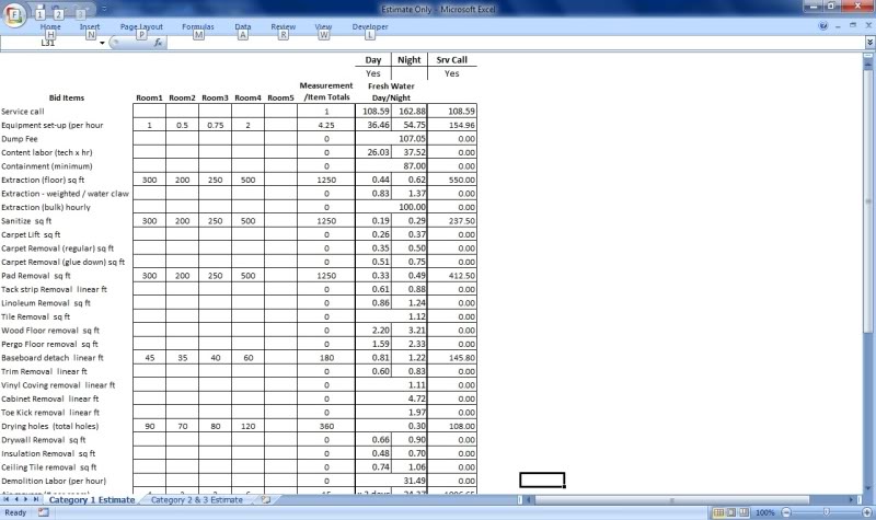

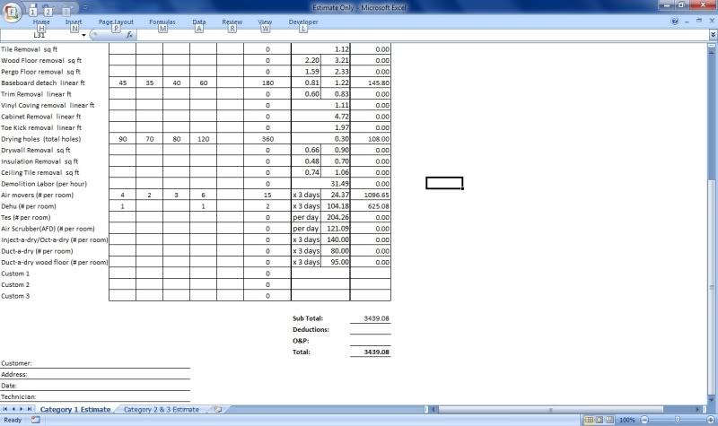

Already sent 5 of these out.
This is just a mock example.
That looks nice, a good alternative for those that don't want to rent Xactimate. Easy to read and justify your bill, nice job Hooty! 8)
steve g
if you ONLY estimate dryouts one could probably get by without xactimate, but even with hoodies spreadsheet, he has extraction after hours and during ours.
xactimate has a price for
extraction, extraction heavy, CAT 1, 2, 3 and after hours and during hours for each that is a potential of 12 different rates for extraction. that is the secret to recouping the cost of the program and then some, there is simply too many things that can be added in as a charge, to make it more profitable to use the program than not.

I would prefer to use Xactimate also. Like I said I've now sent 7 out, FREE. Its not to replace Xactimate, but its an alternative for some who don't have to $$$ right now to purchase it or who are just getting into WDR.
We had a small pinhole leak on our dishwasher a month or so ago. It ruined our pergo floor, and drywall behind our cabinets. The cabinets were able to be dried. Drywall was already toast.
I ripped out the pergo floor myself, and detached my cabinets and ripped out the drywall, took pictures first of course. When our adjuster showed up I handed him my invoice, and pictures. We took part of it and applied it to our deductible... no money out of pocket for the loss, plus we got cut a check right there for the work I did. He called out a preferred vendor and they finished the drying, and rebuild for us. I had them tent our cabinets with an E-TES they dried just fine as well as the wall behind/sill plate, they were a pretty stand up company, and had all the meters, a FLIR, and a lazer thermometer.
I showed the adjuster my whole spreadsheet. He was impressed, even with it not totally finished yet.
