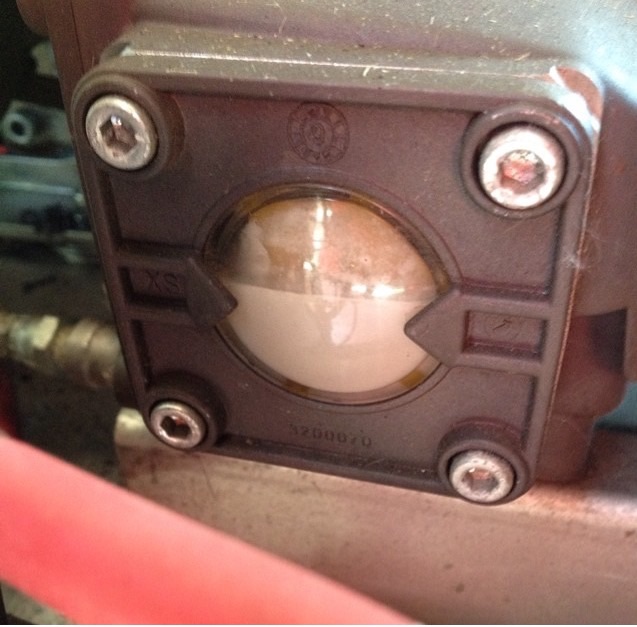

Did it look like this?

While I am no rocket scientist, I don't think that looks good.
