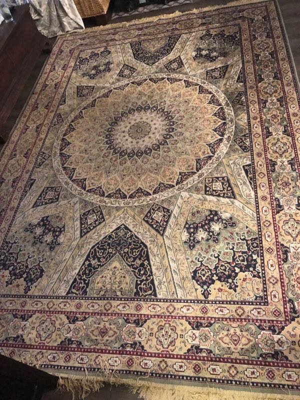

a couple I know here in NV sent me these photos wanting to know if I could clean their rug...
rather than get all geeky about it I just replied "Yes", for my minimum charge.

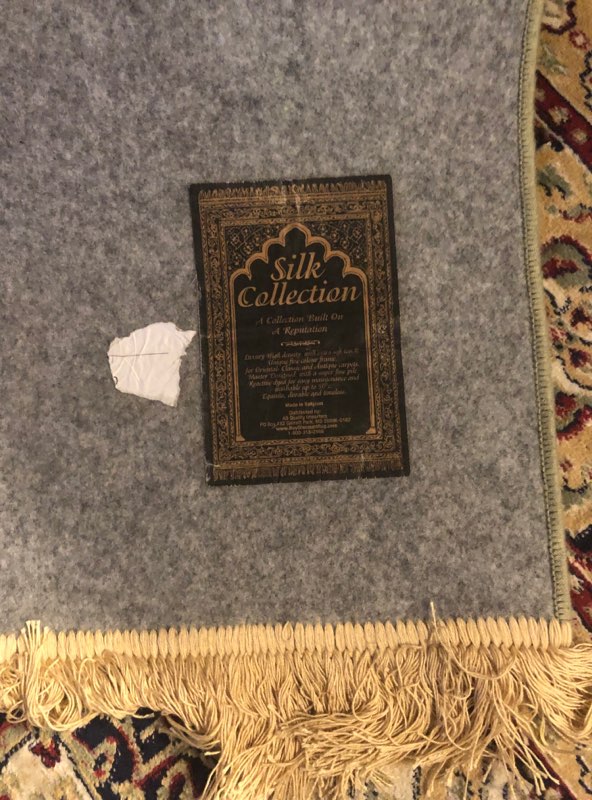

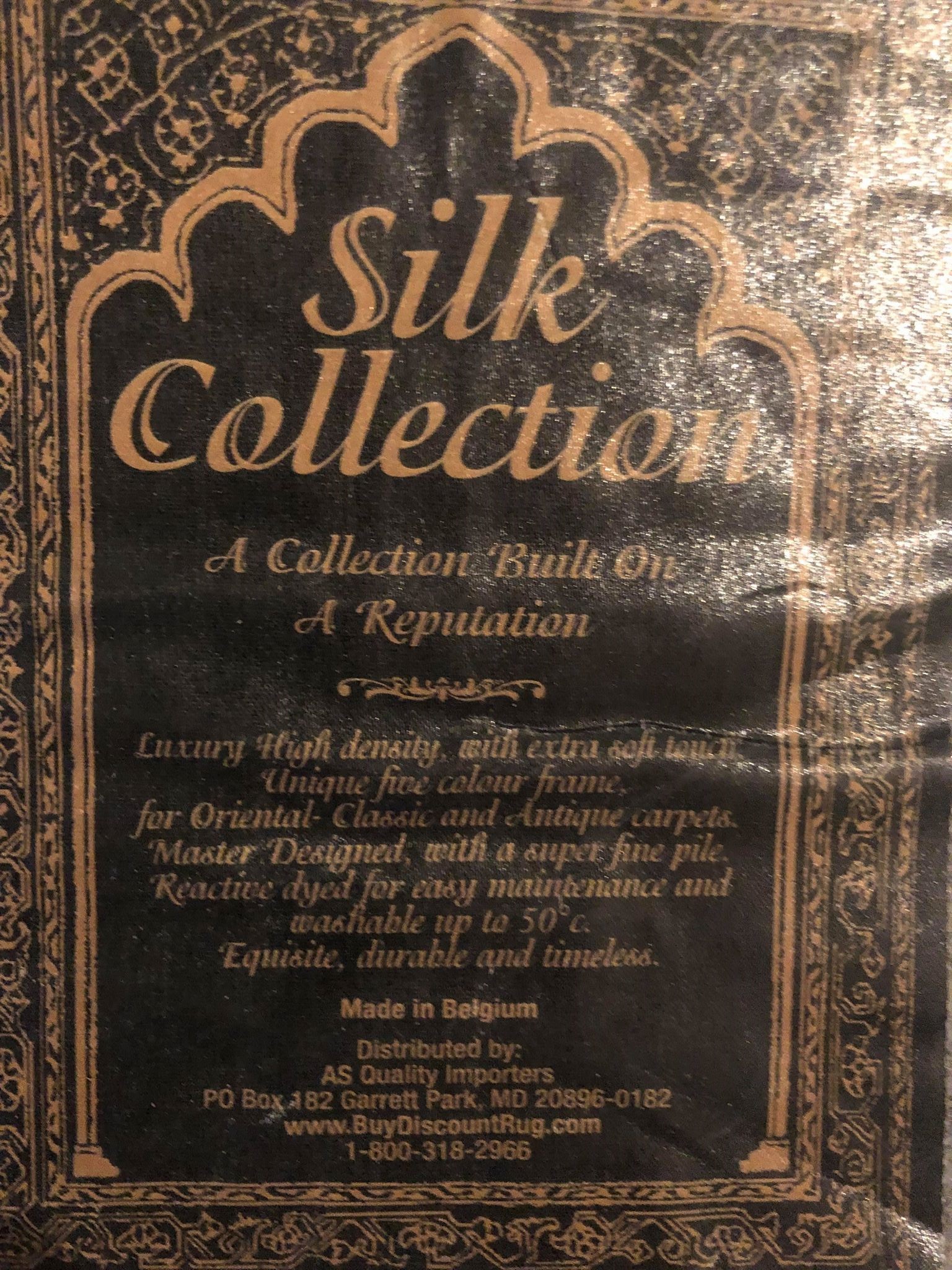

Love the label verbiage...
Reactions: Nomad74
Vacuum back of rug only so as not to cause friction damage on pile, clean on cold water setting, psi set around 350, fine fabric neutral ph prespray???
Or is that "silk" just fine threaded polyester?
The Great Oz
5,295
bryan
Bigger manufacturers have caught on that consumers know rayon is bad and are using polyester and even shiny nylon for their silk looks now. With that backing most likely poly.
