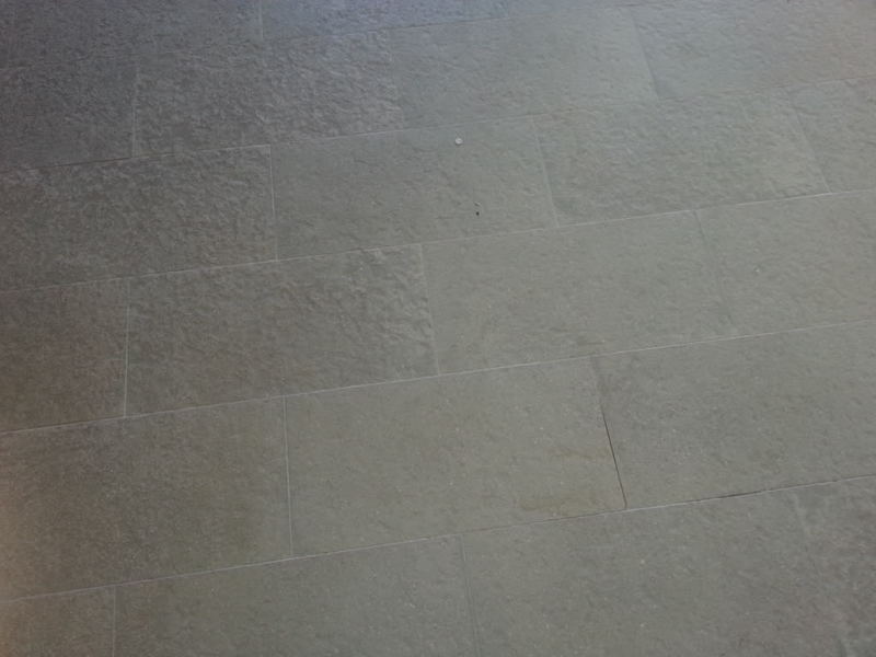

Sure looks like Limestone to me, just never seen one with this texture. acid test barely produced a fizz.
Super dense, we mopped it and scrubbed it but wasted our time. Zero absorption of soil. we could have cleaned it with just 1000 psi hot water and the Turbo Hybrid.

Looks like my neighbors driveway . His is poured concrete with color and a pattern design. The drive is 12 years and still looks good. The locals pressure clean with a spinnet and chems. jz.

Looks like flamed or bush hammered quartzite. I have e few clients with this. Very durable but mopping makes it dirty.
