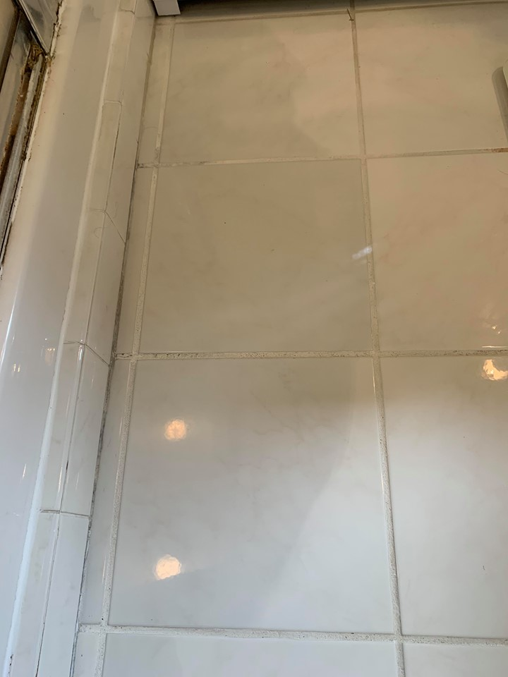

What the heck is going on here?
117,351
Not my project, sent to me from a cleaner...
Client has no clue
Looks to be water intrusion but I've never seen translucent porcelain...

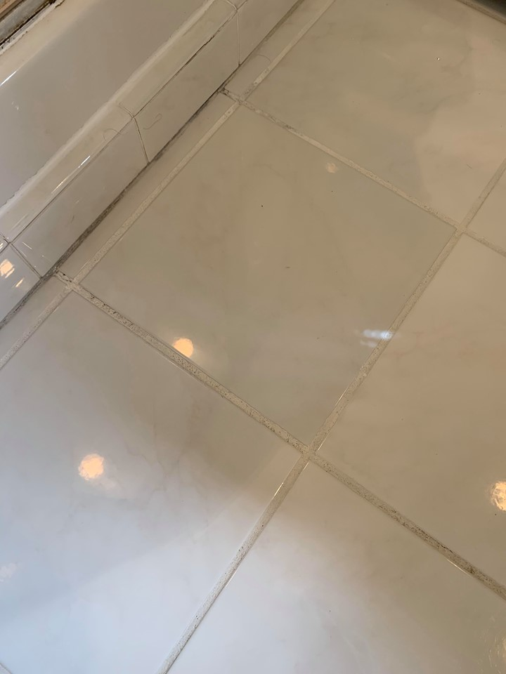

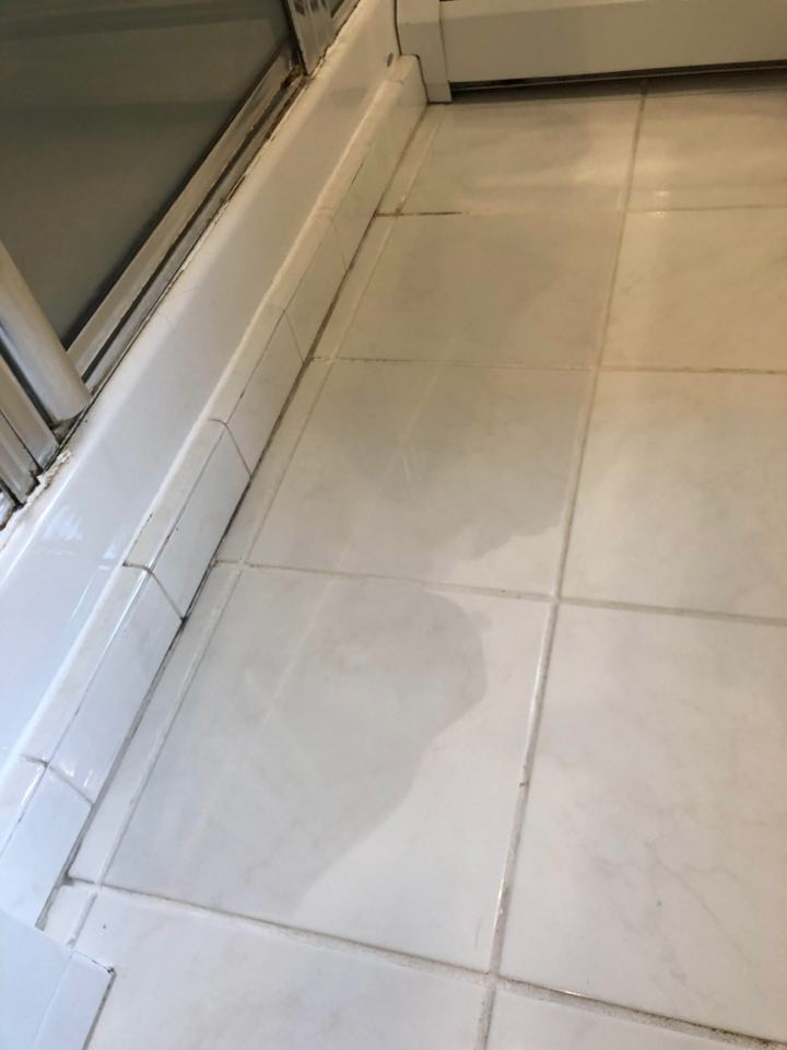

Is it a camera artifact, or does the darker color go up onto the base/baseboard heater/whatever is on the wall? (Pic #2)
If that's water below the tile, I'd like to know the condition of the substructure.
Almost looks like it’s crept up the tile in this photo aswell...
