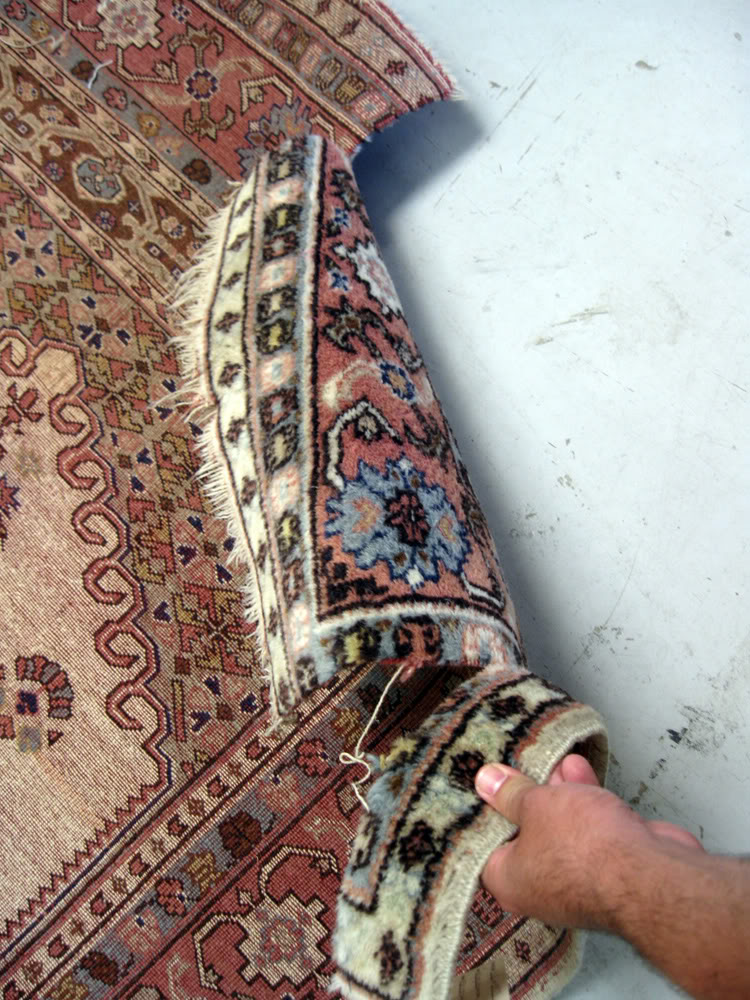

I think we all know here that it's the PERSON who makes the job great more than the equipment. You can have a good piece of equipment, like the Badger, in the wrong hands on the wrong rug, and SHAZAM - rug disaster.
This rug came in from a competitor (big franchise down the street from us - trained by IICRC trainers...) - and the comment was made when we asked "what in the hell happened?" - Answer - "It was badgered."
So my mother will fix it... but we won't be able to keep them from doing it again. They've got a pit, a Badger, and some very incomplete training - so I'm sure we will see them a lot more in the coming months.

They did knuckle head......why do you think they are fixing it?

looks to me like someone sucked the rug in to the badger because they were careless around the fringe.. seen it happen with vacuum cleaner too.
Lisa, I hope you or your mother makes some money on this repair.
I think Sweeney is right, some careless tech was probably the one processing the rug, damaged it and went told his boss the Rug Badger did it.
The Badger is an aggressive machine, if the rug is delicate maybe it shouldn't be Badgered? However that rug looks like it was damaged not because it was delicate but because someone wasn't thinking.
We've had a badger for years and never damaged a rug yet. It does take some common sense to run one, something this guy was definitely lacking in.

the damage is somewhat perplexing to me and not as simple as running a badger of the end honestly it looks cut to me
Yep - they are perfectly clean cuts. All along one end, as it got pulled up into the unit.
What's good is that with no real loss of knots, it will be relatively easy to make the repairs disappear.
