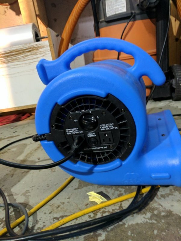

I have this little one that I got at the Vegas show. Half the size of a traditional dryer but very powerful for its size. 3 speeds and 2 additional outlets for daisy chaining. I am going to pick up 2 or 3 more. Won't blow the pictures off the wall. I think it's made by omni. They advertise here. Stackable on its side.
