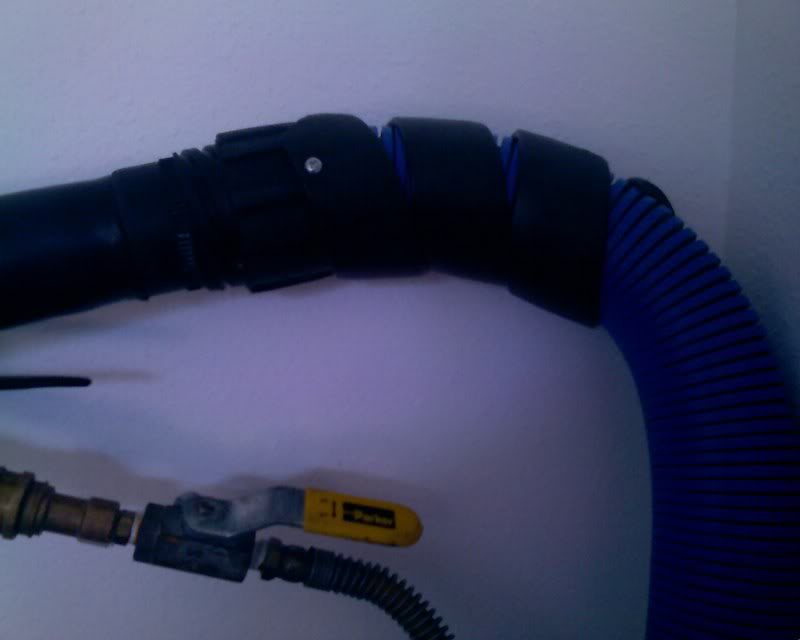

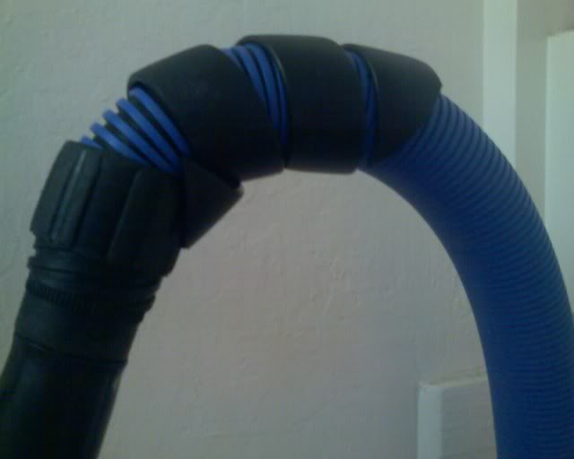

Us high heaters have to deal with our hoses folding/collapsing about once a week.
Especially when using your wand on staircases.
Not any more.
Ask your local hose shop for some in 2". It's used to bale other hoses together. Sorry but I dont recall the name of it.
yes , that's a genuine Cool Cuff. Love it, hate Joe!

That's a very good idea, kinda like the steel braid on the the KMA hose from greenie.

why don't you just buy quality hose instead of the light wt cheap crap?

"quality" hose can be viewed in many ways, from Meat's comments i see he is referring to a stiffer hose, most stiff hose is what these guys with 2" wands are trying to get away from.
Stiff hose might fly in Apartments, but in furnished homes it's the number one reason guys don't like to use a 2" wand.
Enter the eternal quest for the high heat, durable, yet still flexible hose.
Either way, those hose bend restrictors are still cool!

Welp, Greenie.
I've used both the cheap stuff and the quality stuff.
and I can knock over Mrs Phiff's lamp with either the cheap crap or quality hose
The only virtue I see for the cheap junk, is weight reduction.
It's the longer wand that's the PITA in tight spaces in res.
Not super supple hose flexibility.

Cool we need some of that! Love Greenies blue flex hose but it can collapse from our heat.
Our waste water is hotter than what most of you guy's clean with!
