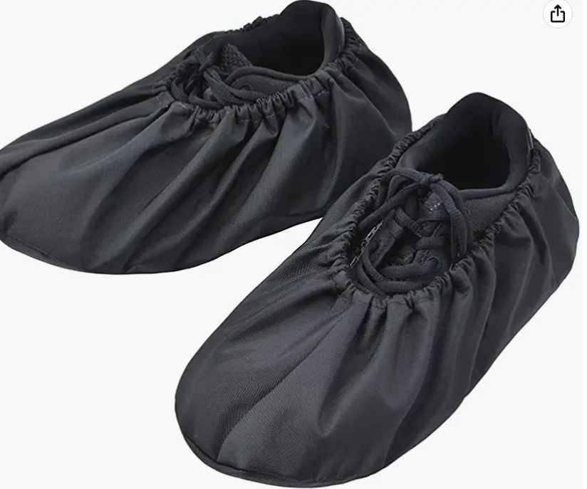

That happened to me before with some tennis shoes. Went to shoe coverings which solved the problem. Also good for giving estimates. They have a tread on the bottom and last forever.
