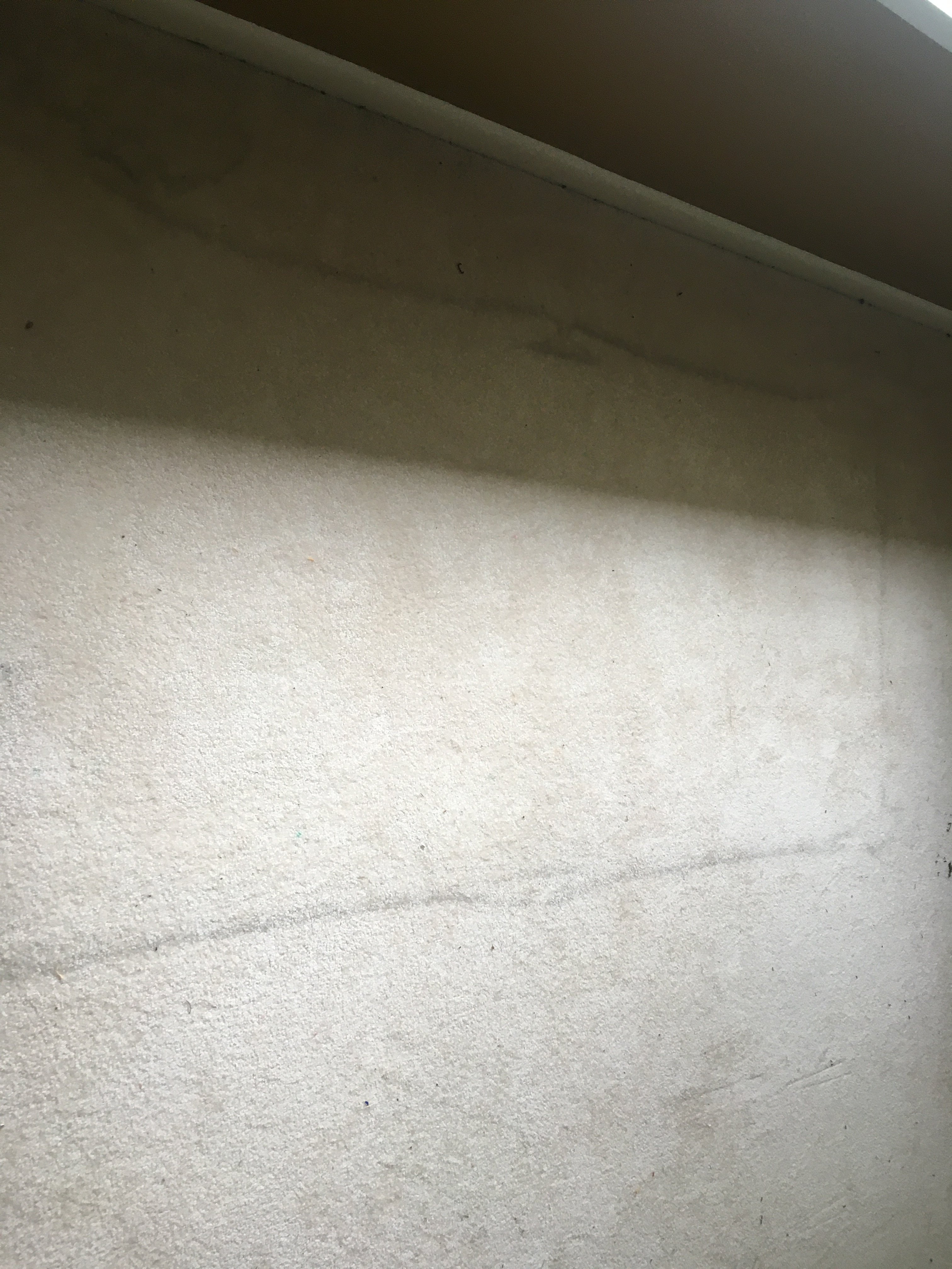

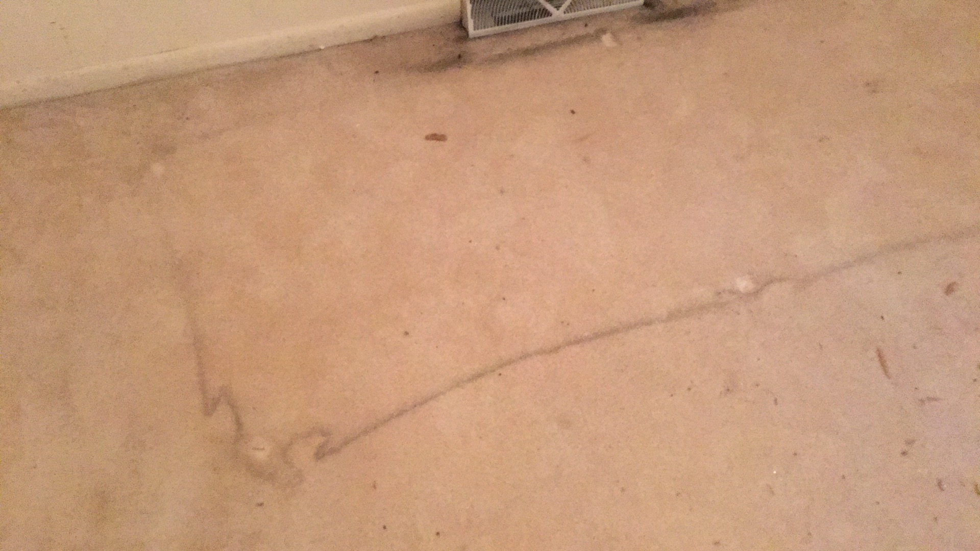

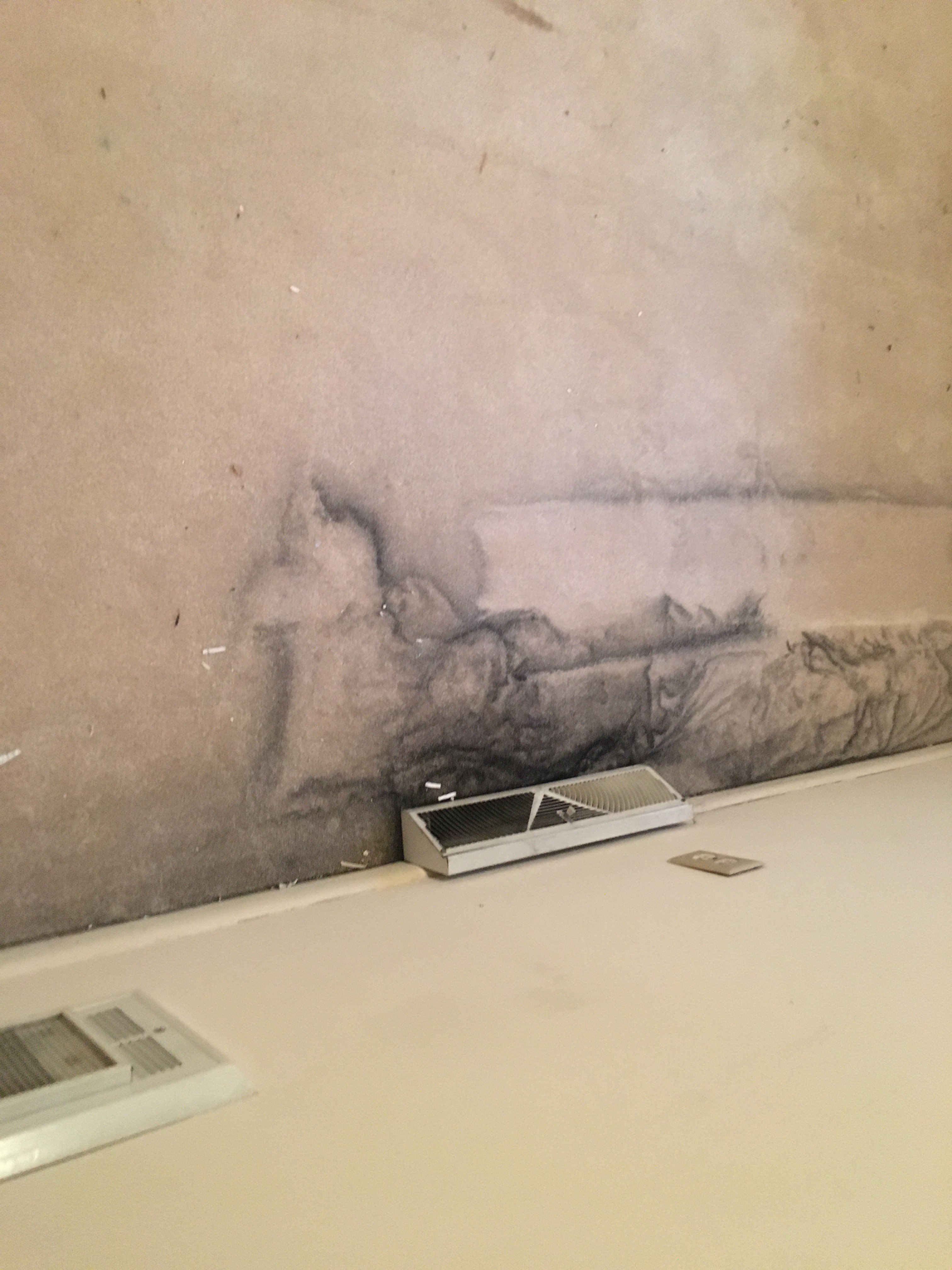

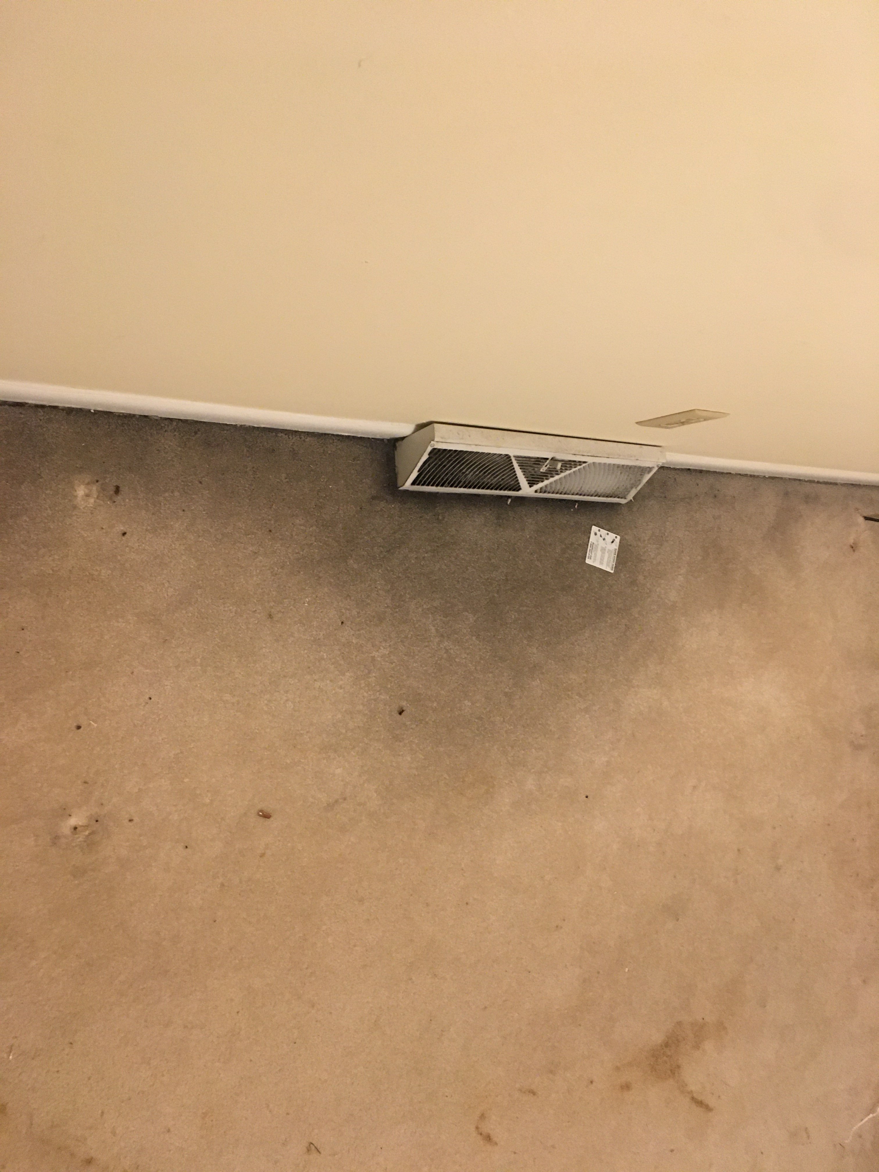

Worst air filtration I’ve seen yet
What should I attack it with?
982697C0-1AEB-43D2-A610-559AA3C3DA26.jpeg 88B1E206-2781-46F0-B593-CBF3BF49C755.jpeg E57F34C4-3EC0-41AB-925C-1AF0FCE42633.jpeg D012DB08-E307-428A-B0CD-869332A24412.jpeg
I've never used Ultrapac Renovate
ultrapac-renovate-p36.aspx
Anyone on here ever used this on my type of situation?
The renovate is a powerful solution and should help. It needs to be scrubbed in and in this case, rinsed with an alkaline rinse like dry slurry. You can always bring the ph down later with some browning treatment if that's a concern.

I have no problem with filtration soil using Bio-8, as long as I use a filtration tool.
Are you sure those aren't guidelines of where to park your trailer?
Dude, I parked crooked as hell yesterday just for you guys at another complex. It tells the idiot tenants to stay the hell away from my setup

I've had good results with Prochem Filter Out, but on that one, I would be sure and let them know to not expect a miracle. I screwed myself this summer by not letting the customer know that it ain't all coming out. It wasn't quite as bad as that one, but it was close.

A new utility Blade in your knife.
Cut into 2 ft wide strips so it's easier to roll up and carry outside.
Seriously I would boost whatever spray you use with citrus and scrub.
Give below the knee expectations

That tool you're describing as the unique and amazing capability of over cleaning a carpet to the point that it looks like it pulls the color out
Yeah, if this job gets approved, I think I'll use my prochem upholstery tool 500psi on a spot first.
And if no help, I'll just use my wand
