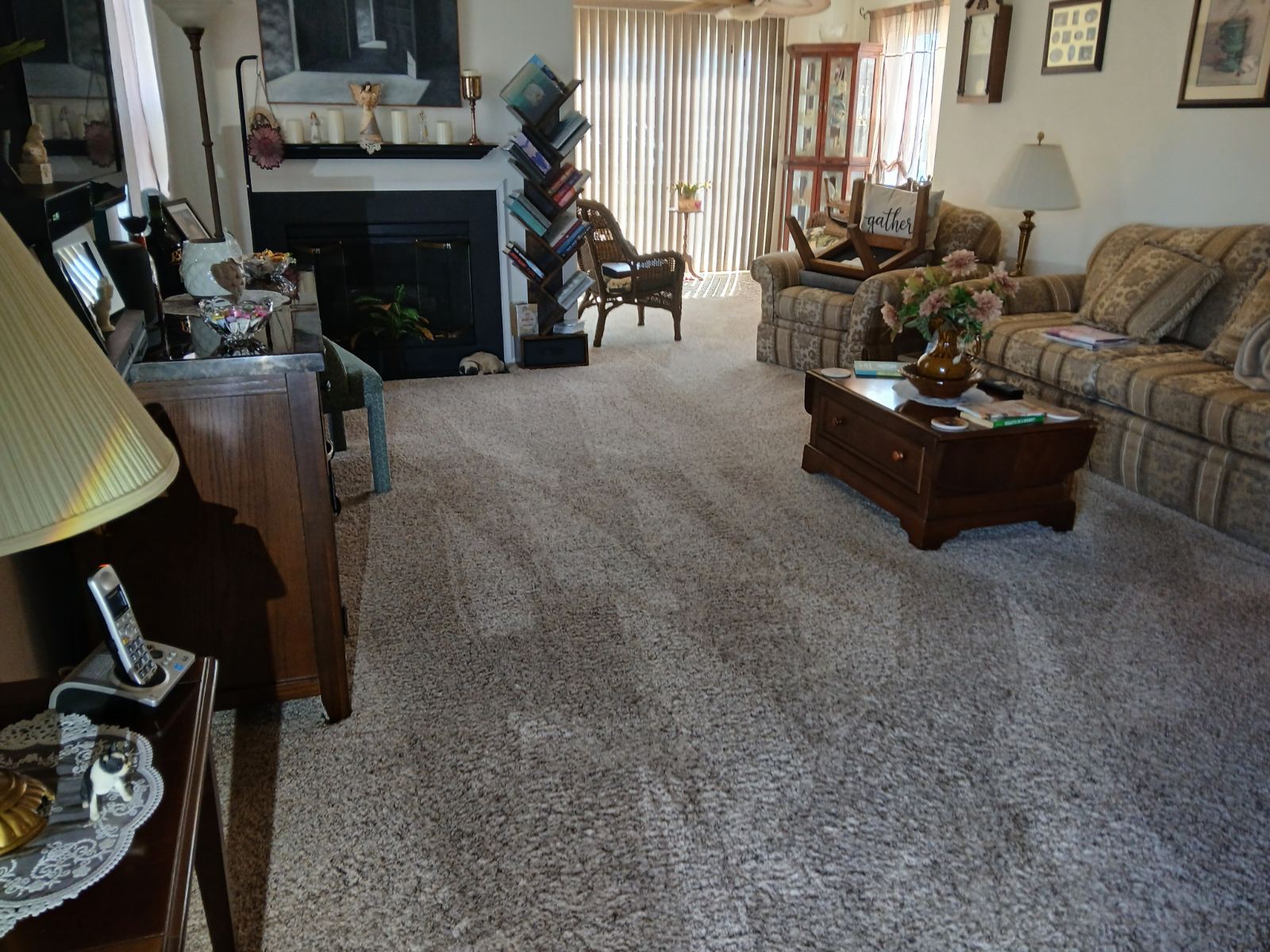

Frank the problem with Carpet Details is it's a powder
And yes I know Carpet Details does mix rather easily
When I don't know what I'm going to use for a job it's a pain mixing it up at the job
And if I run out on the job then I got to mix it up and it's wasting time
Much easier just using a liquid like VacAway Encap Green 7.5 PH for the nice easy jobs that's similar to Carpet Details
When I know I'm going to use Carpet Details I mix it up at home and take it to the job saving me time
Liquids are just easier to work with
I used VacAway Encap Green with Deotnator (Peroxide) on that job
