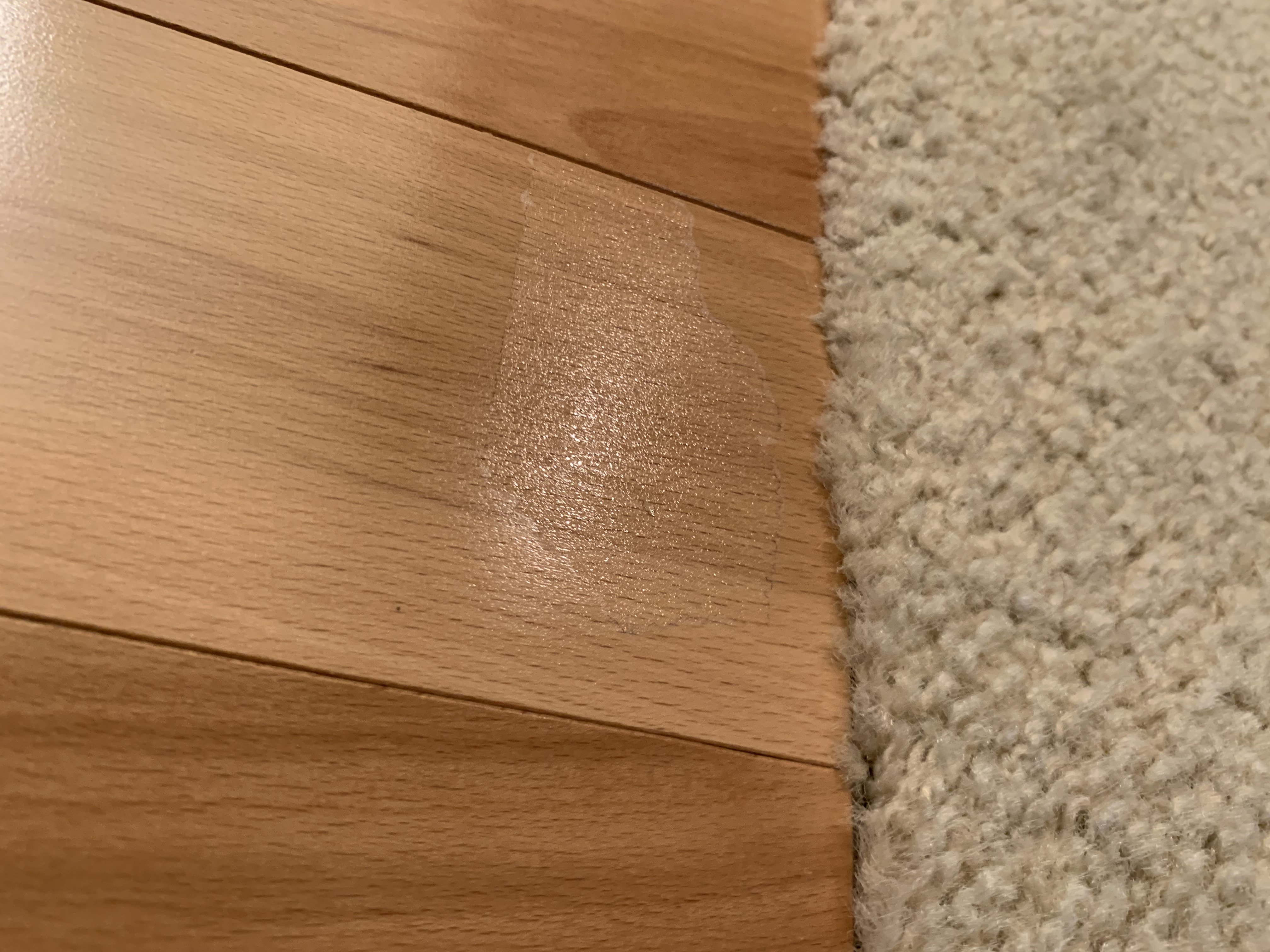

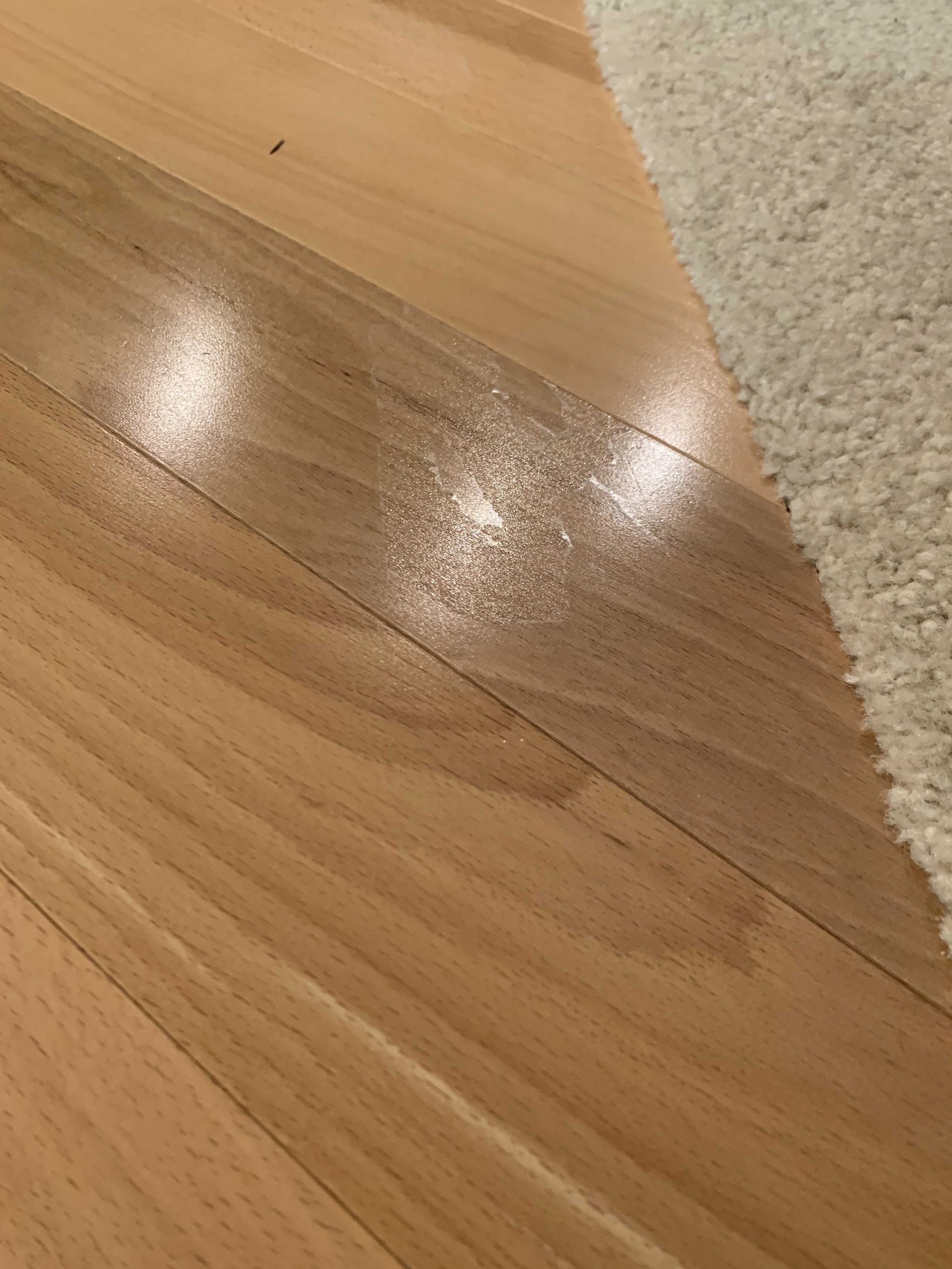

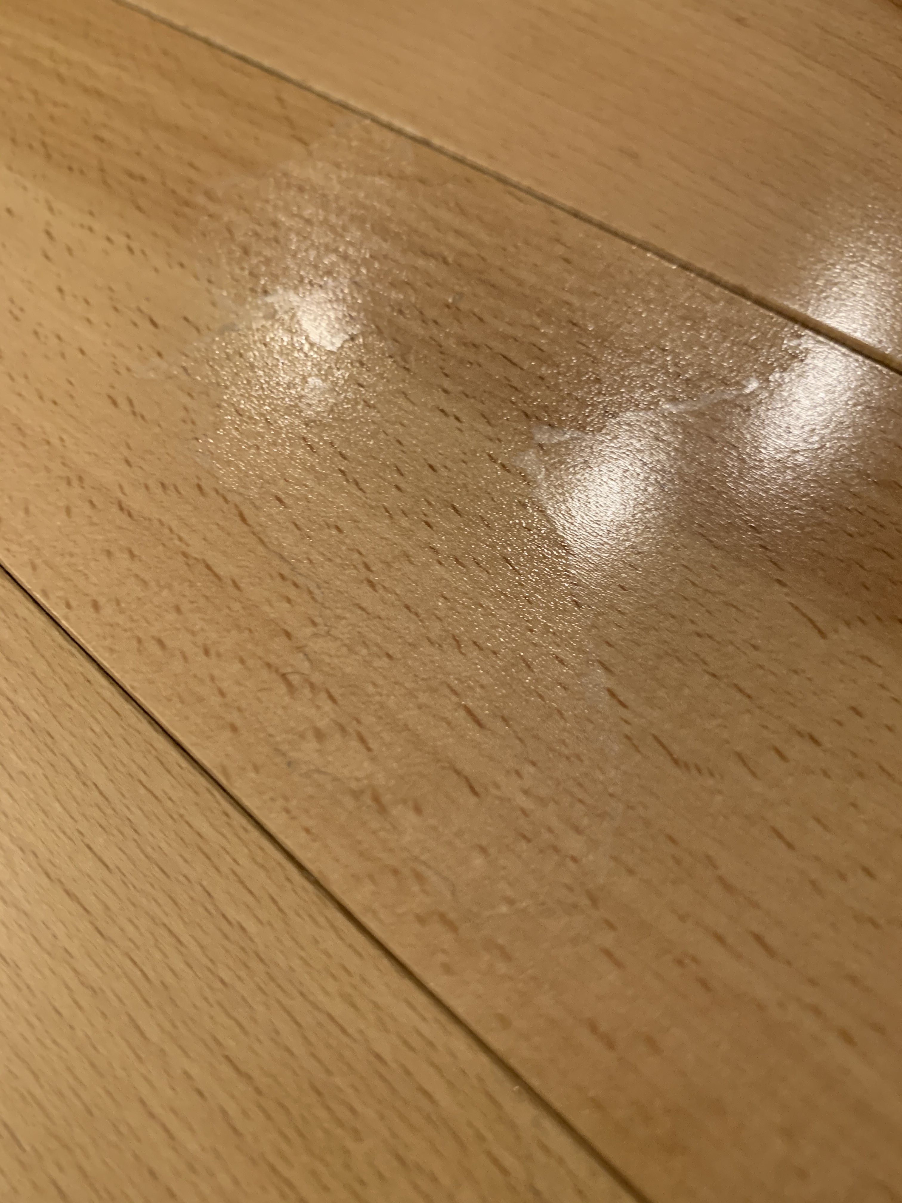

heres pictures. Talked to lady and she knows the seller so she called him and he has not done anything to the floors since the house was new.
Anyway to explain why I use the tape is
1. protects the finish from overspray (which can be done with other things politely suggested above
2. More importantly, carpet is a soft surface and soil first starts to build up where? Going from hard surface floors to carpet! So where is carpet show the heaviest soiling? In track off areas (I learned that in an IICRC class) So when I run the Brush Pro I can safely clean right up to the edge (evven over the edge as its protected by the tape) without worrying about the brushes putting prespray onto the hardwood finish! This is something a tarp cannot do as it would get caught in the CRB.
after further research, I should be using Scotch DELICATE SURFACE tape not the regular Blue.
The area affected has a rough feel to it. Not sure a microfiber would fix it.
28,282
In the first pic, it looks like the floor was wet. I see the tape outline but the wood is darker near the carpet. Although your theory sounds good, you may be getting too aggressive because you think you protected the floor. I don't think the tape is waterproof. Leaving wet tape on the floor until you finish the job might not be a good idea. Using a glided wand, I just vacuum up any overspray as it happens. I haven't had any issues yet.
looks like tape residue to me
by chance, did any solution migrate under the tape?
L.T.A.
Reactions: steve_64
last pic looks like the finish was actually pulled off
