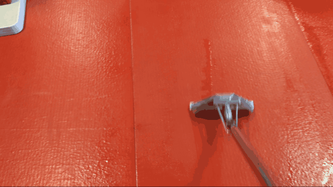

The wings are too high off the ground for one but the bigger issue is the spray hits too far back from the vacuum slot, allowing water to travel to the sides too much imo..
I feel that if I have to tell cleaners that they're either going to need to buy a sheer kit of sorts or do anything mechanical other than sticking the glide on, it'll kill sales..
Thoughts'?

Simply sell the BG WITH a shear kit (jet extenders), and obviously charge for it…
Or, simply put a note with the BG to change to a narrower spray pattern….
Or, just recommend to turn down PSI….
No problems, just solutions…
If you need a beta, send me one at a discount!
50,039
Unless you’re somehow spinning the wand and creating centrifugal force, the water isn’t“traveling” to the sides. It’s called overspray and there’s likely nothing you can do about it. Moron

That is with 95° vs the stock 110°
117,332
I can reduce the back side of the glides so that the vacuum is closer to the jet spray which would help with pickup. But I still need to create some sort of shear angle

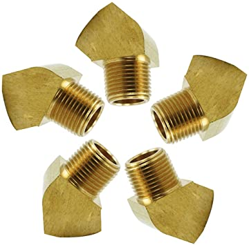

Yes, but you can also get a 22.5 degree elbow…
I couldn't find any
