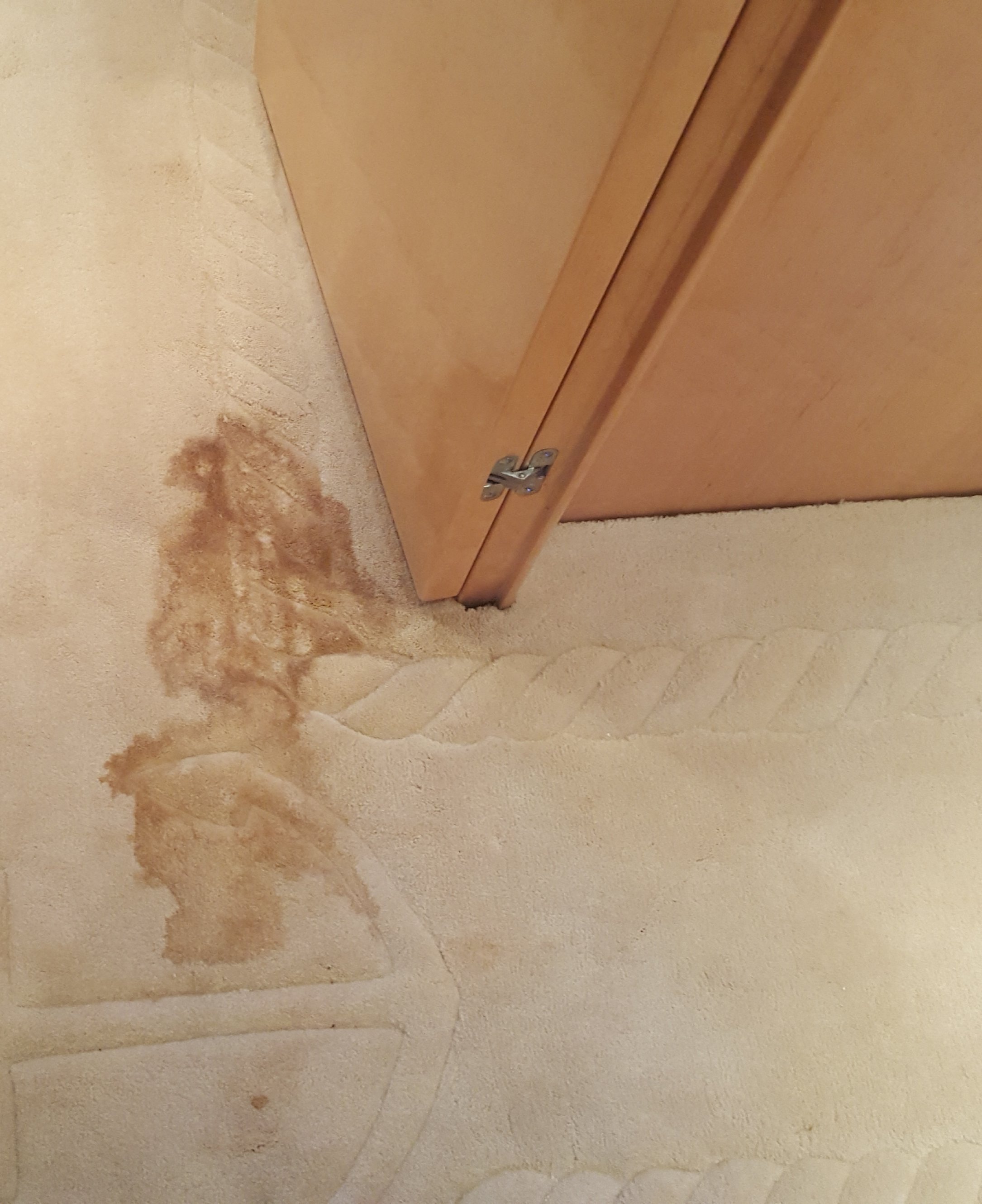

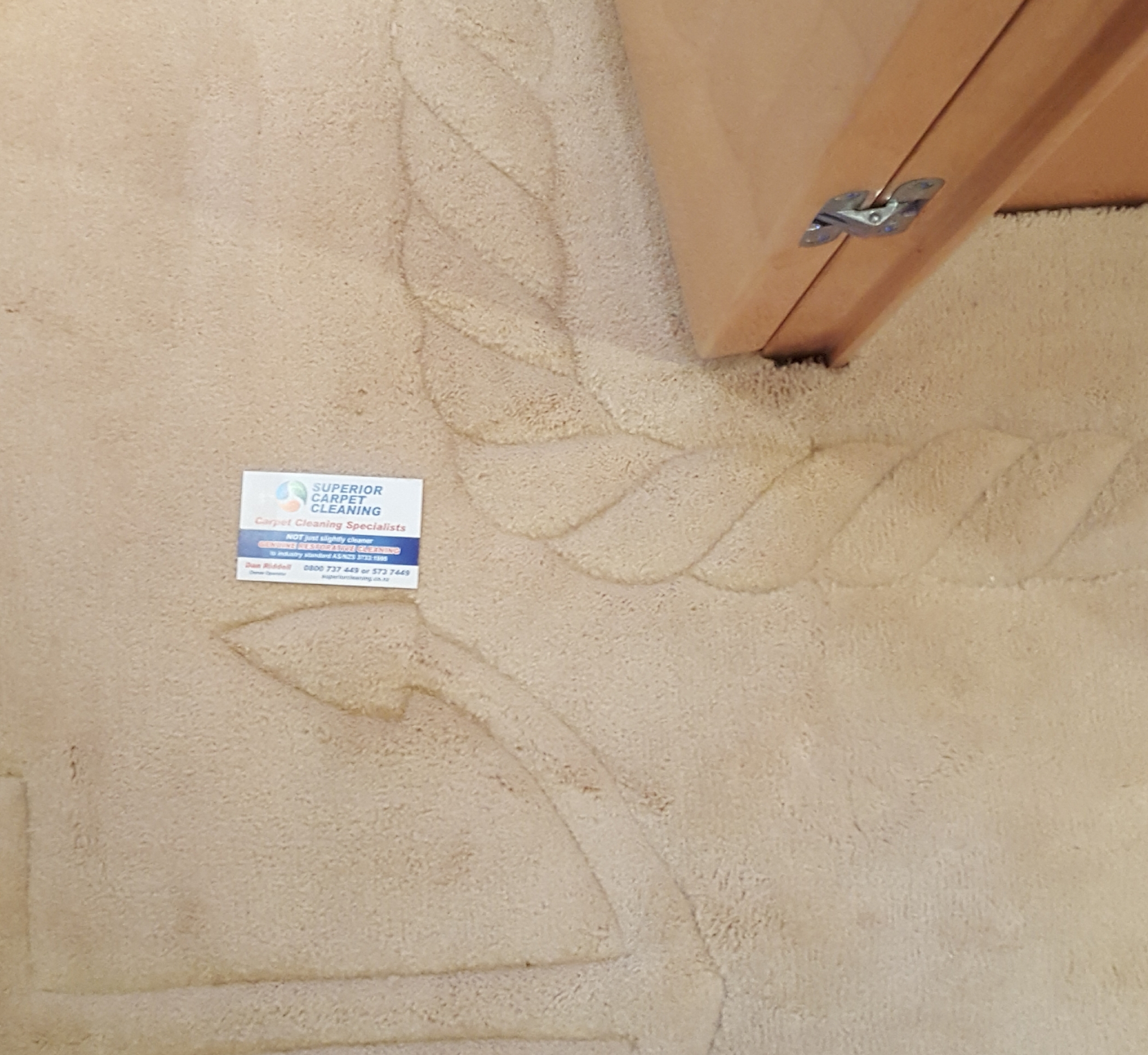

custom wool carpet on a gin palace launch with black coffee..
didnt use a reducer on this one, 6% hp rinse and remist while went did the upholstery
bout an hour or so later
What the heck is a Gin Palace launch? Judging from the door hinges in the picture, I'm guessing it's some kind of boat? Also the anchor in the carpet may be a clue. Now i'm off to Google Gin Palace Launch.
Edit: Google only confused me more.
