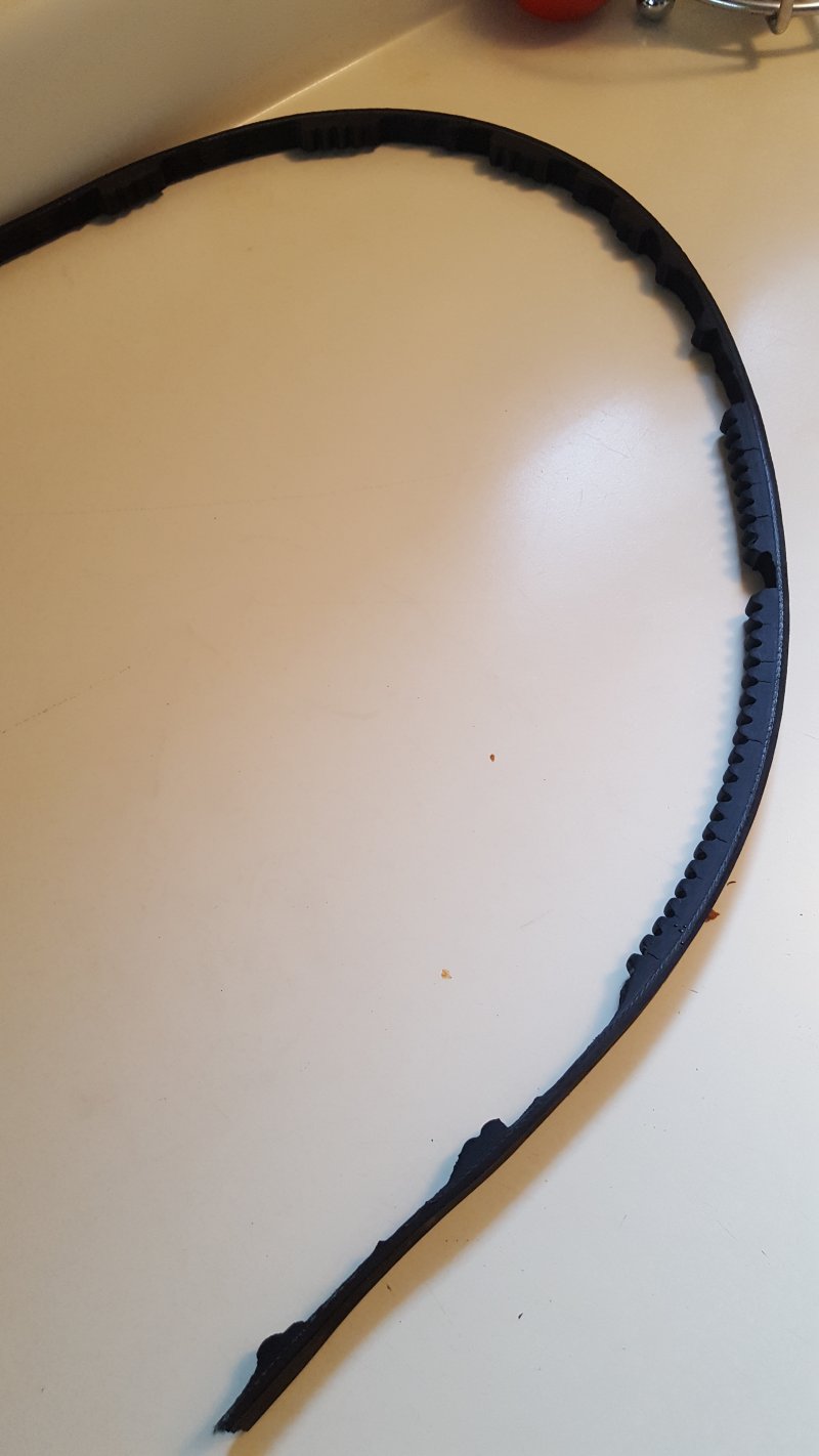

Had one of the two blower belts fail on the tm(370). Knew I was screwed when I saw a chunk of the rubber gears on my dash yesterday, just flew out.
Needed to use the tm today, seemed to work fine(didn't blow up). No new belts til tomorrow, apparently.
So, am I screwing things up more running the blower with only one belt? Hoping to get through two more jobs, til I can tackle this.
How hard is it to change belts? According to the directions, slide the blower back, tilt the front down and install? lol, if only it were that easy...:oldrolleyes:

The problem is if that belt is so bad, you know the other one is too. Probably gonna break halfway through your next job

The right belts, aligned correctly, last for years. Usually one bad belt will take out the otber.

I've got 5 years on the belts on my AT PTO. I am changing them out next week however. As long as the tension is just barely tight enough to not slip they will last for years.
But once 1 goes they all go, don't limp around just change it. I always have a spare set and can change them on the job in 15 minutes.
you won't hurt anything if that's what you're asking
turn the vac relief down (less HG) so there's not as much load on the blower
That might get you thru the day
how hard?
never looked inside a 370
no clue if a tight space knucklebuster or not
If you have more than a screw driver, hammer and vise grips for tools, it's not beyond an average jamoke
And you know not to replace just one belt, right?
always replace both as a set

You might make it through the day but now that one belt will be slipping even more and will deteriorate even quicker.
