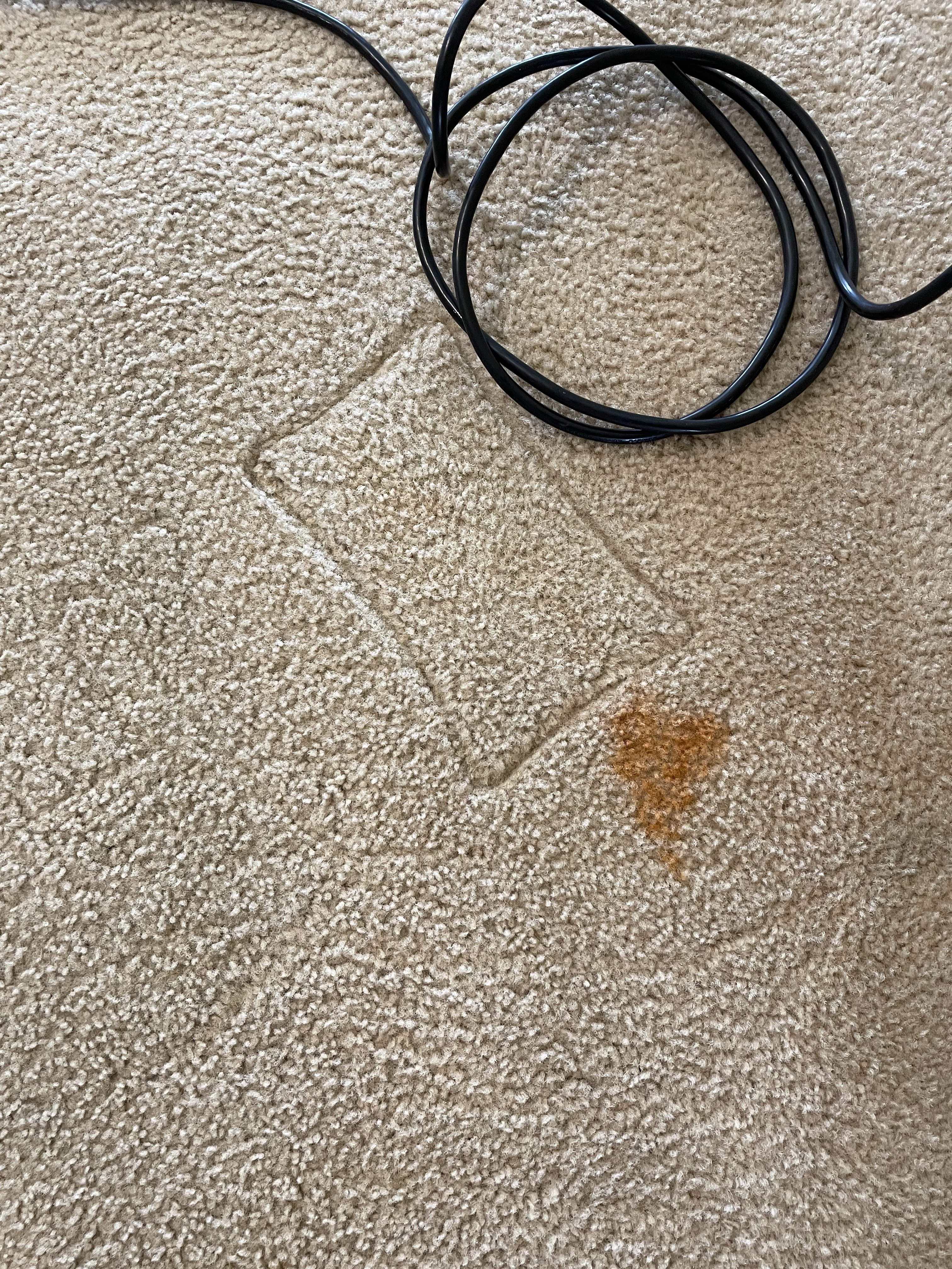

House smells like cat pee. It also has these orange spots all over every room. The rectangle is where I steamed one of the stains out using a dye stain remover.
I know the cat didn’t pee orange pee, right?
So what explains this color … assuming it’s pee?

It’s all over the place. Not just where furniture would normally be. Plus, I don’t think I've ever had success using dye stain remover on furniture stains.

Indication of internal problems .
Kidneys,heavy protein diet,as well as meds.
As mentioned by Jim.
Great job in square area.
12,851
looks like the cat got into the AZO............if there is a cat
If that is AZO in the urine (human or cat), that's a very difficult dye stain to remove. Getting that stain out without damaging the carpet's own dye is a pretty narrow line to walk.

I spent about 2 to 2.5 hours working on getting every single stain out. I took a break and went to lunch. When I came back into the house the smell of steamed urine mixed with dye stain remover just about was more than I could bear!

If the stains hadn’t been orange, I would have just used his PSor. After removing the stains, I sprayed PSor for the odor and the RE’d it. Everything cleaned up great. I’ll go back tomorrow to check on the smell.
14,637
I also come across several of these dark urine stains that the homeowner tells me their pet had a UTI
