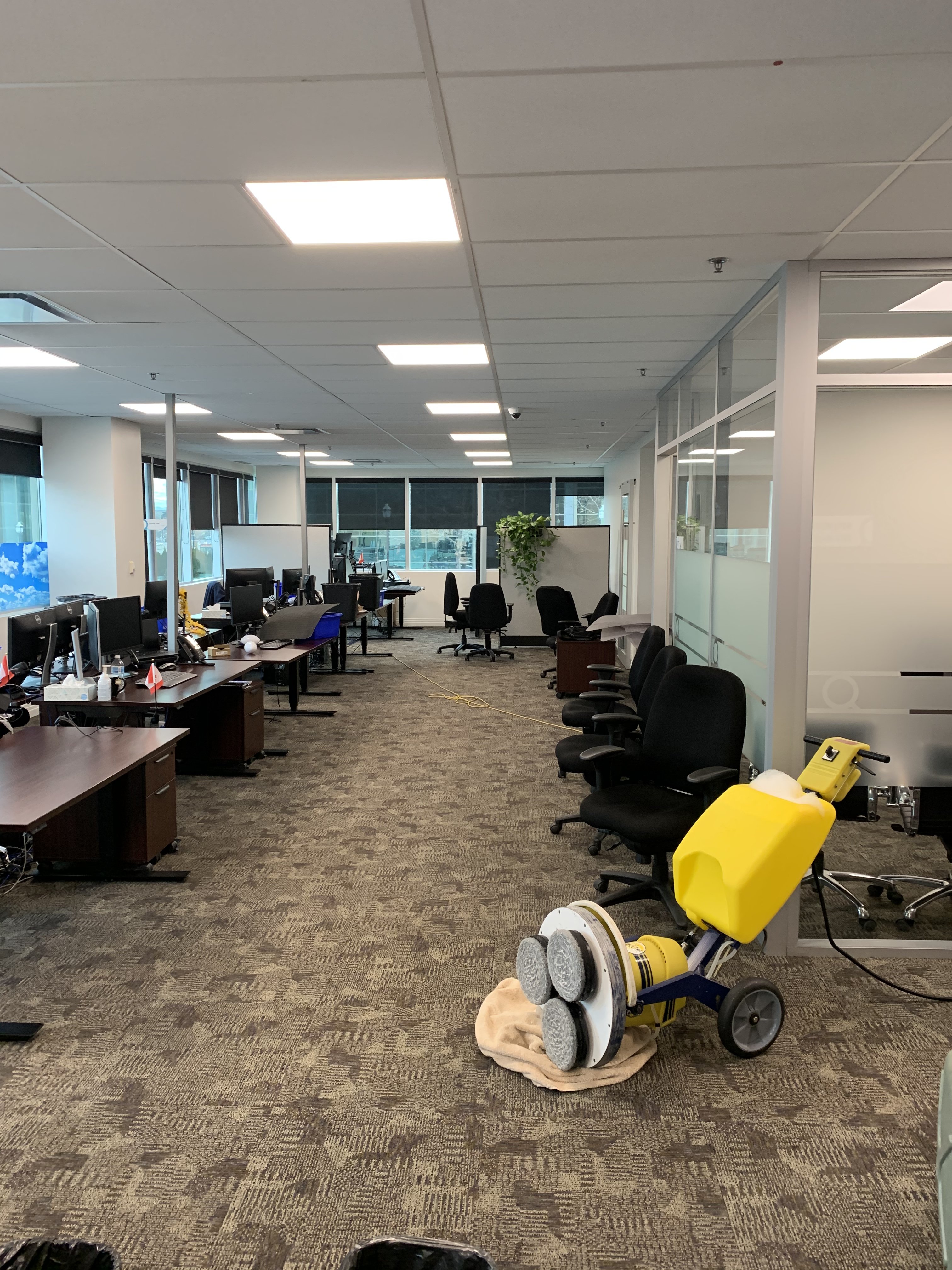

cleaned two today
28,277
Res rec room first stop
#2 was 1500 sf of carpet in an empty.
had a capable helper, carpets in good shape, made a little beer money

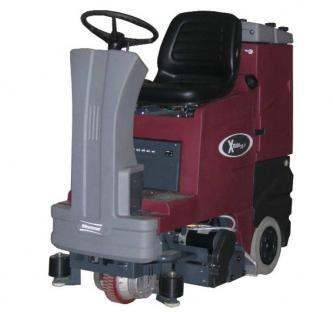

When it's all commercial carpet, doesn't make much sense using a porty rather than a Cimex or op machine. Once you have the dry soil off, it doesn't take much to clean what's left. You can add deodorizers if you want, pretreat stains just like you would with hwe. Drys quick without wicking usually. Don't let them make the choice. You're the professional, sell them the right method.

Its Its very doubtful that it is cleaned with the same type of portable as you would use.
They are going to use walk behinds and clean 3-5 thousand feet an hour. It won't be nearly as clean as if you did it but when price is the priority and outweighs thorough cleaning, you get what you get.

We however, are formulating a plan to clean the common spaces in all 7 buildings....
why does it feel like we are becoming more janitorial than carpet cleaning company?
When we VLM’ed yesterday, we filled 4 VAC BAGS! Tell me that in house janitorial is not just using a flat floor tool, but also NOT cleaning under desks...
I guess that’s why they get us to ‘deep clean’ using VLM....
^^^(that should trigger Larry)^^^^
They aren't catching any detail work. All center of the room/traffic area cleaning.
