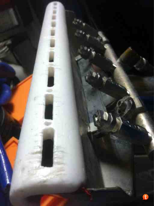

I gotta do everyrhing?
This thing was all hole and it irritated me so much I kept kicking it off an throwin it back it the truck. So i sent it off to be hacked on. Much Much Better.
I could use a 12" scratch one now : )
