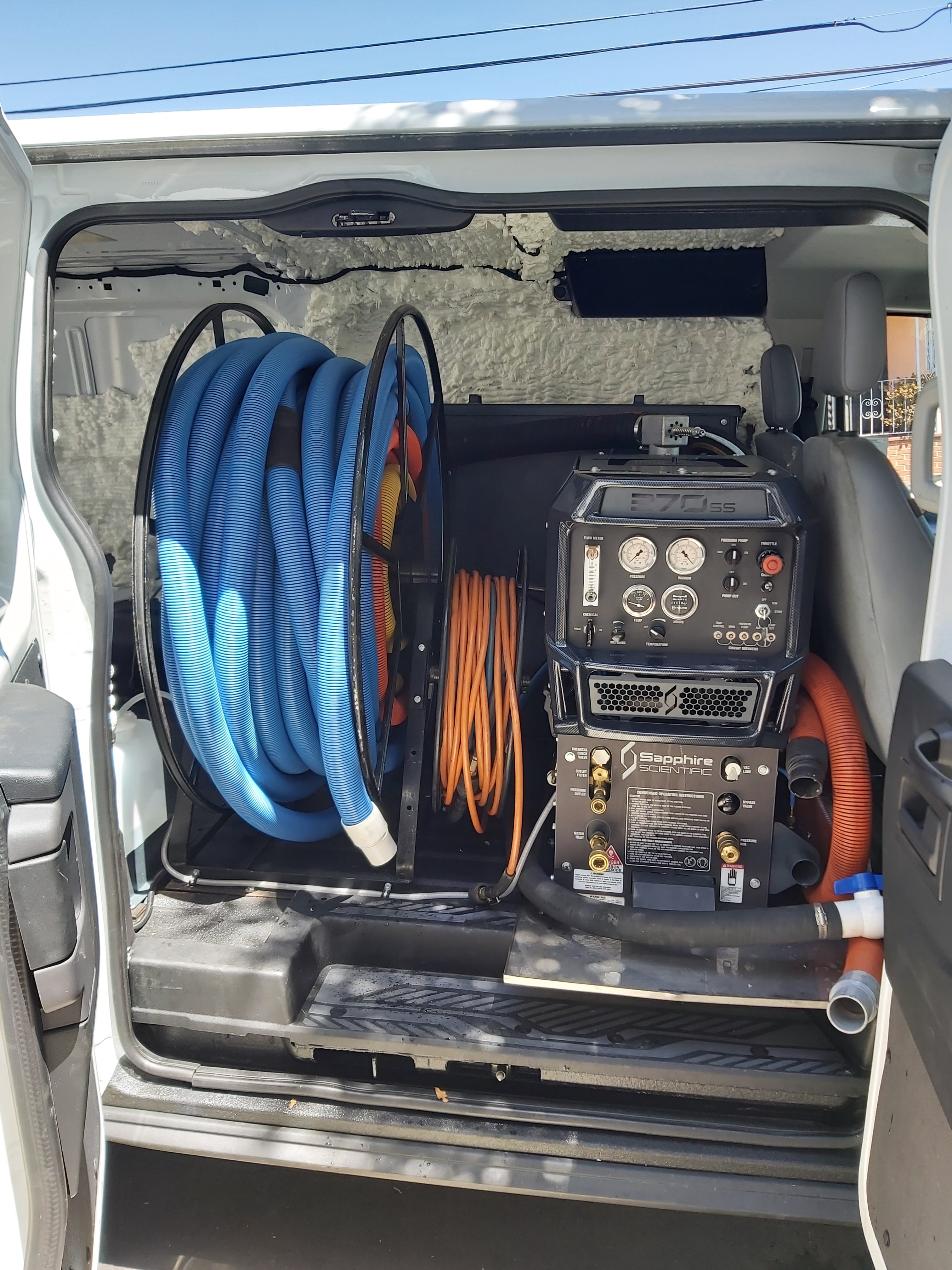

I Hope I love mine as much as Mikey loves his.
Went from the Biggest TM's to this reasonable TM.
Im no longer doing big commercial jobs, dual wanding, nor long hose runs. Usually under 120' hose runs.
Maybe my shoulder will last longer.

I think it's a very practical truck mount. Really has everything you need for single wand operation.
I went from a Vortex to a 650 a year ago and still miss the power and reliability of the Vortex. I hope you’ll continue to post your thoughts on the 370. I like the way you’ve set up the machine and reels all from the side door. Maintenance on the 370 looks challenging with the tight fit between the seat and hose reel.
Removing the solution reel is easy, vac reel doable. the seat moves out of the way. and I'm a small guy.
I'll be moving the oil drain hose to the front of the machine with a shut of valve.
The hot water dumping valves will be rerouted to the freshwater tank.
I still have another van/tm on standby as a back-up.
