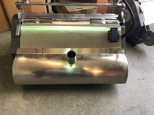

Hey Mike- We have a catch tray with a vac nozzle on it available that would be a good thing to use on this rug. Basically you wear a backpack vac and hook up to the rear catch tray and power the vac off the back of the machine. At that point you are pulling negative air through the machine as well as using the brushing action to remove solids from the rug. This will perform better than any civilian beater bar vacuum or pile lifter known to exist. It would be a great last step once all the compound has dried and you want to get any remaining particles.
btw- You will need one 20lb pail per 1500 sf of carpet to be cleaned, assuming avg soiling. How many sf did you say existed?

1700 or so
yeah that port catcher would be great.
Could we hook the truckmount up to the port instead of a backback?
regarossa
Sure - it's not a 2" though- you will need a whip line for it.
