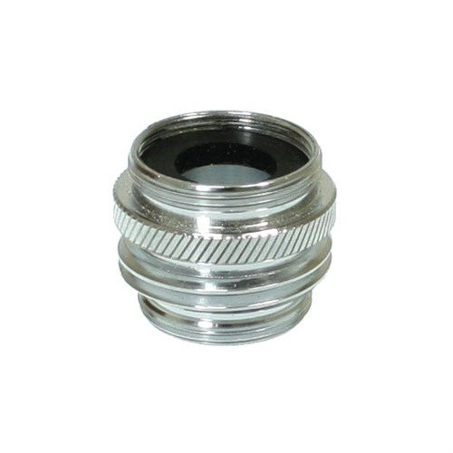

many outside hose bibs will be turned off from inside
get a garden hose faucet adapter
this one
has inside and outside threads and will fit 99.288% of res faucets and 92.773% of com
