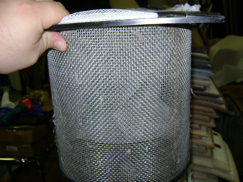

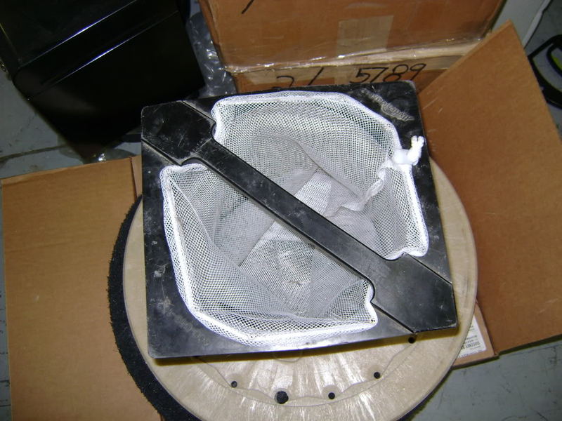

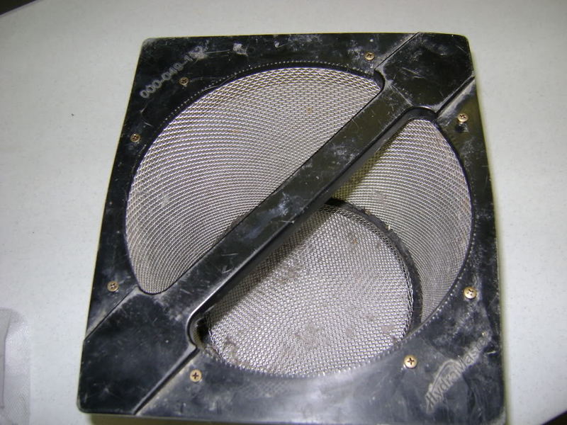

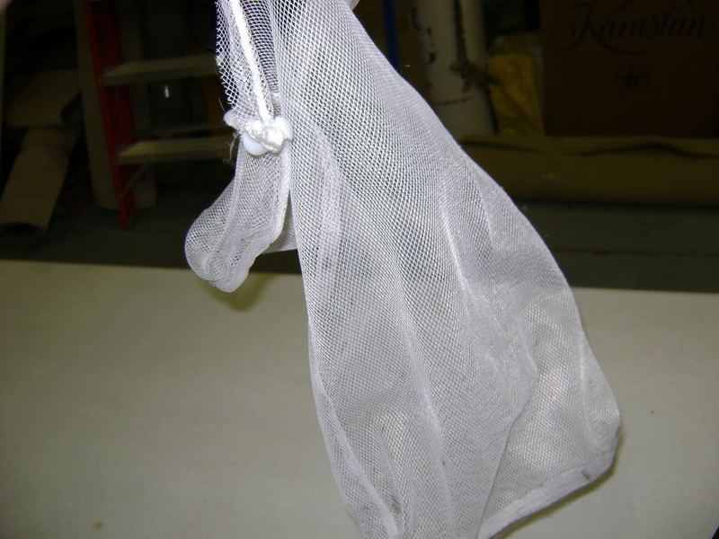

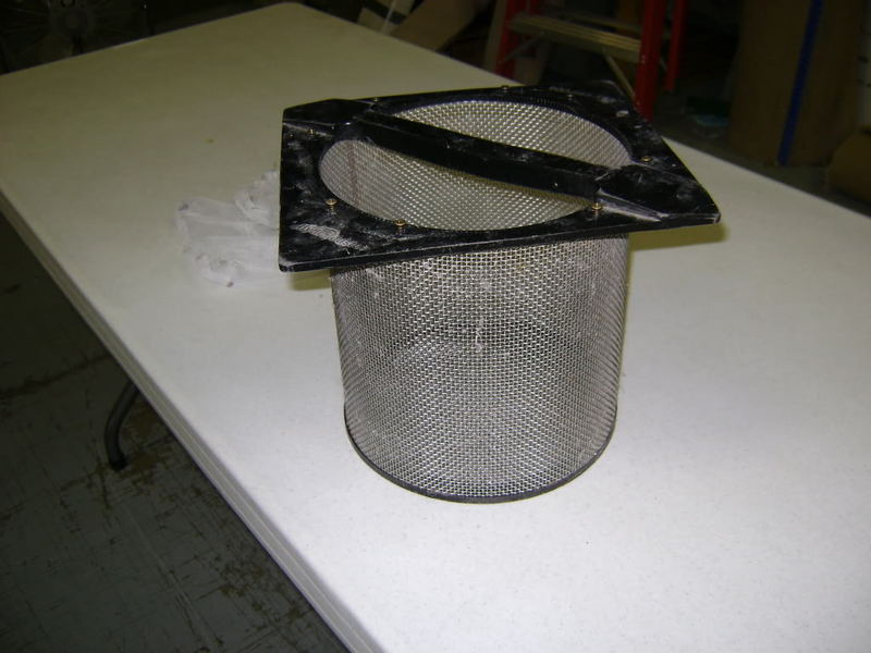

If you own a Newer Hydramaster CDS unit, you know how annoying the steel mesh filter basket can be. Here is a way to add a mesh bag to make clean out a lot less of a hassle.
Materials: Screw driver or drill driver
8 5/8 screws
10"x18" mesh bags.
Drive screws into top of filter basket until just the tip of the screw is barely poking through
The filter when then stretch around the screws on the basket
And Here you go:
Finished filter that is much easier to clean out!

Quite the opposite, all the lint pulled right out of the bag, vs scrubbing with a steel bristle brush to get the lint to detangle from the stainless steel mesh. Used it several times already and it's saved me probably about 1.5 hours in clean out times over 3-4 clean outs.

quick connect on my line!? :lol: I've used our 2000 psi power washer with a 0 tip and it still leaves crap between the mesh filter. The mesh bag is what I added. I can take it out and clean it out in a tenth the time it takes to clean off stainless mesh filter. And If I don't feel like messing with it, I throw it out and put a new one in.. total cost $0.50. :roll:
