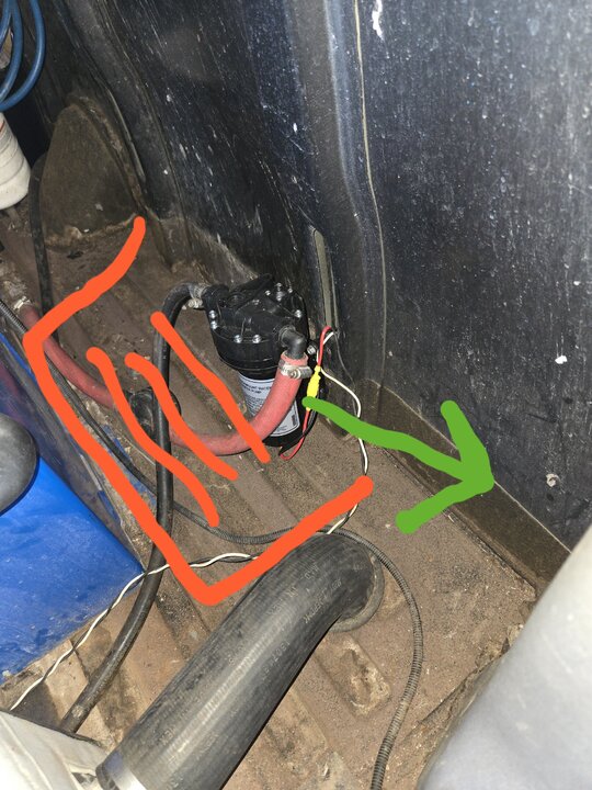

BUT! What if I slap that thing on the floor behind my waste tank? I'd only have to relocate the transfer pump closer to the drivers seat on the other side of the blower exhaust. Seems like this may work really easily. Then I'd have a massive volume of hot water and no need to deal with Pete. What do you think?

Thanks Dwain, but before we go that route... what do you think about me using the Blue Baron heat exchanger in the location I posted pictures of?

I was talking about the heat exchanger from Blue Baron. Maybe you didn't see it posted earlier but I am wondering if I should just go ahead and mount the Blue Baron heat exchanger in the location I described behind my waste tank, I posted pictures of it. Seems like it will be super easy to drop it in and run lines to it. Hadn't thought of it before this morning...

Well I think it fits. And I can plumb coolant lines to and from it easily. How does this look bud? I relocated the transfer pump and it works fine in its new location. I only rested the new HX in place for a pic as I still need to get fittings and insulation and mount it on a board so I can easily bolt it to the floor on the front side.

I have no opinion, i can't tell if it's good or bad. I have no horse in that race.by the picture It appears that it is setting on the floor behind the passenger seat. If so be sure the seat fits and works to your satisfaction. As far as a Y vs T for ableeder Y would be nice but if not available tee works fine . Keep in mind the coolant is going to go straight thru . The higher side is to bleed air and providing that whichever is lower than the top of the radiator itll fill all the way up whichever you use. It would matter more if you were trying to feed multiple heat exchangers with the same coolant line then a Y would work way way better. Let me know what you do. If im not shipping these ones i have im going to put um back in the storage side of my shop and deal with um in the winter when im looking for something to stay busy

It's behind the driver's seat. I had the seat out to move things and take a pic. Thank you Dwain. You've got a big heart thanks so much for offering to loan me the tube style HX. I am going to go for it with this one from Pete. In principle it seems like it will work fine. I'll install a bleeder valve on the high end and see if I can order a good Y fitting. I'll let you know how it turns out! 😁

Put the seat back on and make sure everything fits and works before mounting. Nothing worse than finding out too late you cant adjust your seat

Good call. I just did a bit ago and it all works well.
