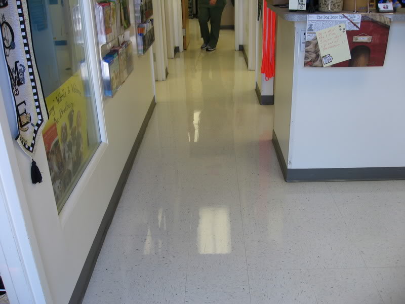

Greenie, magic starts to happen at about 1500 rpm and the right pad on the right finish. Marty could do quite well with a UHS electric machine. As for the $75 figure.. That does not apply to Marty's church, but rather to those little jobs. I can pull in the parking lot, buff, load up, and pull out of the parking lot with $75 in my pocket in about the time it takes to set up the tm, unload, pre-spray, and load up (putting aside the time and effort to actually clean the carpet.)
You are right about buying the right "wax" and not stripping to often. This floor in the picture had not been stripped in about 3 years at the time it was taken..
I'll get a new picture this week. It has been 4 or 5 years now since the same floor was stripped. I need to check the records.
