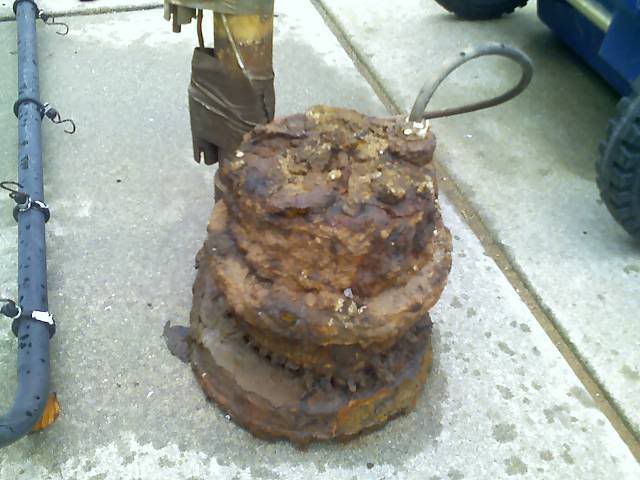

Can you believe this sump pump just died yesterday?
The owners never checked it in the ten years. That is all hard corrosion, not mud
We pulled 280 gallons from beneath a 260 sq ft room. A gravel concrete combo. Made no sense what so ever how the sub floor was put together but it was 4 feet below grade.

Damn, they may deny that claim for maintenance.
