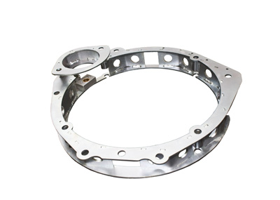

So my vwtm is all torn down getting it powder coated, should be done Wednesday, I will take pics of it when I get it back.
Nate I just came across this tonight, I have been wanting to find a better way to mount the front of the motor, I used a cut off bell housing and it is bullet proof but on my next one I wanted to go off the flywheel end of the motor and the bell won't work.
The guy just emailed me back and confirmed it is more than strong enough for permanent mount. He has a guy that uses them in vw helicopters.
The company name is http://www.zalexindustries.com/index.html
What this does is allows you to mount the starter.

Sweet find... Thanks for the heads up!! I'm still sourcing parts...
