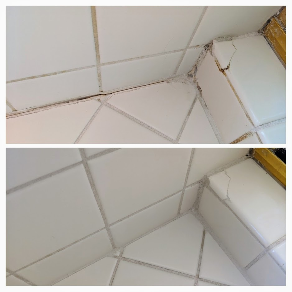

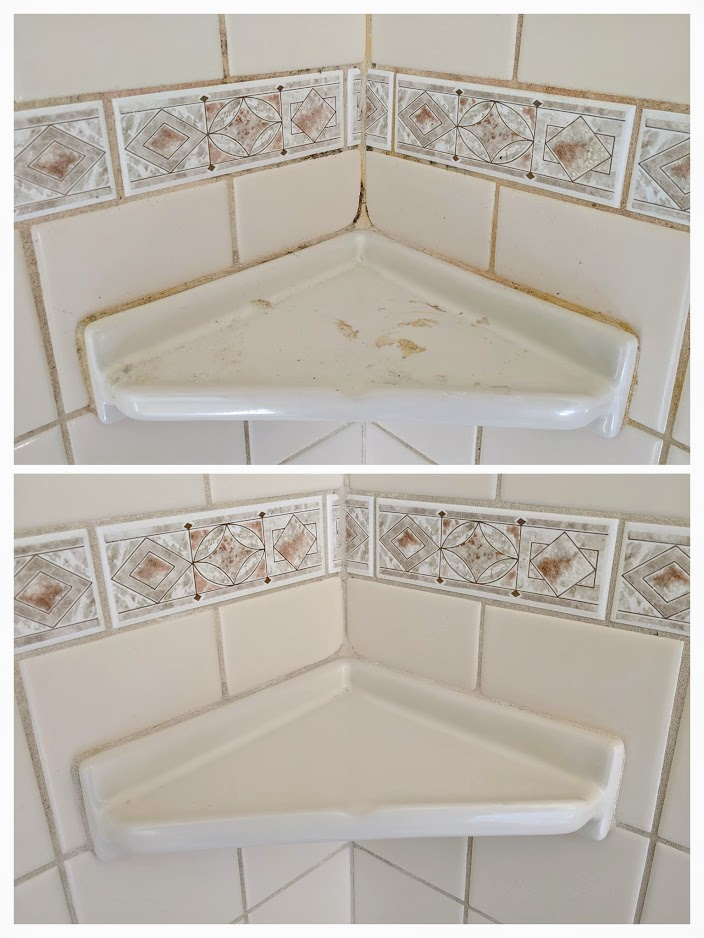

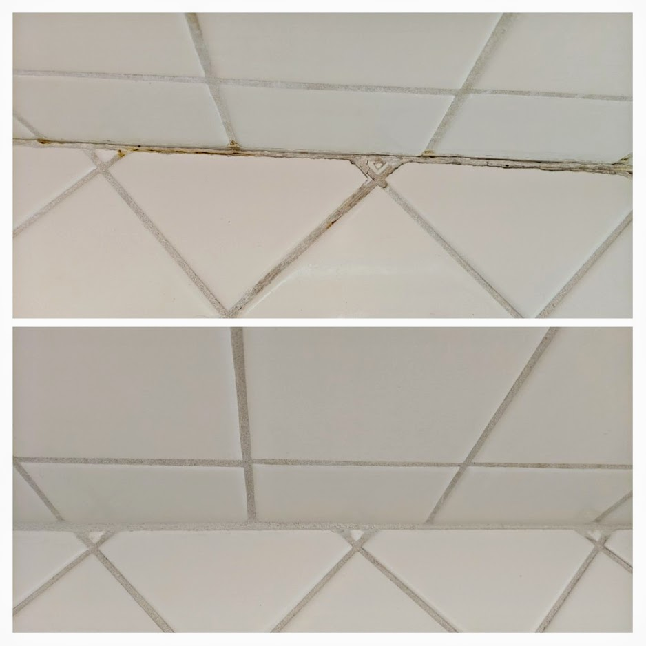

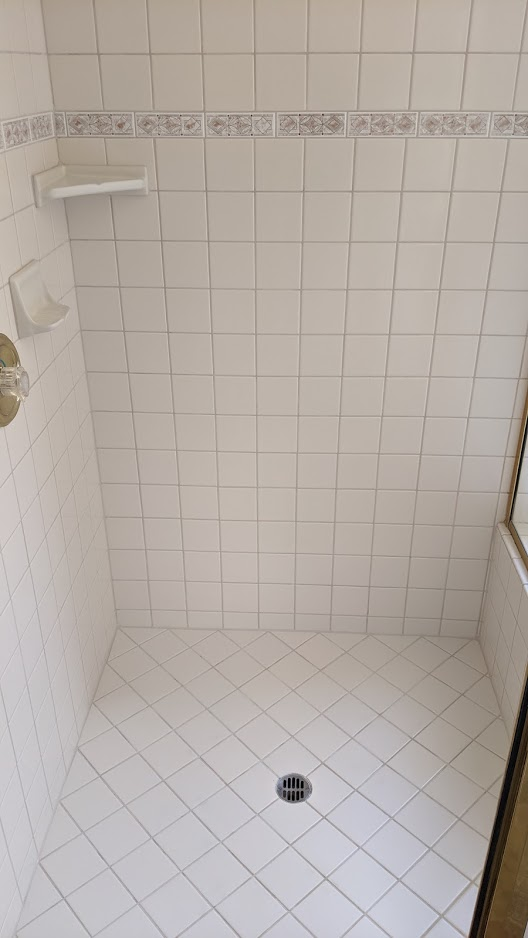

This 22 year old shower had failed grout on every floor to wall joint as well as the two wall to wall joints.
Yellow/Orange and black mold was prolific through out.
There was a ton of efflorescence build up on 70 of the grout on the floor and loads of crust on the floor tiles as well and I wish like F I had taken more photos...
5 hours for $950 which here in Retirementville is amazing for tile work.
and yes, that one grout line in the corner didn't show up in person and is now driving me nuts.

looks good, ahh but i see clear silicone mildew from the inside on aluminum frame to tile interface
117,383
you dont have to remove the frame to remove the silicone....
of course not but the mold is under the framework and if I put silicone back which it needs it's just going to come back almost immediately and there for so will I...
I tell them all if they want the mold underneath the clear silicone around frames they're going to have to remove the frame and clean underneath I've removed enough frames and cleaned underneath them to see the massive amount of mold and spuge that collects under those
