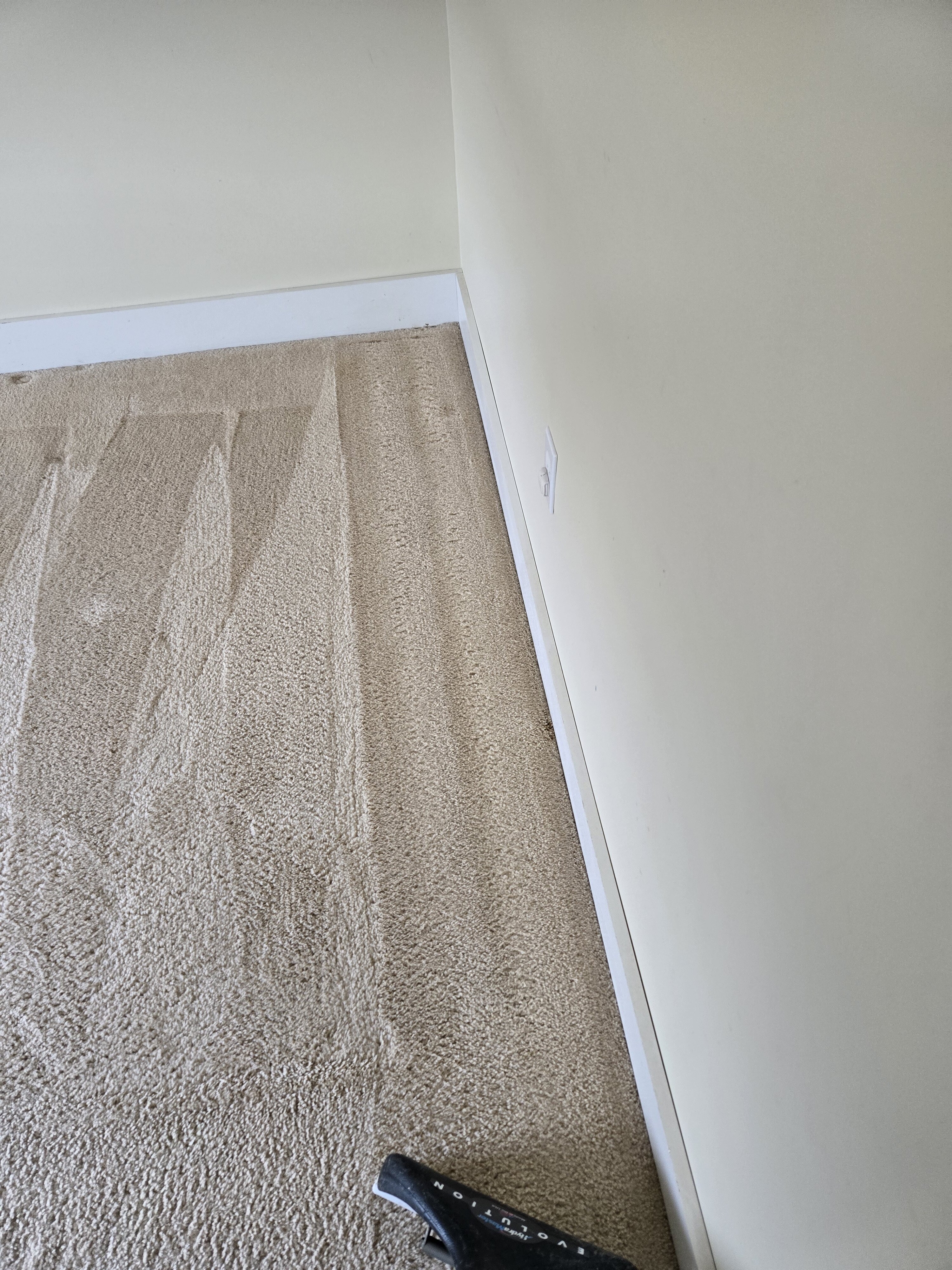

What's up with my streaks y'all? I turned my pressure down to 400. I tried offsetting my jets one way, then the other, no luck. Then made sure the jets were lined up perfect, no luck. I ended up just doing a third offset pass after my normal 2 passes on each stretch to eliminate it by streaking the unstreaked portion. There must be a better way...

Does the evolution have a center pin in the vacuum slot?
I had the same problem with a mach12 wand. Couldn’t fix the problem so I just got rid of it

The extra inch of coverage on my Evo 13" saves me a few thousand passes a year.
Um..
Check your math.
How much time are you wasting by not using a S bend that gets under furniture, how much time are you causing your customers to wait for the carpet to dry by using the Evo's poorly desgined vacuum manifold?
If you want to work quicker, there are much better wider wands.
Yes it does.

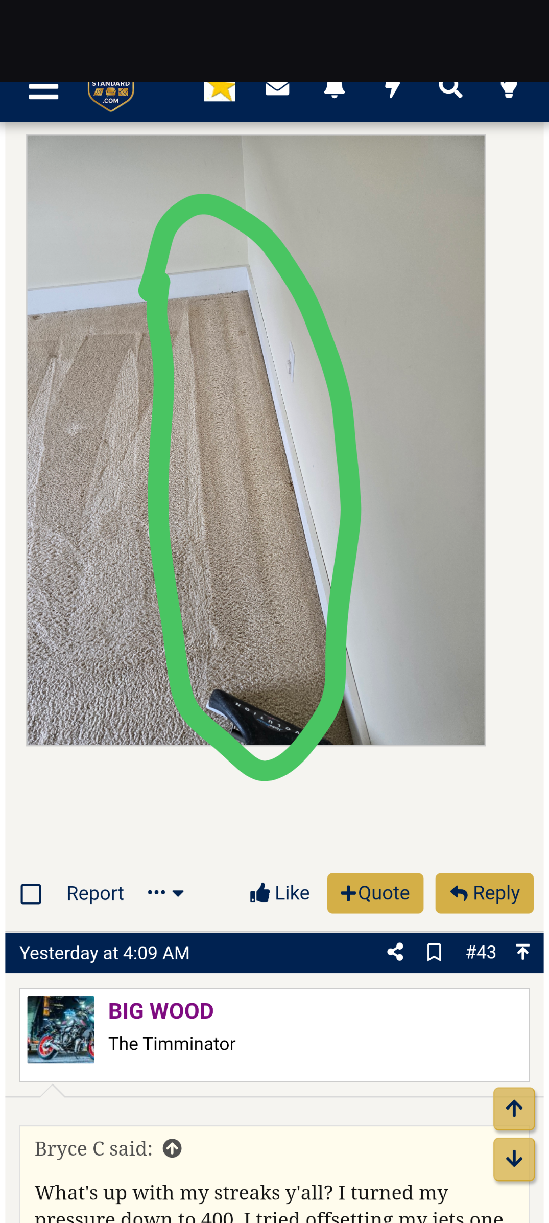

The line in this photo, is that what you're talking about in regards to streaking ?
that's pile distortion.
The spray bar on your wand could be improperly adjusted and your brass jets are likely worn out
Put some brand new steel Jets on it and adjust the spray bar/ manifold so that the Jets are striking right behind the Glide, even if its touching the Glide by 10% that's okay

By the way had to use chosen to use the Chosen wand on that particular carpet, we wouldn't be having this conversation right now due to their 45° angle and steel jets that are still probably in fine shape
Mike I confess, I just use your Chosen Wand as a backup now. The extra inch of coverage on my Evo 13" saves me a few thousand passes a year.
Bryce, was this happening every stroke or just along the wall as pictured?
Every stroke. I adjusted my pressure down to 400 psi, tried offsetting my jets, and none of it worked until I just did extra passes to streak the unstreaked areas.
