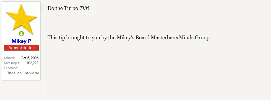

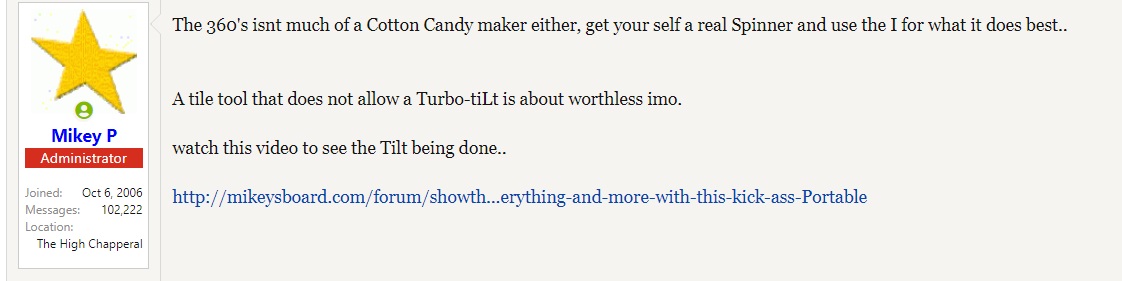

Im not bagging on spinner tools here, I'm bagging on the "Mark Markovitz" generation of lazy cleaners who wont use TACT to clean floors. The guys who always treat floors as if they were in a chinese restaurant with pH15 "2790 Oxy Master Blaster" and 1500-2500 psi, all so that they can avoid the Time and Agitation element to the professional process...
If thats you and my comments offend you, tough shit, you deserve to be throat punched, ESPECIALLY you assholes that Turbo Tilt.
Markovitz, the guy who claims to have invented the first turbo, has been promoting this bullshit for twenty years.

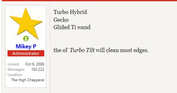

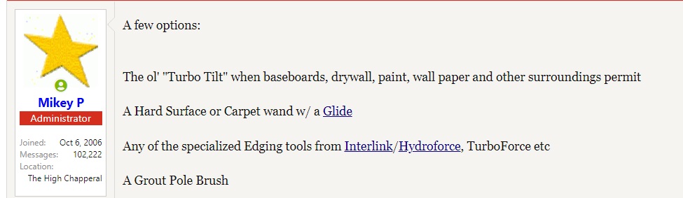

Quit cracking people's grout joints with high heat, quit turbo tilting and swelling their baseboards, regardless of them being cheap junk. It's not our place to **** up people's homes because we're too lazy to scrub and use a proper tool to do the edging.
