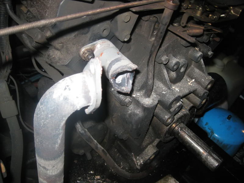

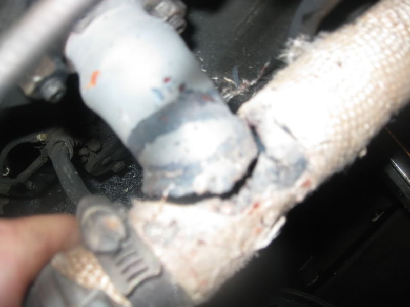

:x I replaced my exhaust about 8-10 months ago, and I'm about to do it again.. :?
It broke right at the weld.. I think my tm is getting too hot? Anyone have this problem?
Last time I replaced it I had it ceramic coated and I wraped it... no go.
The exhaust makes a mess of everything in my van. :evil:
Why do you guys think this is happening?
Thanks,
Keith

looks to me like it is a bad vibration.........you either don't have it supported correctly...or it is supported and it is to ridged............

I looked at this before Keith took it apart and I don't believe it is running lean, if anything it is rich. The exhaust is quite black and messy as you can see by his pictures. I don't see how it could be a vibration issue. The pipe that goes down into the exchanger box is free floating in a rope type gasket. Looks to me like the weld was bad. Is that possible?

I had a similar problem with an exhaust. The exhaust T'd together and at night the joint would glow bright red. The original broke at the weld and I re-welded it. It broke again and I had a professional re-weld it and he also reinforced it. It still broke so I bought a new exhaust. It also broke in the same place so I had a muffler place make an entirely new one just using the engine mounts and never had another problem. My would only last 6 to 9 months each time. Hope this helps.

I wish I could tell you. It was a long time ago. I took it to a muffler shop and they made a new one. I didn't ask nor tell them anything other then just make me one that won't break at the weld. They did slightly change the design so that it was a sweeping bend instead of a hard T. I agree it's a pain plus very hard on the inside of the van. Take it to a shop and tell them the problem. I'm sure that they will have a solution. The shop I used was a small performance shop. Good luck.
