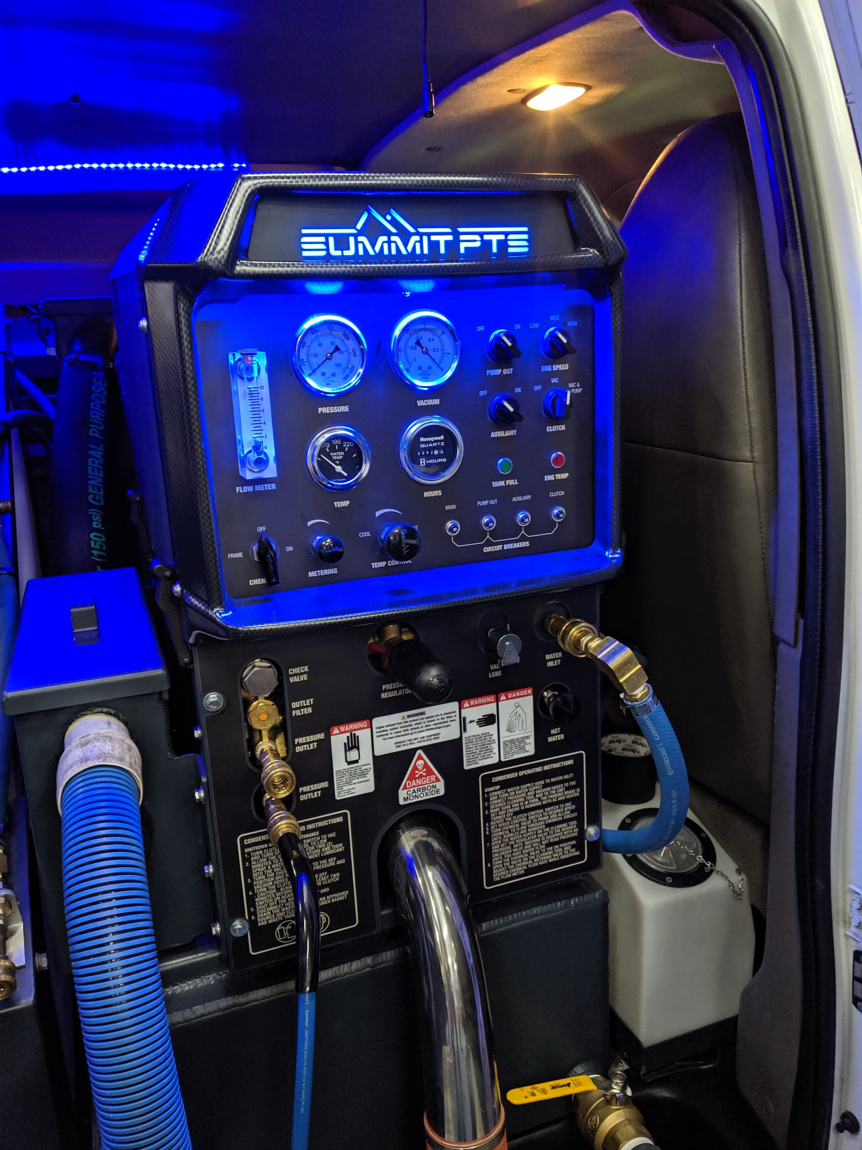

They should put a fresh water tank in place of the recovery tank. If you ever need to clean out the recovery tank now it would be near impossible to do a thorough job. With the stainless steel coolant heat exchangers you better make sure that your softner bottle is well charged or that thing will plug up fast, not a lot of room for ANY buildup between plates.
