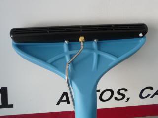

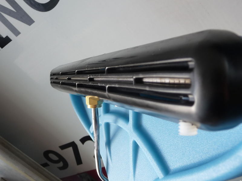

The Glide is flat'ish so there is a limited range of up and down tilt before you can hear the air escaping. Abut 8 inches is my guess. not a problem, just noting. The head is super low so you'll be getting under furniture with easy and if you won't be scratching anything with all plastic construction.

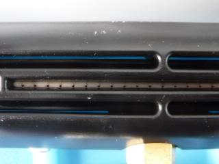

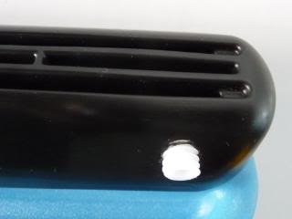

The white allen bolt is loosened to flush out debris from the spray bar and a metal tooth brush or even a pin head (insert chad joke) could be used to unclog as well. I'm guessing you could have 20% of the holes randomly plugged up and it would not effect the cleaning.Now all in line would be a problem.

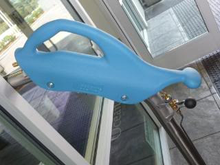

The blue handle does keep your skin away from the hot tube, sweet!

Is the see-thru tube towards the top of the wand near the handle? Would like to see a short video of this new one in action!
L
Lefty724
Ok wow, I thought in the 5th pic down that it was the sight tube! LOL Need to stop drinking so much on the weekends!
