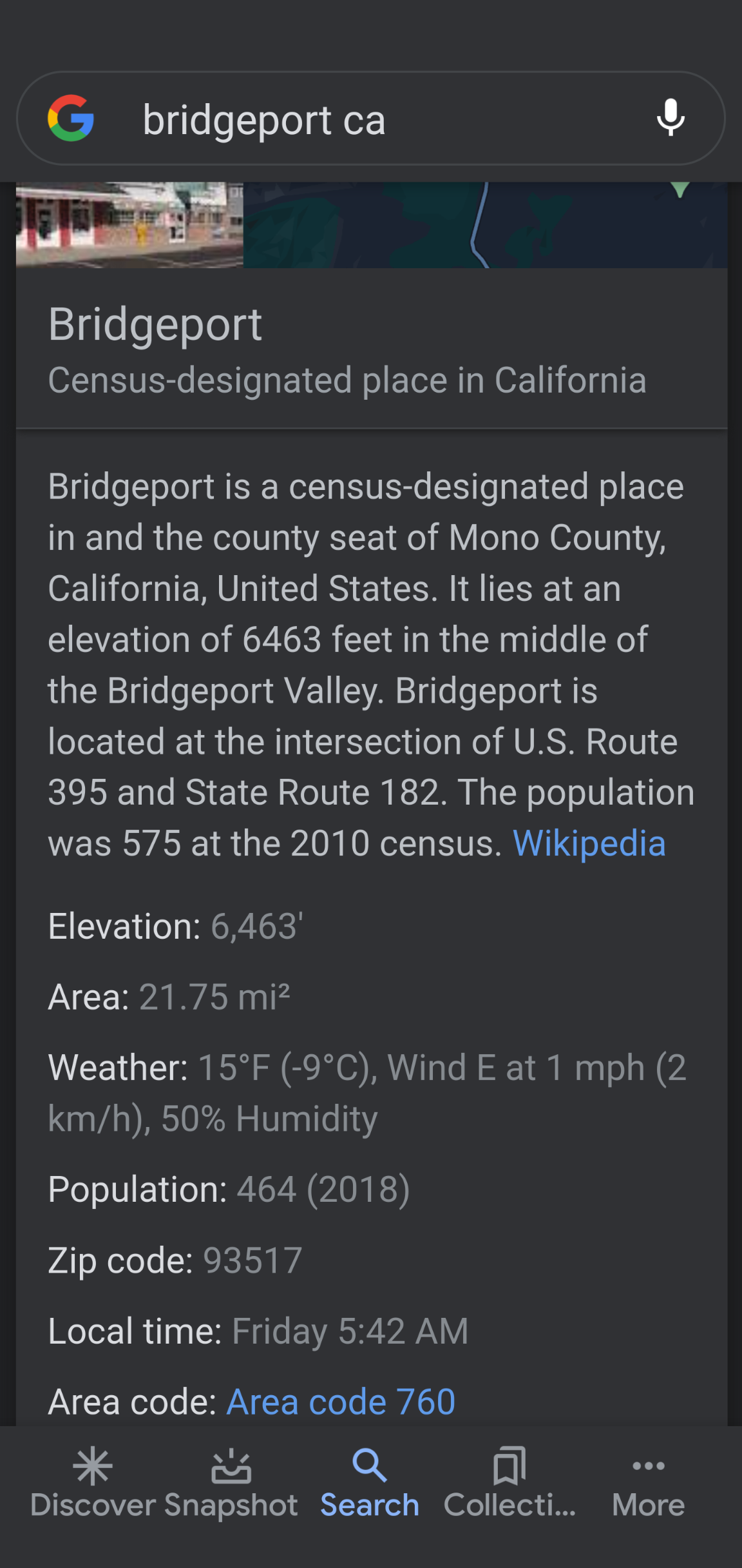

Twin Lakes Resort store in Bridgeport CA
I believe a couple of guest cabins and the owner's home couple years ago.
Covid traffic and profits were so intense this year that they have money to blow on floor cleaning for once...
2500sf
I would hire a local cabin neighbor to help me out but I still think it may take two days so I'll have to come home to keep my van from freezing...
