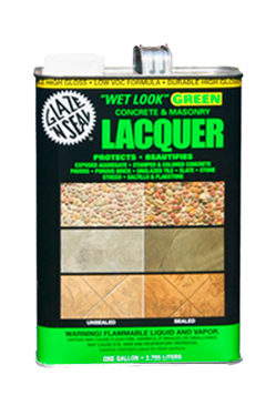

The lacquers I used years ago in my automotive days re-dissolved easily with lacquer thinner. Is there a lacquer-based floor finish? That's a new one on me.
