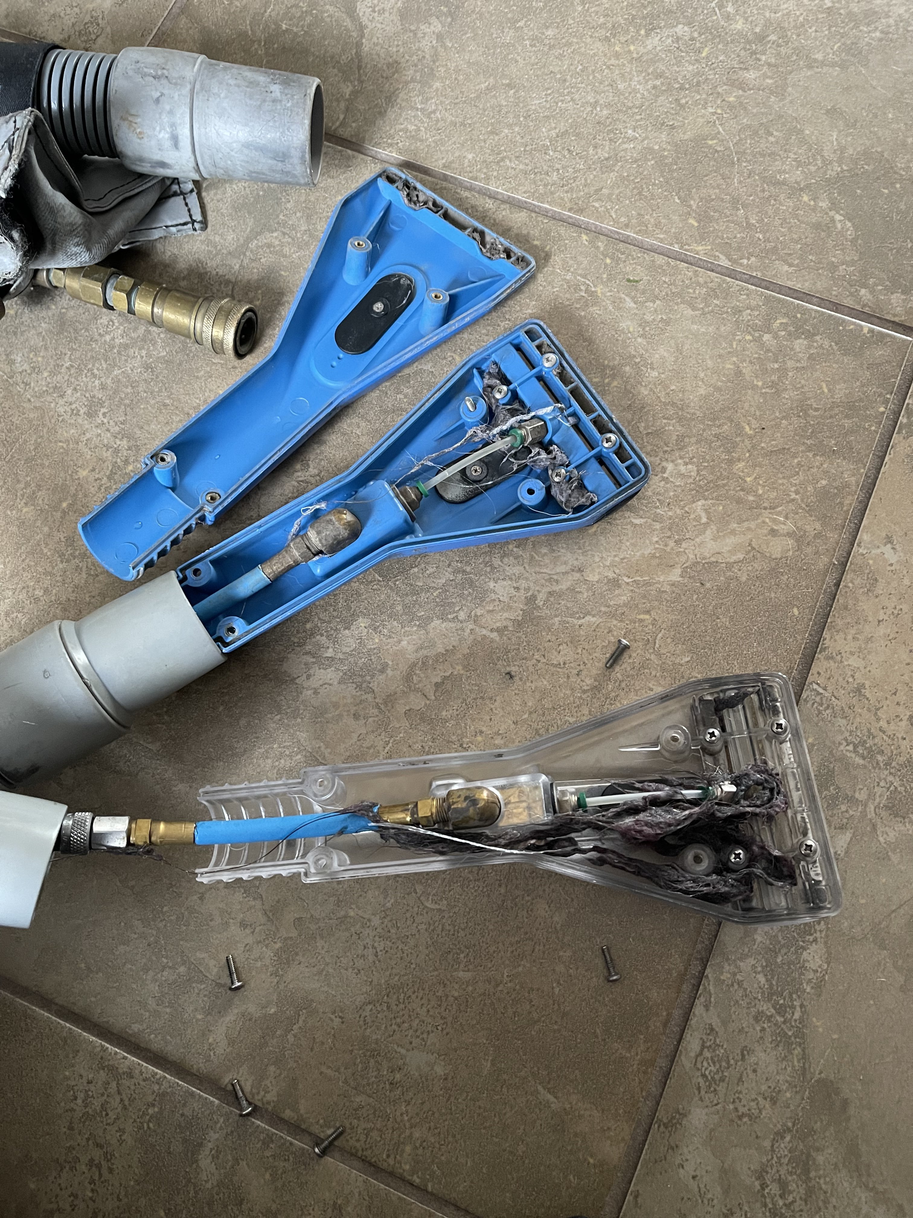

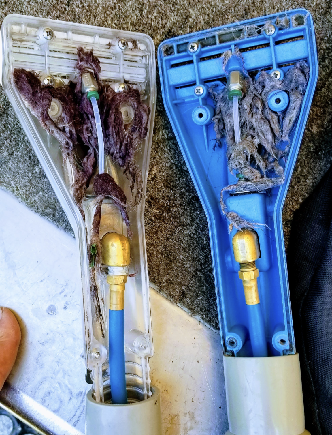

Caesar
You know the design flaws on that pair.Its so obvious.
Never inner screws they collect as shown.
No matter the tool.they collect .
Simple groove system.
Us products knew...
Look at hose leading to mini hose.
It's sitting in a non aerodynamic housing made to catch an snag.
That should stream line to jet one hose.
Look at open area around fitting another area that will collect...
One top grooved head.
One stream lined line.
An some one smug from making needing to take out some cash an fix that shit.
Before some one invents one an shuts it down...
An module the heads.
Us products knew four in one is better then one...
You don't need alot of heavy tools .
You need one that's easy to maintain.
An transforms fer u...

Design flaws need an upgrade there...
Those aren't flaws, they're features.
See, the screw attachment points in the airflow catch debris that would otherwise hang up in the much more restricted area around the 90, so you actually have to clean it out less often!
I own 4 Sapphire Upholstery Pros and they are the best tool we’ve ever used
Doesn't mean he's wrong, but taking out four screws isn't a deal killer either.
The US Products tool was a great idea...unfortunately the design of the primary head and the other heads that came in the case were nothing impressive to clean with.
Pretty gimmicky and costly for no apparent reason.
The Sapphire Upholstery tool is designed much better. It's also lighter in weight and makes cleaning much easier with the shearing action.
I cleaned for many years with the old Hydramaster tool and it did an excellent job. However the Sapphire upholstery tool is still superior to it.

Caesar
Yes agree fully on the us product on cheap thin plastic.
I was just saying a grooved top head.Would be able to access for maintenance over screws .Possibly modular type heads,as in a drapery wide tool.Or nozzle for baseboard filtration soil removal.
Not trying to sniff any ones ass.
It was simply I trust your point blank honesty,an your a carpet cleaner.
But you did say have I ever made etc.Yes many times an although archaic an primitive.
They worked well.
This idea was given to Windy Addams,in the 80s.
I hated the concept of one sprayer for ceilings,whilst helpers stood an weighted.
I utilized a us products portable added ceil cleaner,then heated an stopped at 90 degrees.Fuse was removed from switch so no accidental explosion's.
The heated solution went to the fan jet.Being heated it worked super fast.
At the end where jet is you will see of course vac tube.
What is missing is a modified ceiltech pva sponge extension.
I would spray,recover with vac as I squeegeed track clean.
No need for helpers,faster more efficient ceiling cleaning.
It worked very well ,then an now.
