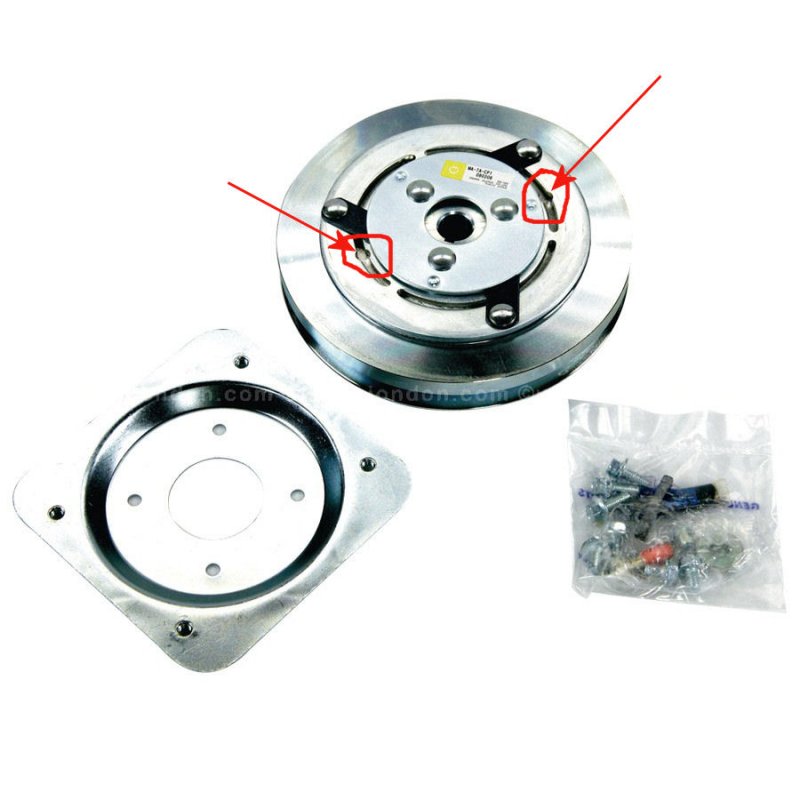

While the machine is shut off screw a short 1/4-20 bolt into the hole on the front of the clutch to lock it ON.
Now start the machine without turning on the pump switch. If it runs smoothly, and the pump is turning, you have a wiring problem.

No - he means on. Could be an electrical problem, or mechanical (pump is frozen and won't turn). If Don locks the clutch with a bolt it will turn even if the pump switch is off. Lee is trying to get the pump to turn without using the electrical (switch). If it turns thus we know the pump isn't frozen up, and that leaves electrical as the only thing left. Good plan.

If you look at the swing arms across the face of the clutch you will see a little hole and the arm is notched around it a bit. The hole is threaded. Put the little bolt into it and it will lock the pulley to the pump so that it doesn't free wheel.
No one thinks their clutch has one. They all do.

Dan Gardner's image and notation for another issue, so ignore the red arrow. You need to thread the bolt into a hole on the front clutch plate into the threaded hole on the front pulley.
