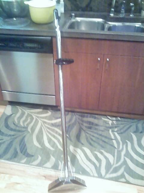

I got one of Tony's wands in the mail today.
I'll never use it so I'll bring it to MF5 to give away to some BDCC.
Now I can only hope that Tony offers better designs then the one he sent me. While this one is made well enough, it is a horrible out dated design (AW29) that only a extreme rookie would use because he (or she, and she could be a person of color so don't try and pigeon hole me here) doesn't know any better.
So why bother to knock it off?
Tony spend your time creating a new design with the help of the group here. If you can't pull that off at least copy good wands like the CMP14"/Greenhorn, the PC Ti or Quad or even the Westpak 14".
I just dont see much of a future in selling crap for very little profit.
Even it it is well made crap at that.

Mikey, that just happens to be the wand sold with just about EVERY TM and POTTY in New Zealand.
Doesn't matter if they bought a Ninja potty or a HM427, they all seem to go out the door with 1.5 whimp hoses and the (un)trusty AW29.
My dad just picked up a 2000 CDS 4.7 in a Hiace, the ONLY CDS sold into NZ and it came with two AW29's that are extremely well worn for hours of use.
I can't get it, guys spend big dollors to buy these good sized TM's and accept what the salesperson tells them and run the whimp hoses and an AW29.
Oh well, I'll stay with my Greenhorn thanks.

I like the AW29. There, I said it.
I never use it, but I do like it. It's so damn light, I fly with it.
18,851
Lee Stockwell
Not all AW29 clones are equal. A few are pretty good, many more are not. Beware of some Ebay sellers.

Allow me to ask a few Qs:
Does it have the cheap $19 kingston valve that pops at 500psi and is responsible for 3/4 of the carpel tunnel syndrome in the biz?
Is the Forward assist handle weak and flimsy when you lean on it, are the bolts bottomed out from trying desperately to tighten it?
Is the vinyl sleeve slipping back and forth from the heat when you extract with high flow?
Are all the threaded fittings American standard, or are the threads "a bit off", and difficult to screw replacement pieces and jet assemblies into?
Do the Jets have a half mile of teflon tape on them because of the above?
While we are on jets, does the jet body actually screw all the way into the socket or does it bottom out against the stainless solution line that is welded to (and through the socket) so it protrudes and the jet body hits it before it's fully seated in the threads?
Is the Male QuickConnect interchangeable with industry standard Hansens, Fosters, and Parker? Or is it "off" just a little bit to hang up and be a PITA?
Does it come with an inline filter at the valve?
Are they uniform enough at the wand lips that the same glide will fit 10 wands, or are there discreptancies that allow air leaks?
Did Mikey actually clean with this tool?

I just got the same one today I'll let you know. So far its better than my Hydra Hoe.

what's Lester using now?
the AW29 isn't a bad wand.
No it's not a hi-tech top of the line wand, and needs to be limited to pressures at or below 350psi, but it cleans well with 06 jetting.
and if your TM is maximized for suck and air flow, it will give very respectable dry times.
It's also a light nimble short wand

I had a couple good AW 29s that came with my Century 400 TM. Bought a knock off AW29 from Namco for $129. Came with an 02 on one side and an 03 on the other. Fixed that and used less than a month before the weld that held the jet broke loose.
A wand is where you get the most bang for buck performance wise. A fraction of the price of a bigger TM.
If I need a tool for that would be nice for occasional use I might buy from Harbor Freight,but if it is something I use alot I'll buy quality

The jet "cans/holders" what ever you call them, on this wand will fall off within the first year. Two tiny tack welds.
If I came with a Glide I would give it a shot.

as far as the AW29 and 29 knock offs, I've seen good and bad ones.. they're not all created equal
As far as cleaning ability, they not a bad wand at all when compared to similar priced 1.5" tubed wands and actually clean pretty well
