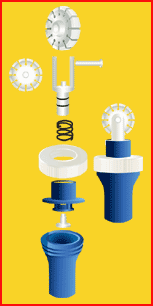

Please call the Grout Wand Company and ask them why they insist on using non Viton O rings on a tool designed to apply solvent based products.
I can't tell you what a treat it is to get half way through a 2000 ft tile sealing job and have your brand new applicator fail. There are two O rings on the plunger that swell up and cause the wand to let the sealer drip out non stop.
I have gone through way too many of these wands due to this exact problem. This could be eliminated with .20 worth of Viton rubber.

I'm just a hair taller than Todd and I can hardly use it, I hated that tool, by the end of the job I'd have a blister in my palm from holding it way out on the end trying to keep a little angle out front and I walked.
There really is no excuse, it's just plain lame.
There is hope though....
The cap assembly has a simple acme thread pattern, and the stick relies on a flat rubber washer, so it's "possible" to make a custom loooong hollow handle and machine to match those threads. Then you could just buy the POS o-ring leaking plastic replacement heads and be at least one step ahead, and a LOT more comfortable.

Mikey;
I've already done it !
I complained to Hydro-Force after we discovered the problem a couple of months ago.
I asked them to install Viton o'rings for better durability.
Most of our customers are using the wheel applicators.

Larry, how hard can it be to match the orings?
