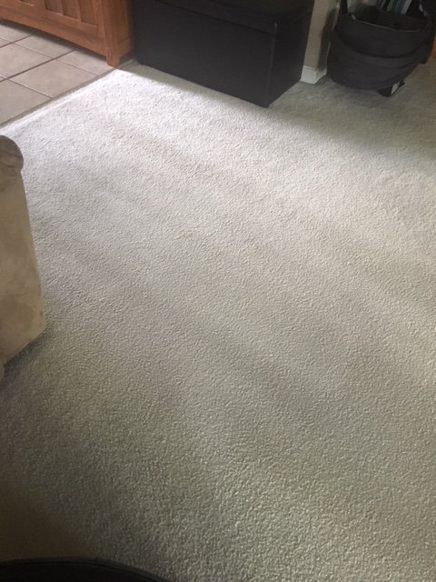

Carpet was filthy. Came out pretty good a week ago. Customer emailed me these photos today. Said she’s vacuumed from all directions and the stripes are still there.
I’d appreciate some advice. I have heard clogged jets can do this. Thoughts? D91E9D5F-8803-42EB-A30F-87A6BDA8F132.jpegBB919038-FEFB-498A-A458-A2852404E097.jpeg

Check the spray pattern on your wand make sure that there is a nice even fan all the way across. If there are two fans hitting each other they can create a turbulence that distorts the yarn. @Mikey P made a video about spray tip angles.

Ask her if she ever cleaned the carpet in the past. I just did an apartment last week that had those lines in it and I found out they used their magic chemical under the sink, causing color loss. I couldn't get those lines to go away

Is that the direction you were wanding? Doesnt really look like wand marks to me, but I could be wrong. Strange.
14,649
The lines from left to right are what I’m referring to on the color loss

I believe I wanded in the same direction but my strokes are not that long.

How about floor boards beneath interfering with your results. Doesn't seem like your wand technique could be that consistent (unlike boards.)
BTW, looks pretty good considering.

It’s concrete slab underneath the carpet. The carpet was a little loose, needs to be stretched, could that have anything to do with it?

Not on that one, she was using her shark when I arrived.
Doesn’t matter. It was probably clogged to some extent.
Did you use anything to agitate the prespray?
CRB, rake, rotary, OP?

Streaky wand/over pressure for the carpet
jet distortion

I had it set around 500 psi, which probably gave me around 400 at the wand.
I did not agitate with anything other than some serious scrubbing with the wand.
Streaky wand/over pressure for THAT particular carpet
....jet distortion

What chems?

Where the picture of your wand, specifically the jet area Wanna see whats up?

If its longer and more consistent than your wand strokes its a preexisting condition your cleaning has highlighted
looks like Matt rented her a rug dr
I'd rotovac or 175 scrub then wand
look at the first pic by tile
to the right where the right side of wand would of been against that black box/thingie
looks to me like the left or left inner jet is fouled

Ask her if she ever used a rug doctor from the supermarket and........used laundry detergent............that contains optical brightners.
A test using a black light would confirm it.
SHE caused it

interestingly enough, you were the one dumazz on this thread closest to right .
trashed carpet when started and clean(er) streaks when done
