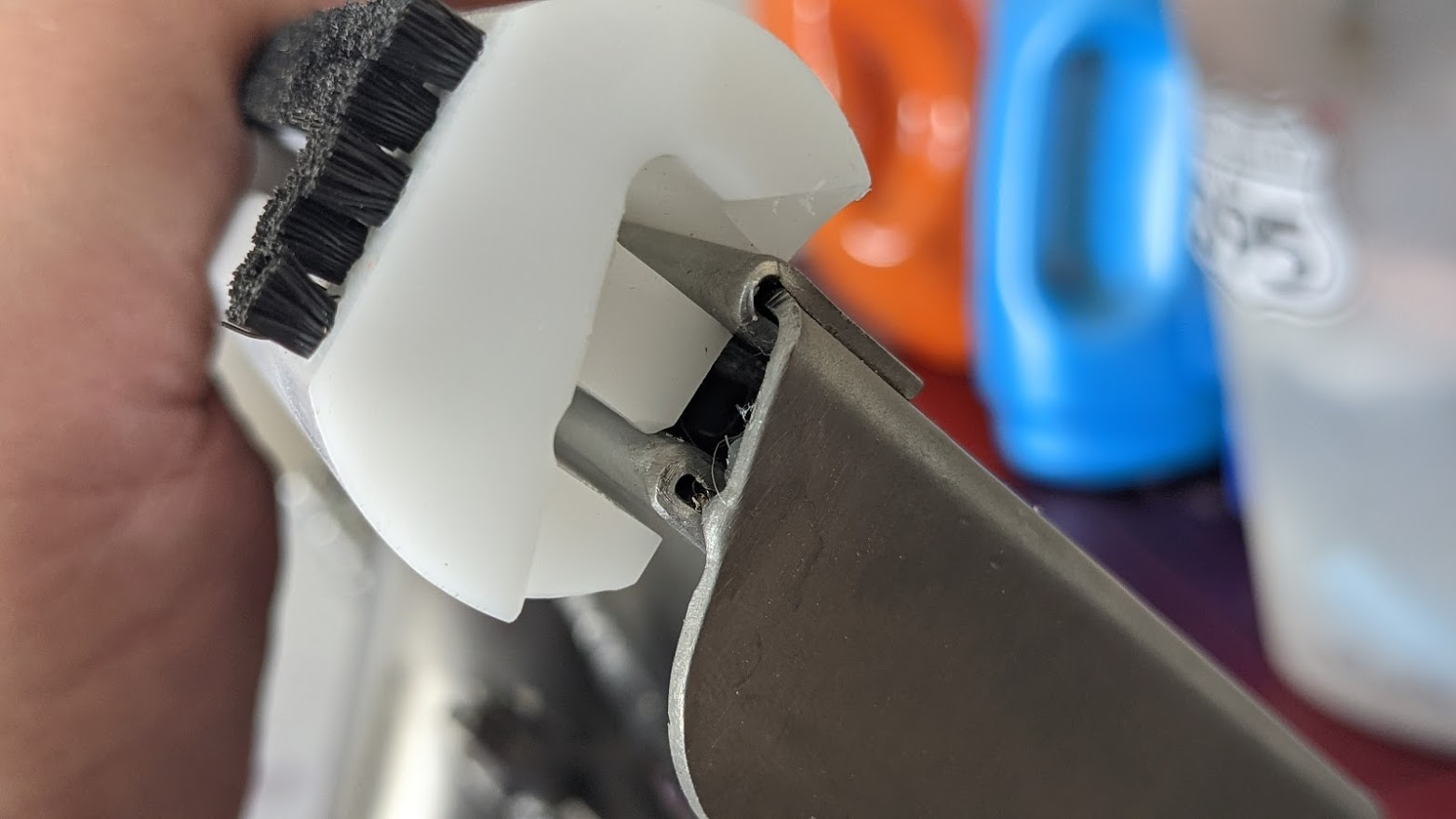

Here is an internal fit brush glide on a SSTi, Teflon conforms and goes in easy, Delrin, not so much, back to the drawing/cutting table....

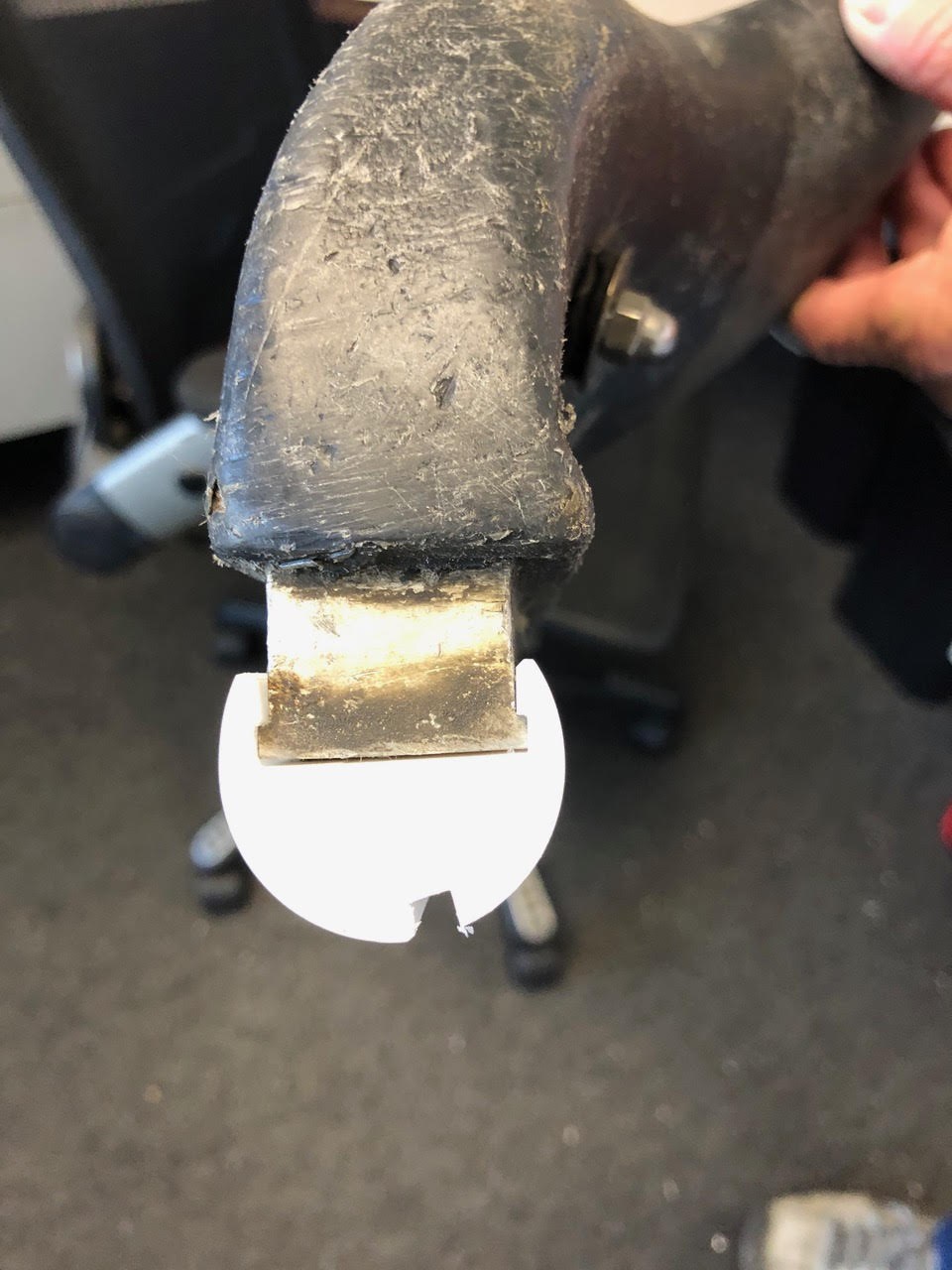

"slip fit" example, set screw holds it in place.
